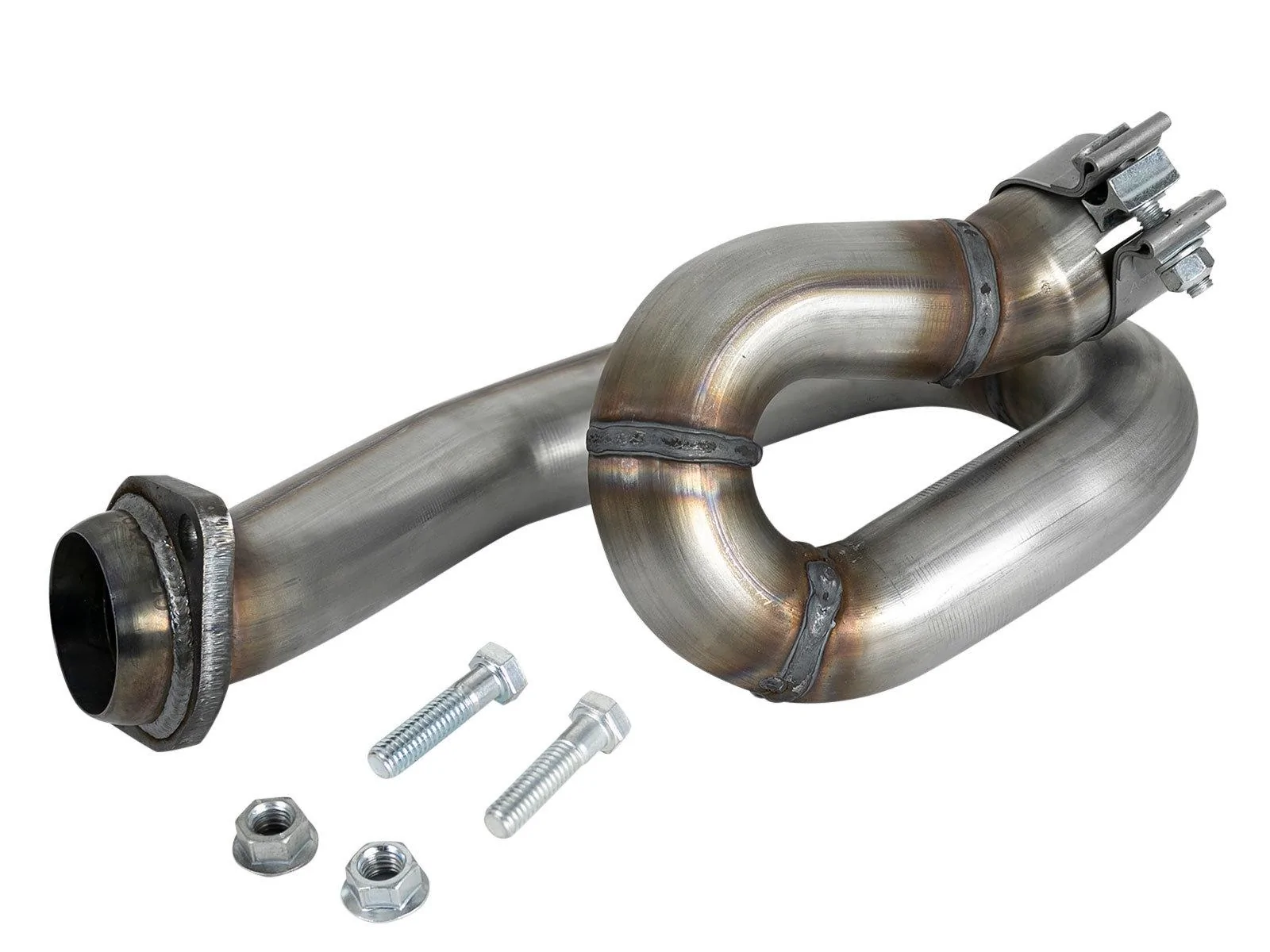

I have full M.O.R.E. belly pan and the Skid Row exhaust loop skid.

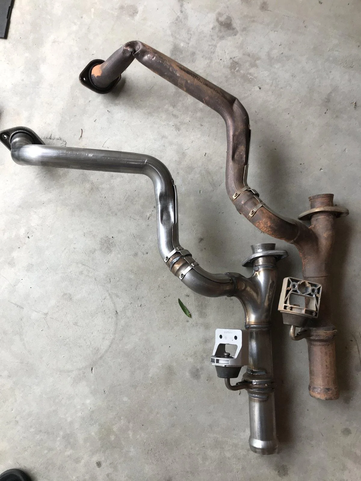

BTW, there is a loop delete pipe available, https://www.quadratec.com/p/magnaflow/loop-delete-kit-jeep-wrangler-jl-2-door-36l
Thanks for the mention, Sourdough!
For anyone that was not aware, our loop delete pipe is now available through our website and all authorized Magnaflow dealers for $110. This pipe gives you added clearance for offroading to avoid the type of damage in this thread and also allows you to run extended links without hitting the exhaust. You can find more info about this pipe on our website below. Please let us know if you have any questions that we can answer!
https://www.magnaflow.com/products/...magnaflow-jeep-performance-pipe?aces=10215761

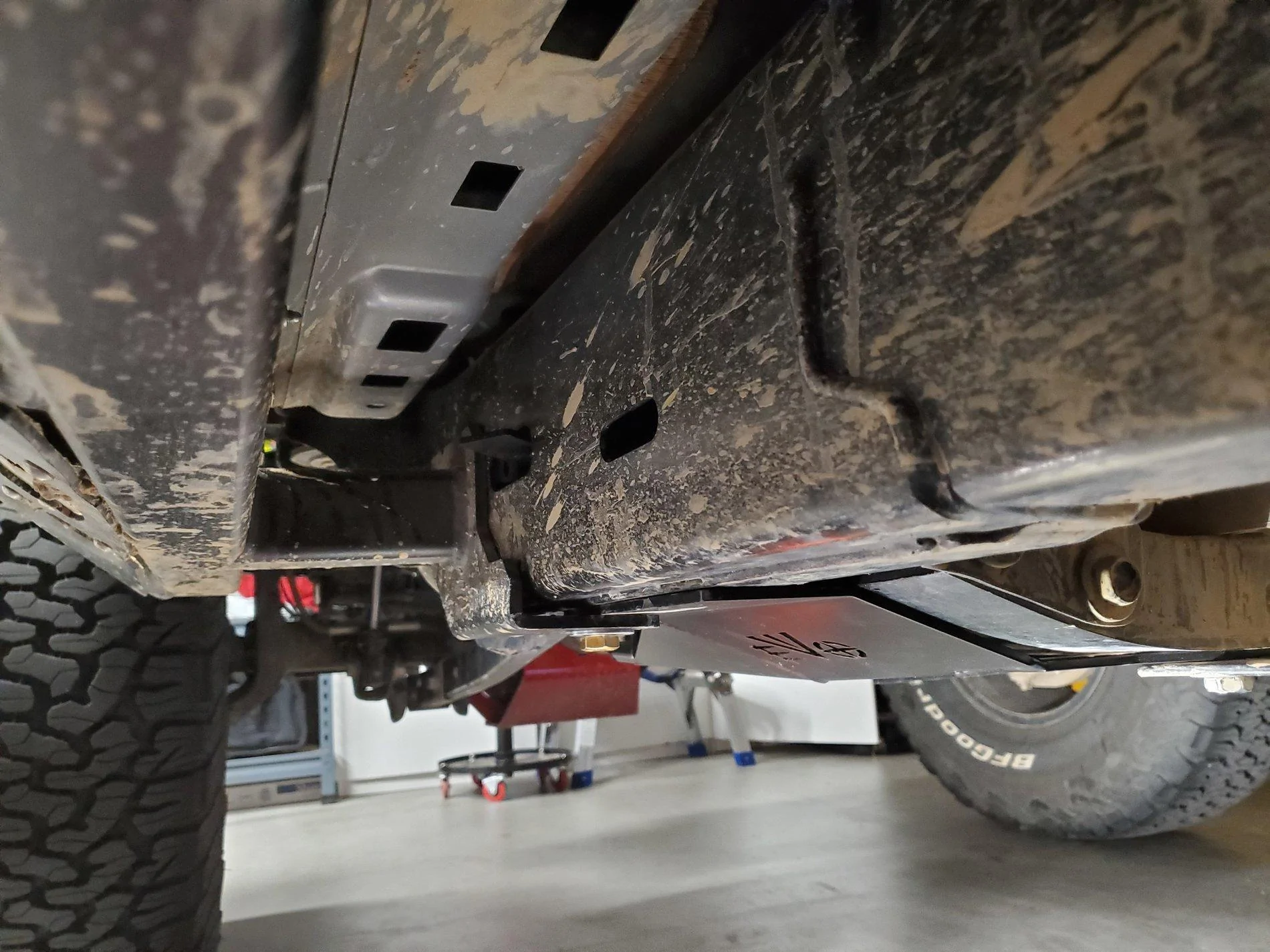

Will the EVO skid (or the skid row) work with LOD Signature sliders? Or could it be modified easily to make it work? I have the EVO engine skid, but didn’t order the exhaust one yet.
Hey Tom, might you have any pictures of this? I have the LOD Destroyer sliders and I’m pondering the Evo Skids.
Thanks!

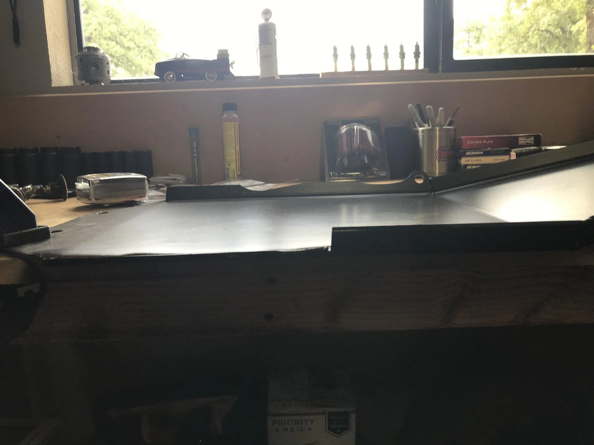

I just installed the Evo Exhaust Loop Skid with the LOD Signature sliders. I'd planned to notch out the skid and then drill a new hole through the skid/frame and use a self-tapping bolt. Instead I just coaxed the skid between the frame and LOD slider frame mount. As someone else mentioned, have a nice beefy pry bar on hand if you've installed the sliders before the skid.
Jeep Wrangler JL Advisory: Keep your exhaust loop pipe safe! 20200203_185201
I suppose you could also mount the skid over the slider frame mount but I felt better about the other way around.

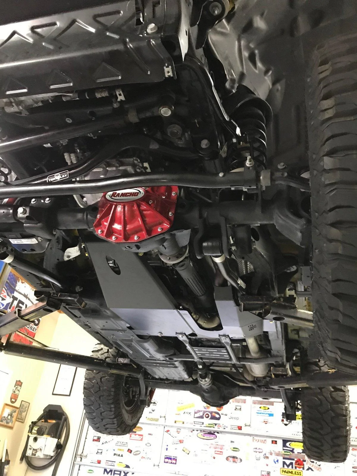

Any feedback on the loop relocation products? I can’t tell if the loop delete actually affects performance negatively based on the debate here
It is hard to believe FCA put the loop into the system for no good reason. I kept my loop and was lucky enough to have SkidRow's plate fit with the M.O.R.E. bellypan

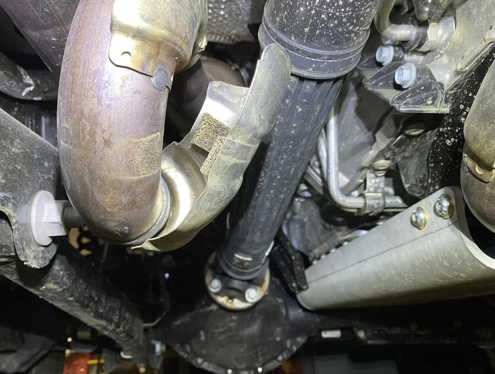

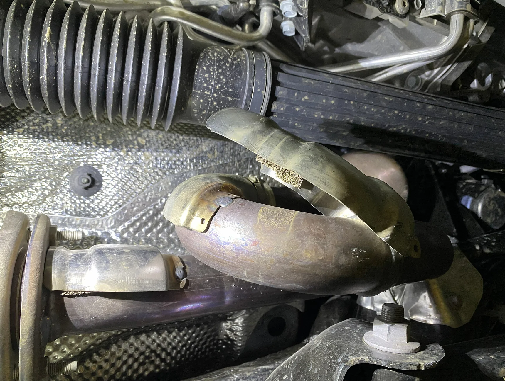

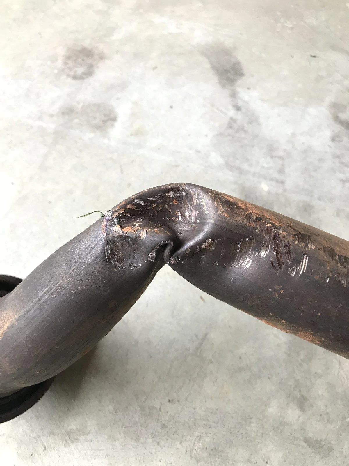

Interesting thread, I smacked my loop pipe at Rubicon last month. Not sure why Jeep made this a low hanging rock magnet, I do understand the equal length pipes theory though.
