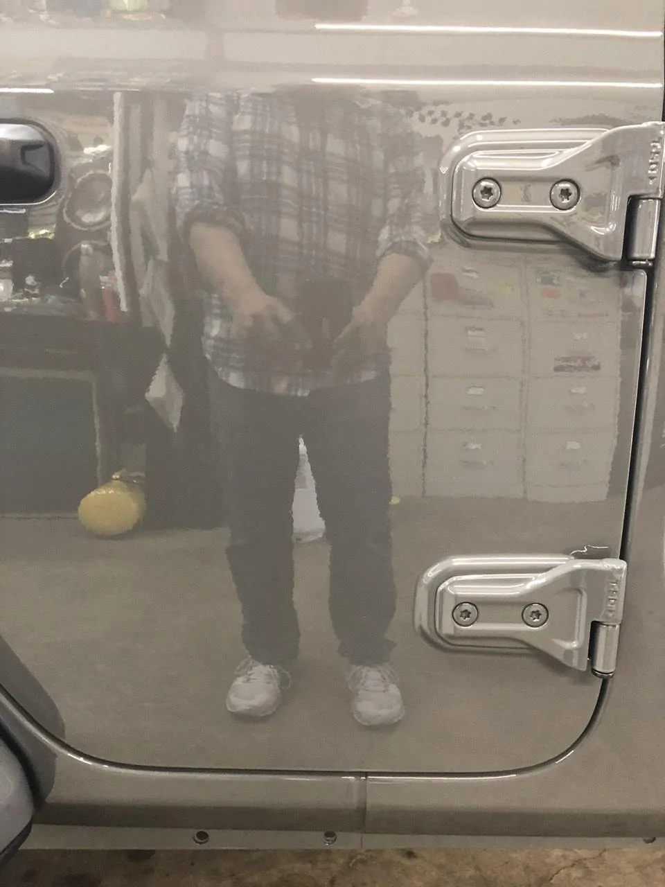

She sent the Jeep to "The Car Guys" in Millersville MD for new car paint correction and for coating the first weekend due to the dealership prep crew leaving some swirl marks on the doors. The did an amazing job and I could read the writing on paint cans on the desk through the reflection. We pulled the spare tire and the rock rails so that we could get the paint protection applied behind the OEM rock rails and the spare.

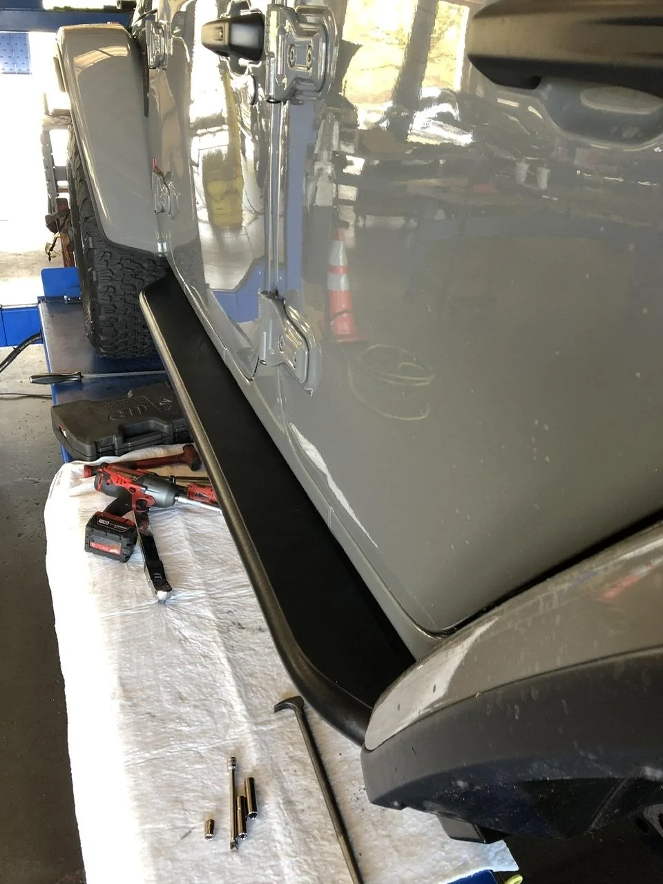

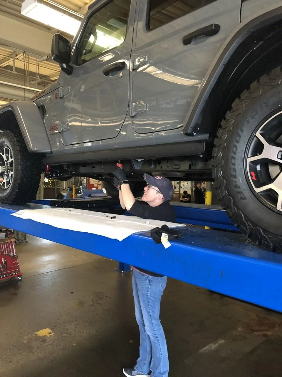

We went to the Automotive Skills Center on the military base to install her Rock Hard Patriot sliders that she custom ordered with the plate delete to use as a step and also for protection from car doors in parking lots.

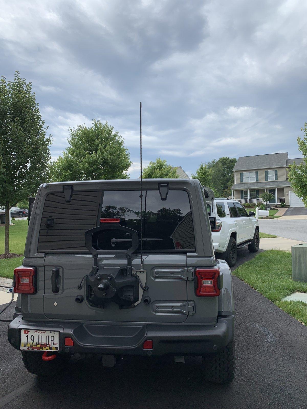

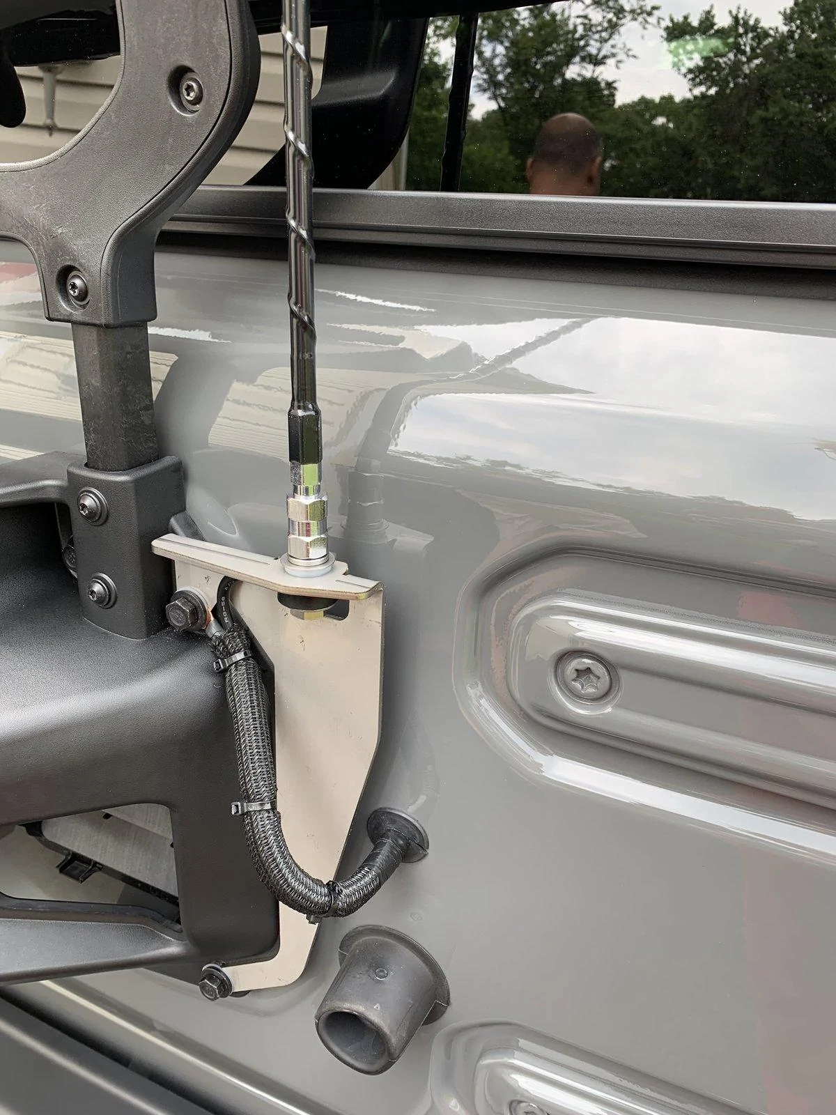

For communication we are eventually going to have both a CB and GMRS. We looked at a few antenna mounting solutions and decided on the Quadratec Tailgate Mount with the Firestick, Quick Connect Antenna Mount and a Uniden CMX 760. The Uniden is zip tied behind the glove box for the time being but I plan on finding a more permanent mounting solution in the future.

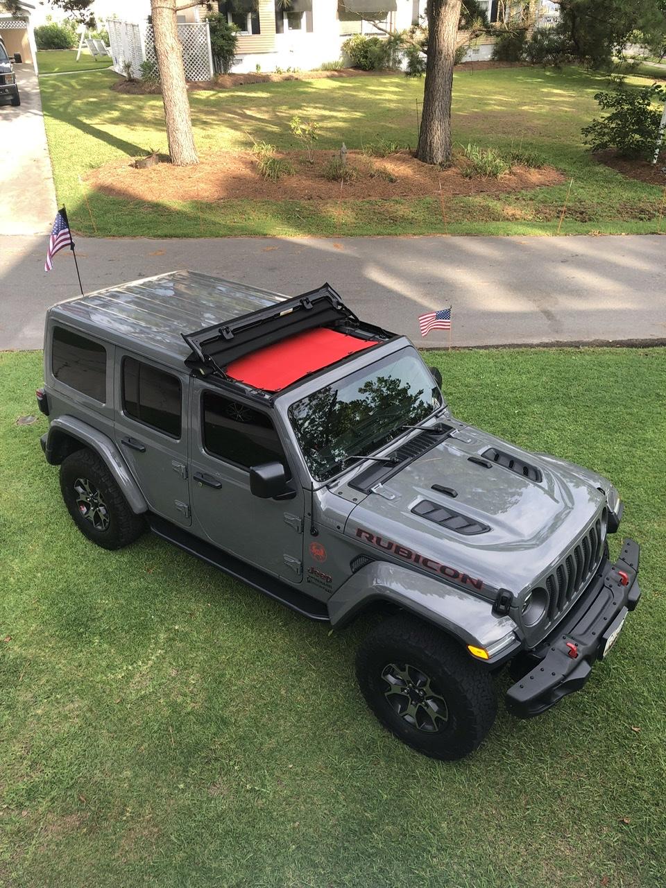

My wife ordered a Bestop Sunrider and an Alienshade for the front seats in red.
Jeep Wrangler JL Warthog JLUR Rig Journal 61EDBE8F-AA85-4DB2-8182-EEB517283935

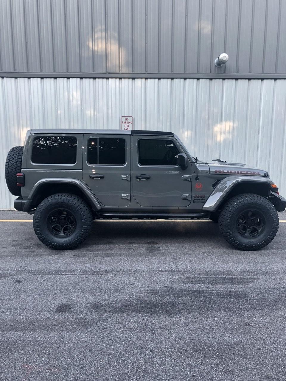

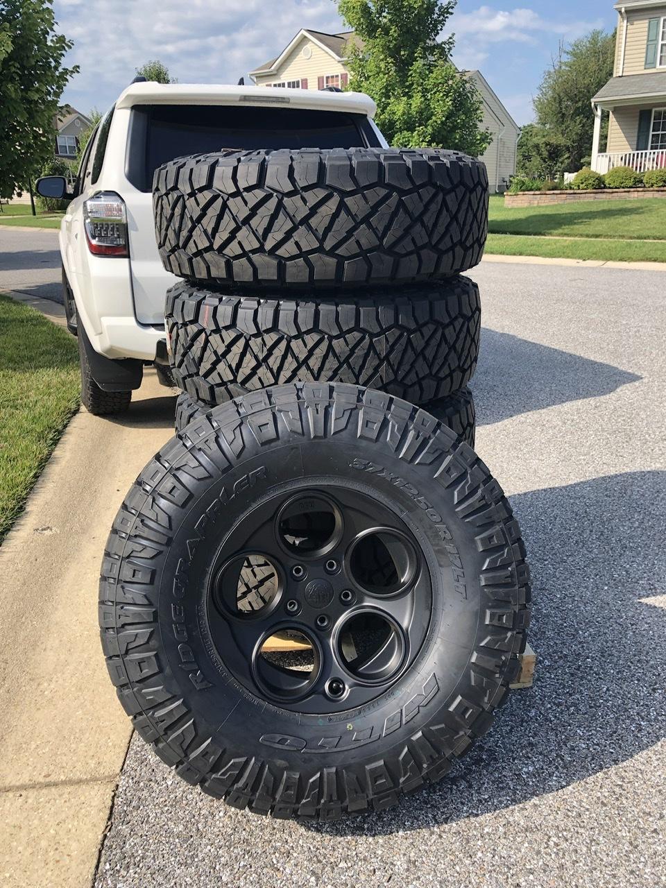

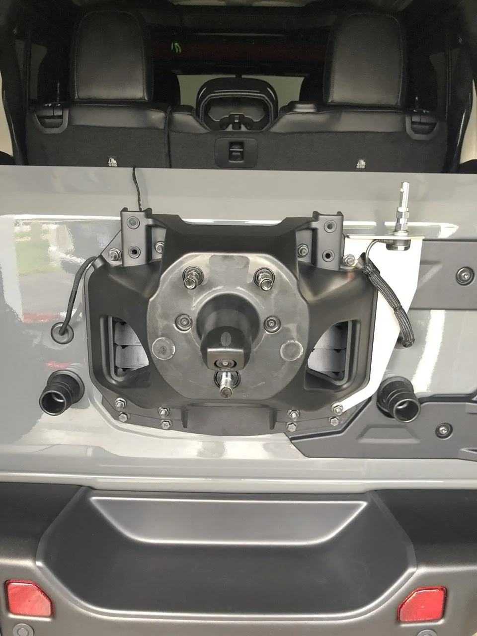

With a 6’8”parking garage at work we had some height limitations. After searching the forums for vehicle heights after lifts and seeing so many heights listed depending on vehicle weight we went with the AEV 2" Spacer lift, AEV Savegre wheels and 37x12.5 Nitto Ridge Grappler's. Due to the extra weight of the spare we decided to install the Mopar Tailgate Reinforcement at the same time. Total height after install is 76.5 giving her 1.5 inches of clearance at her work parking garage. After the lift install she had Formula One 15% tint applied on the back and side windows at AP Tinting in Maryland.

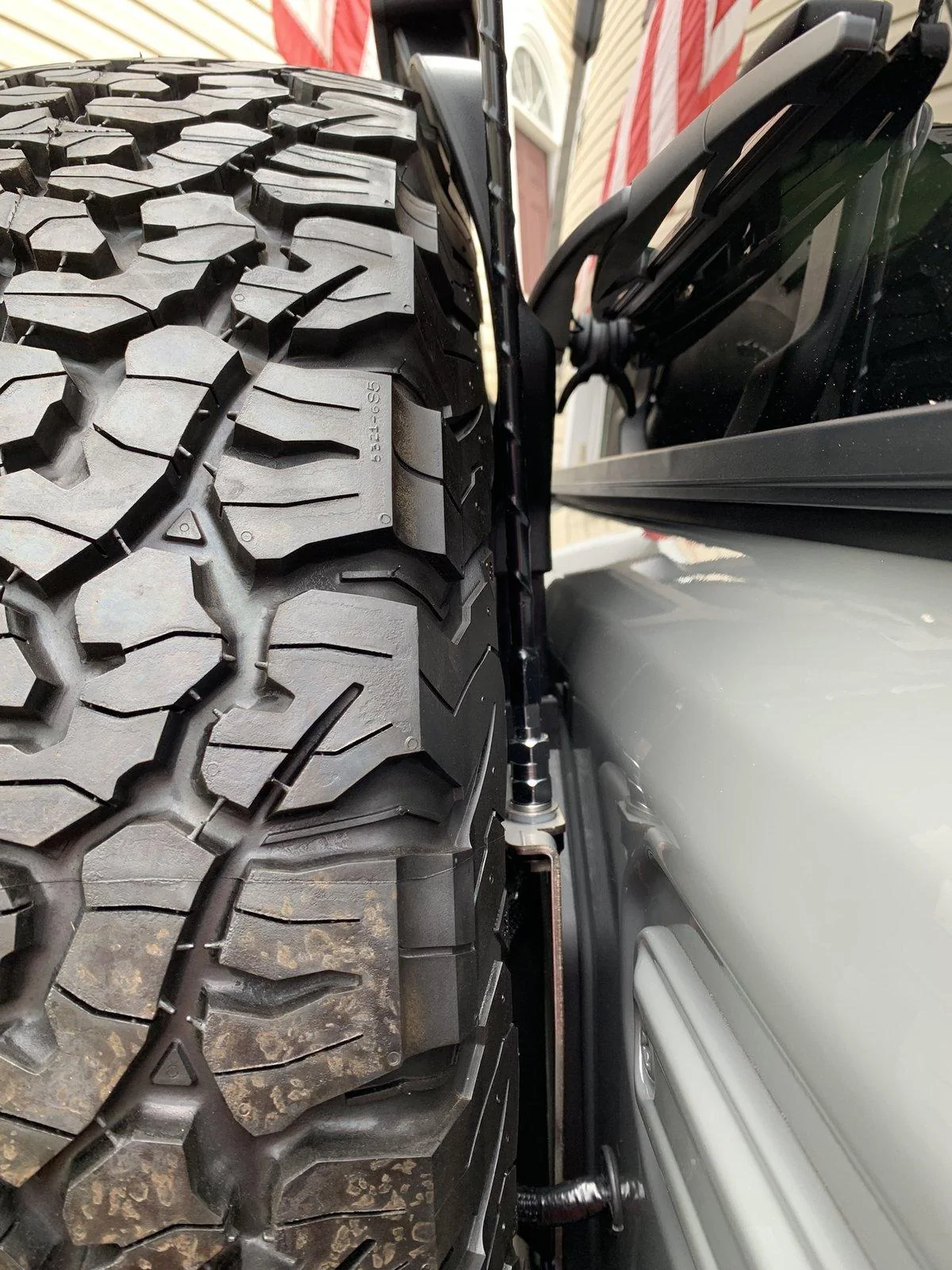

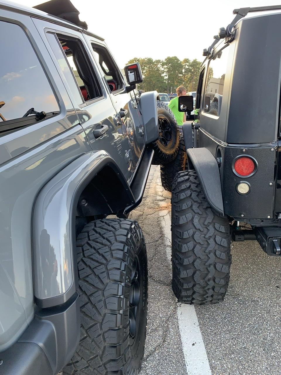

We were getting ice cream with the local Jeep club and talking about what kind of rubbing might happen with the 37's and the 2" AEV Spacer lift so one of the members let my wife try to crawl up his 42" tires so that I could check clearances. The back wheel barely contacted the black plastic piece behind the wheel.
