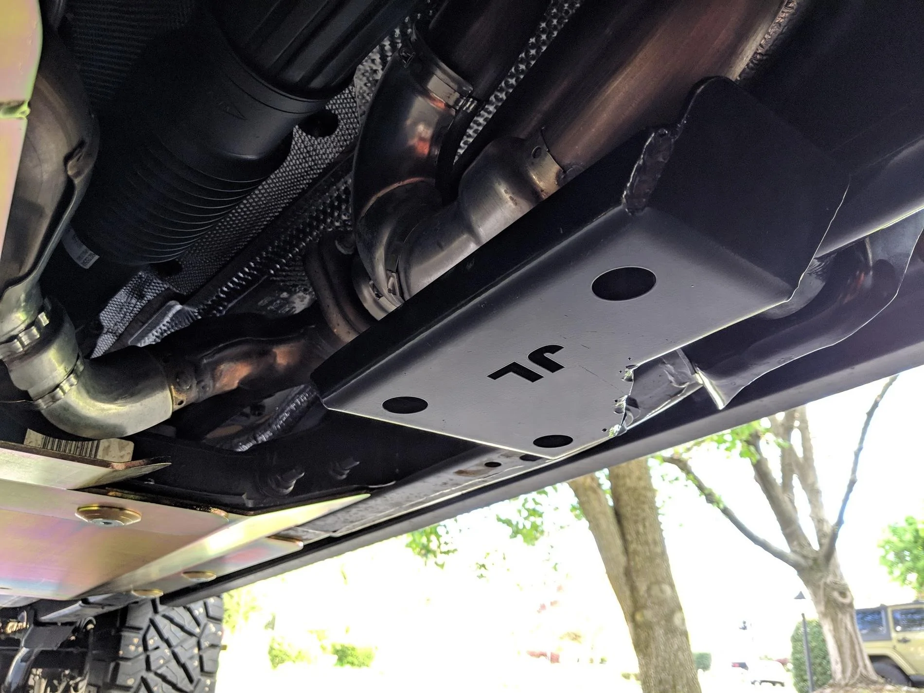

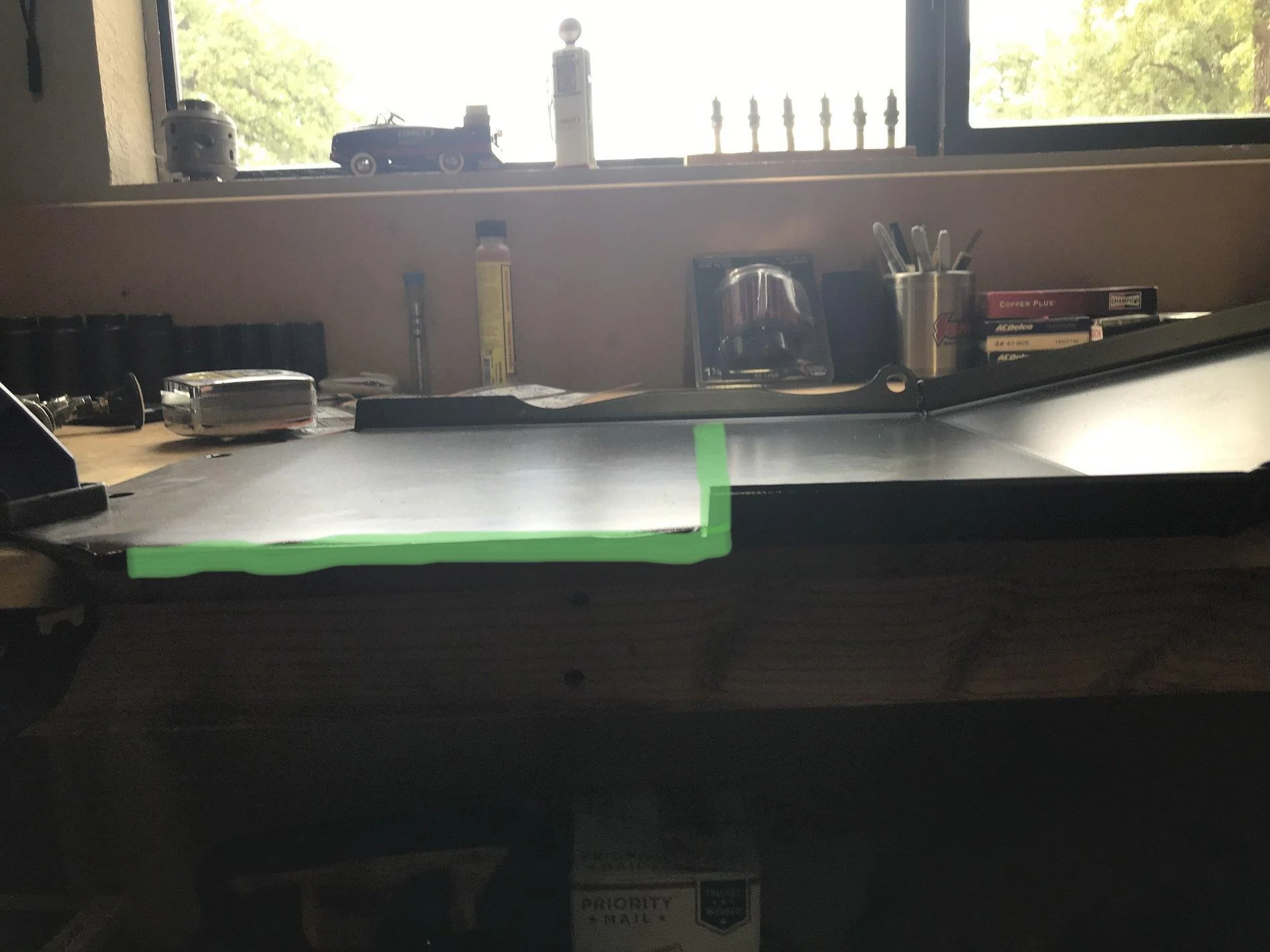

Got it now. Looks like what you cut off was flanged for strength. Hope that edge is overlapping something and supported. I was just reviewing EVO instructions and it only mentioned grinding and sanding, not cutting. Think I’ll contact them today.
You definitely need to cut. You'd be grinding for days. That section is not supported. And yes, that's my fingerprint on the freshly repainted painted area because... impatient

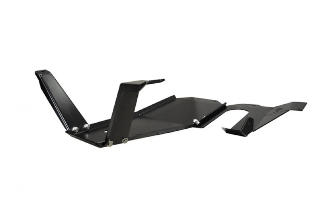

Saw this thread awhile back and I found out that skid row sells an exhaust loop skid - https://www.skidrowoffroad.com/prod...aust-guard-for-jeep-wrangler-jk-2018-present/
Pretty easy installation and reasonable price. I'm running the MC skids as well
Looks good and the fact that it works with the MC skids is a plus. Looking at it though, it only has 2 mounting pints and they're both on the same side seemingly cantilevering the skid plate. I'm be curious to see how It takes a direct hit and if it'd bend up to hit the pipe since it's not supported on one side. With that said, I'll probably still buy it as it seems to be the only option at this point.
I was gonna post exactly this. I think it has promise - and may be fantastic as-is - but it looks like a bit of a potential lever arm. Would want to handle in person to determine.

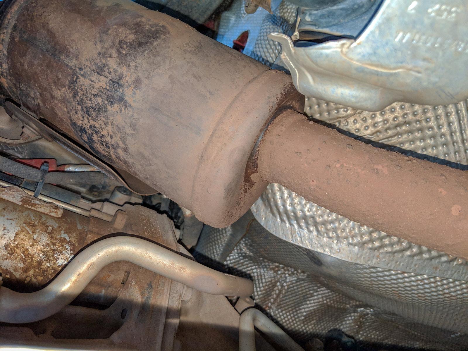

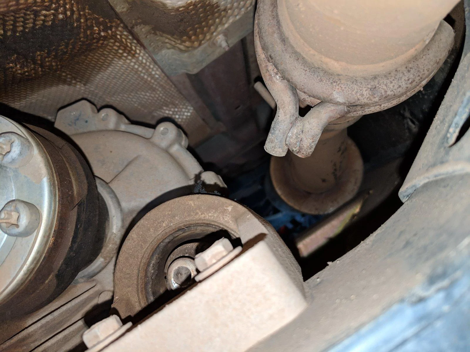

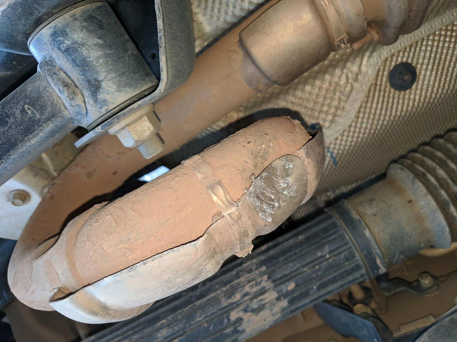

Learn by my mistake. :(
On the driver side, your JL cat pipe has a loop in it that is meant to make both sides of the exhaust equal in length before they merge together. This loop protrudes down a bit and is fairly easily hit while rock crawling.
I unfortunately slipped off a rock with my driver rear, and landed directly on another rock right under my loop pipe. It pushed everything forward.
Luckily the driver's side cat itself took the brunt of it, and collapsed in a little bit. The mid pipe hanger snapped. I do have an aFe rock basher shorty exhaust installed, and it fared just fine.
I started having an exhaust leak right afterward. After doing some gandering and listening, It was coming from the manifold at the passenger side. I bought a new gasket ($15) and swapped the gasket. Boom, no more exhaust leak.
Things are still tweaked a bit, but she functions like new. Sort of. :whew:
I do have full belly skids from MetalCloak - but they do not cover this loop pipe.
Here are some pictures showing the exhaust damage, the passenger manifold gasket, my skid plates, and a random picture of my JL on some rocks. (the damage did not happen in the bottom two pictures)

Looking at the installation instructions, one bolt is on frame and 2nd is on LCA bolt. It's 3/16" and boxed, should be strout. I have one ordered. I'll update post once I have it mounted and put a floor jack under it. Only way to really know.
cant wait to see your impression. i have one sitting in 4WP shopping cart till then
