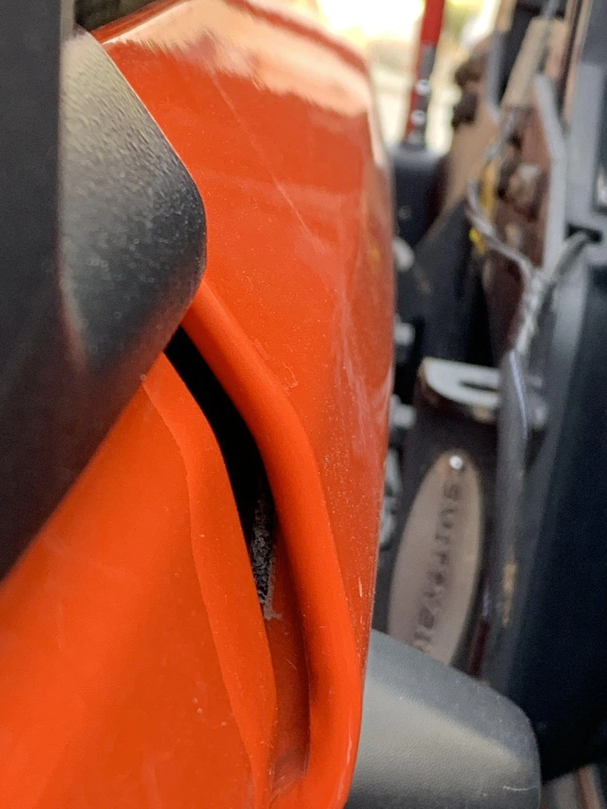

I’m right ther with you, Irishtim. My tailgate is sagging as much as yours and twisted out about 1/4 on the top left. It’s BS and very frustrating.
Ouch! That sucks. What carrier are you running and is that pic of your tailgate closed?
