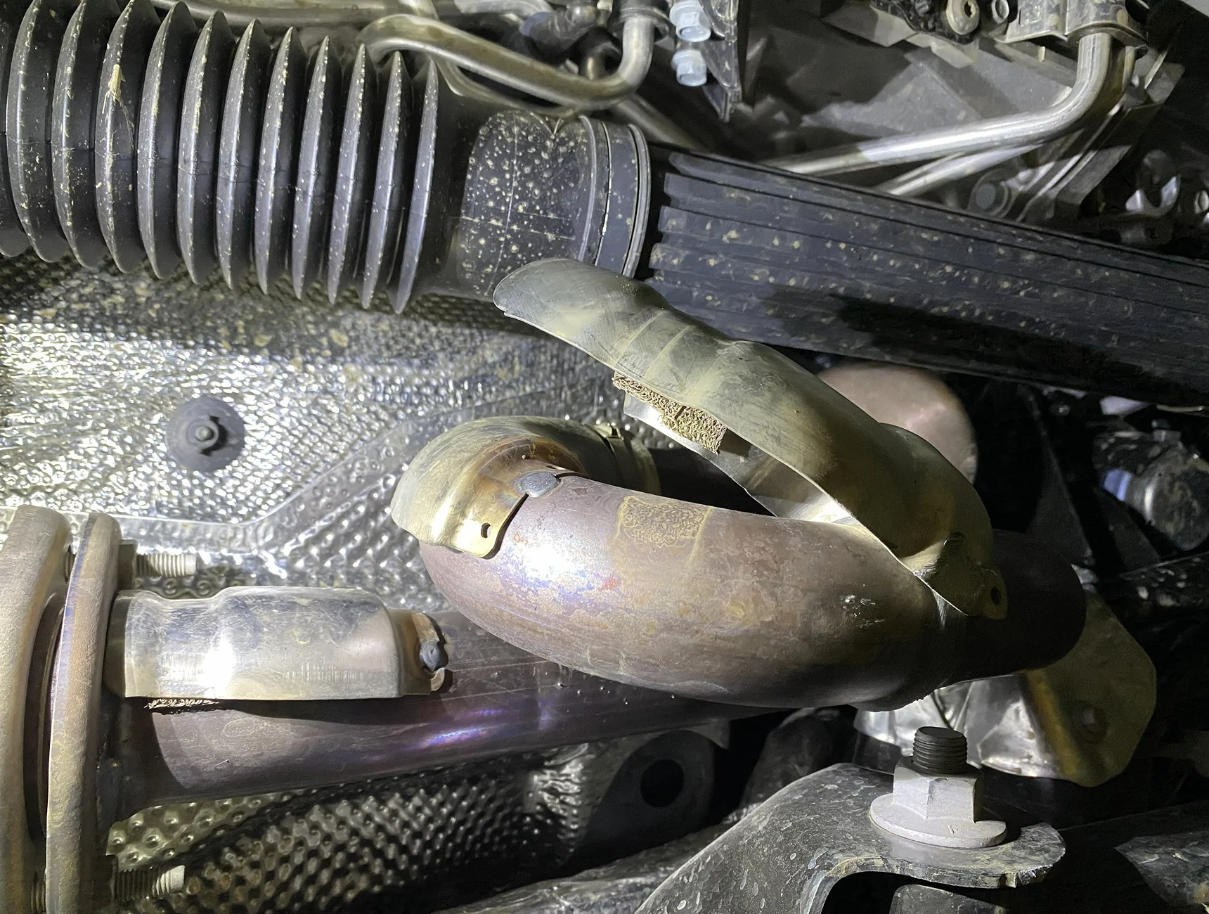

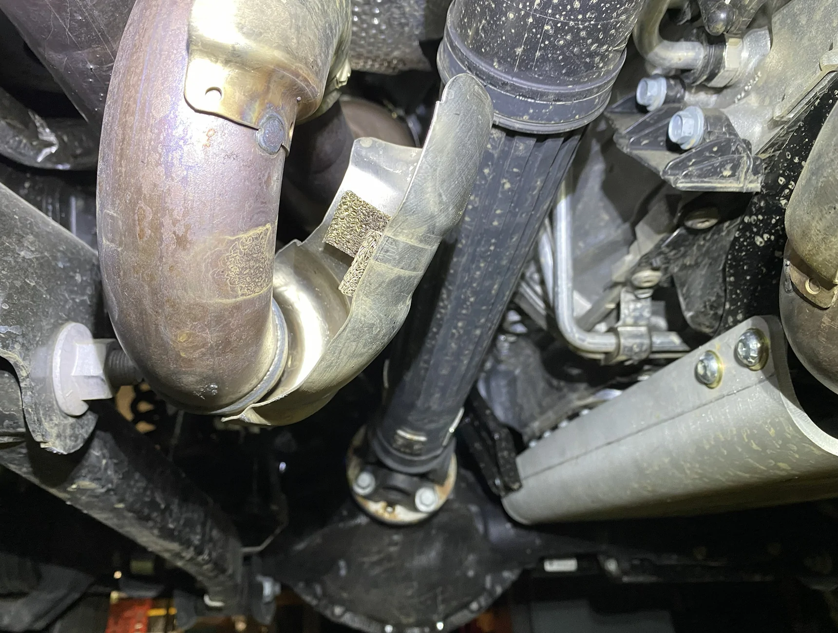

Bit wrassler
I installed the Magnaflow loop delete a couple of years ago. Improved clearance off road with some trade offs I suppose
One Rubicon trip smacked this but not super hard, looking at the loop delete or the loop relocation, how's this mod treating you so far?
Edit: my loop after one day at Rubicon.
Good. Super easy install. I can’t feel a power difference either way in my 3.6 JLU Minivan. But I’m not racing around, drifting, or playing cat and mouse with high performance sports cars like some of the more advanced drivers on this forum.

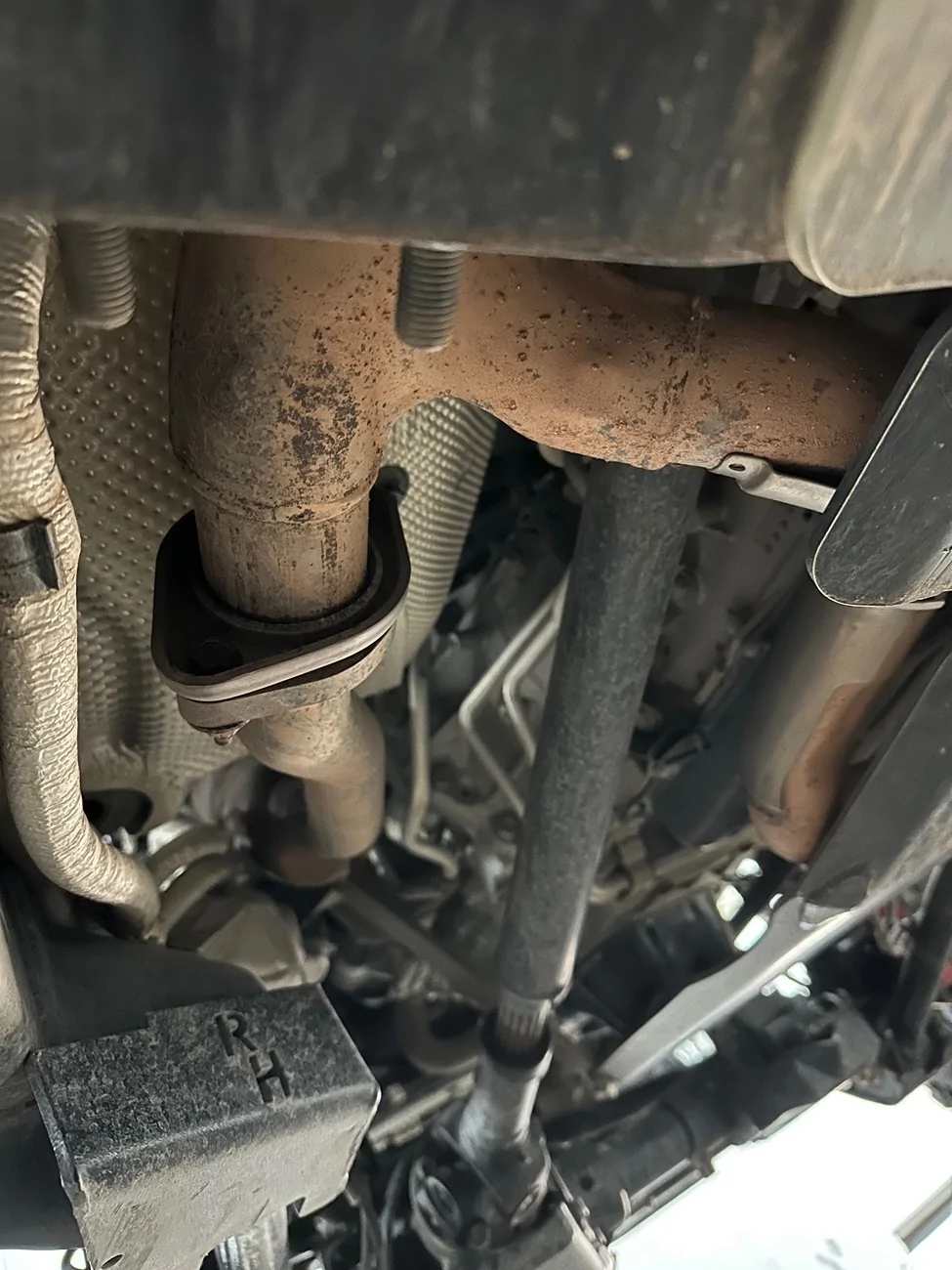

Thanks, ordered! Just watched where plenty of peeps have ruined the catalytic converter and other exhaust piping by smashing this!
Here is from the middle drivers side looking toward the front. With the Metalcloak skids and the exhaust loop delete the odds of damage are greatly reduced.

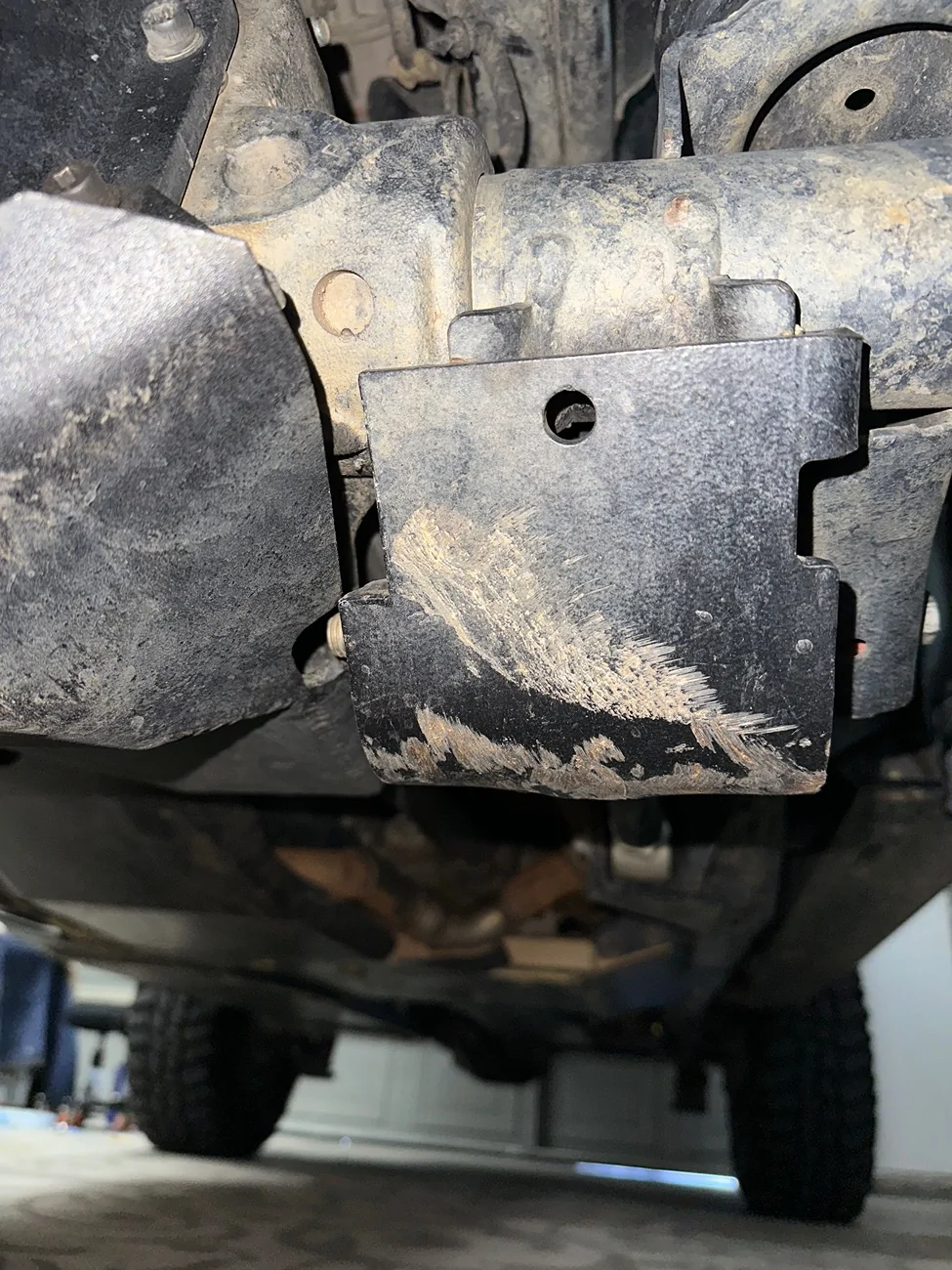

@Terrymo Thanks for the great picture! Is that a frame mounted front LCA skidplate? I want to do something for the fronts at least as they got pretty beat up too. Did you install and cut the old pipe while still mounted in your Jeep?
BTW, friend had an early Buick Grand National with the turbo v6 and the early 80s Buick odd-fire v6s were more desirable than the later even fire because they made more power. I'm not doing this mod for power, just don't want to smash expensive stuff if it's avoidable...sometimes less is more. Trying to keep my Jeep lighter weight too, so cutting things off helps too lol.
I’ve got skids on my skids because of poor decision making skills. I had to notch the front LCA skid and NV diff skid on the drivers side to make them coexist.
