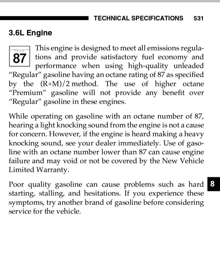

I'll just put this here.
Stupid question of me to ask, but I’ll go ahead and ask it anyway.
I was born and raised in San Diego, California and always lived at the very most, only a few hundred feet above sea level, if not exactly at sea level. The unleaded gasoline out there was always rated at 87 Octane, 89 Octane and 93 Octane for Super Unleaded.
In August of 2003, my Dad, wife, kids and I all moved to a very small, rural, Northeast town that was predominantly an agricultural and cattle area. The altitude out here is right around 3,875 feet above sea level to 3,950 feet above sea level. But no matter where you go in Colorado, the fuel is either 85 Octane, 87 Octane or 91 Octane. But the moment you cross into Utah, Nebraska, Wyoming, New Mexico or Arizona, all of those States use the same octane as Commiefornia does even though in parts of them, they are at the same altitude as Colorado is.
I know with Colorado, I have been told that the entire State runs lower octane fuel because of the higher altitude and thinner air and so for everyone out here, we are told to treat the 85 Octane how other States treat 87 Octane in there’s. So for my Rubicon, I have still been running 87 Octane in it but was wondering if I should run the 85 Octane in it instead, since we live in a higher altitude.

I live at 7000 ft in NM. I routinely drive between 5500 ft and 10000ft. I run 86 octane, the lowest grade we have, year round in a 3.6 JLU and 2.0 JLUR. My daily commute is from 7000 ft to 5500 ft in the morning and from 5500 ft to 7000ft going home. I don't have any issues with it. Right now I'm visiting CO with the 2.0 and have been driving it west of Denver between 6000 and 10000 ft. I've been using 85 octane and haven't had any issues.
