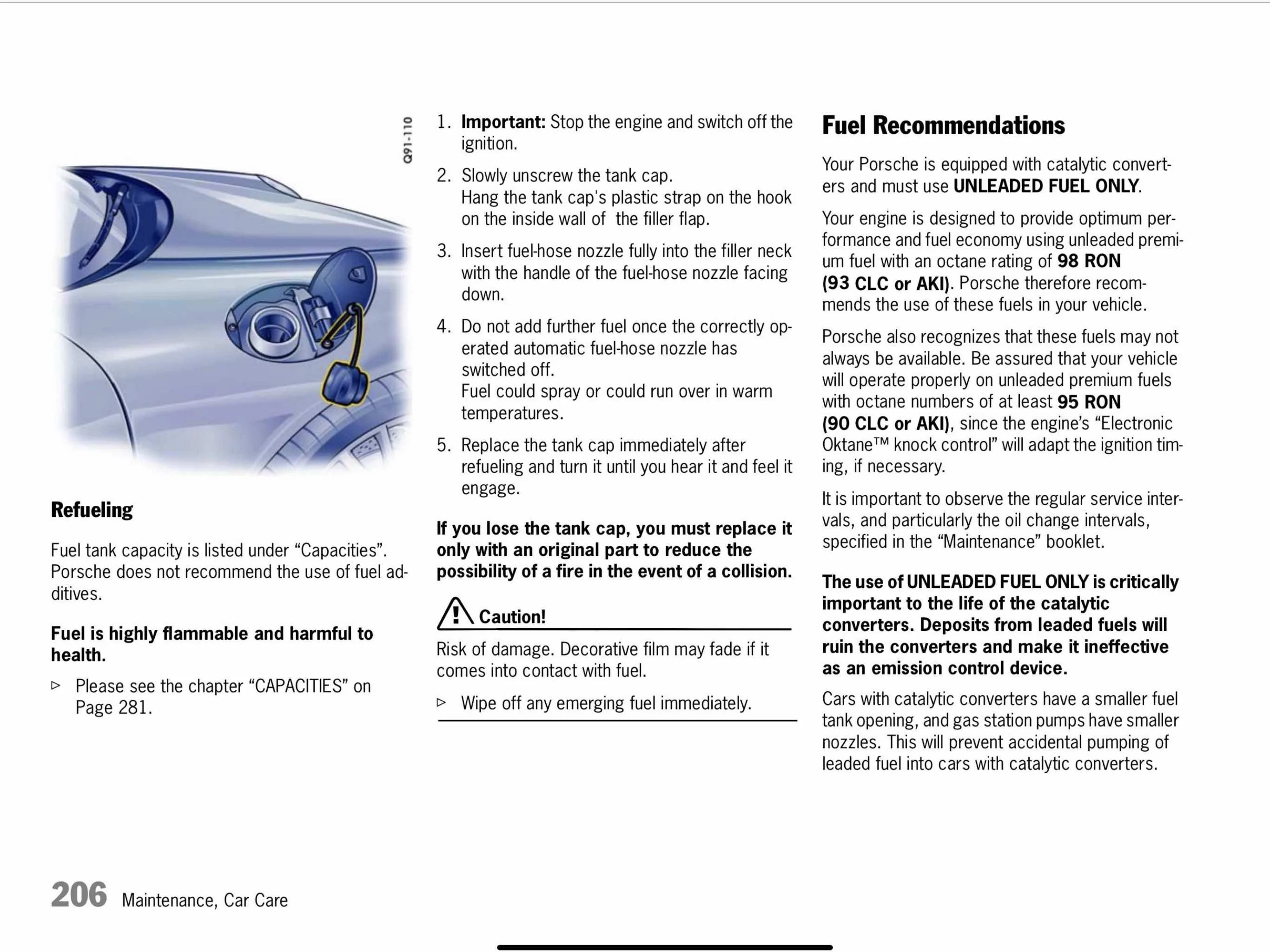

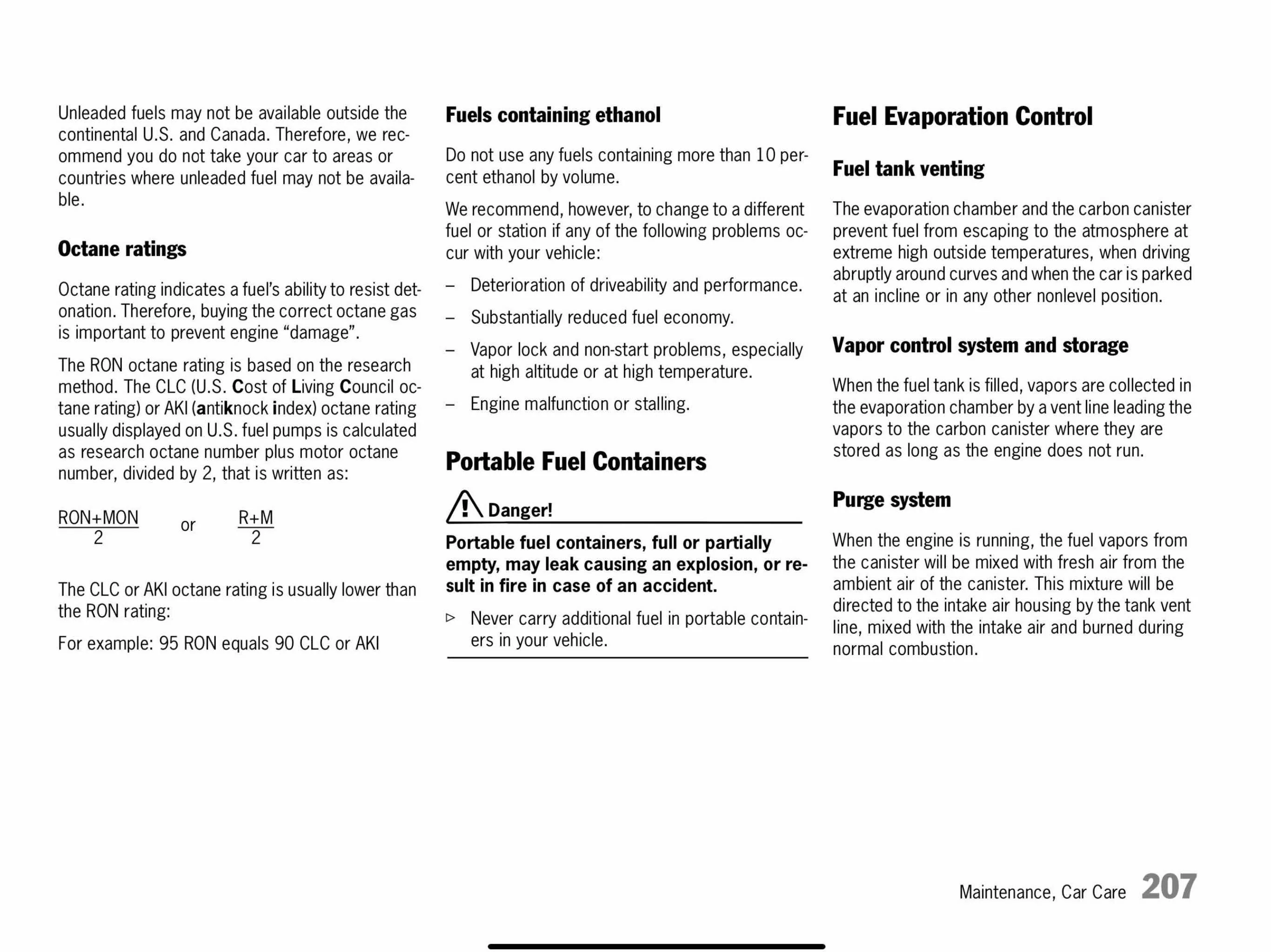

Here the Porsche owners manual talks about engine damage relating to improper octane and ethanol content.
