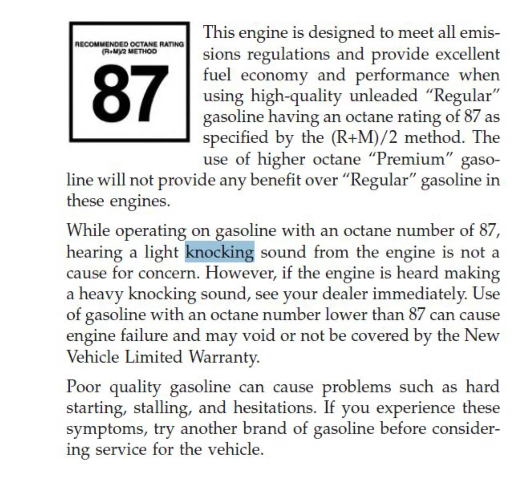

The timing is variable and is controlled by the computer. FCA/Stellantis seems to have all 3.6's programmed to advance the timing as much as possible given the conditions, maybe just a little too much for certain conditions. When I had mine, this is what a dealer tech told me, and he also said the frequency and volume of the pinging was harmless. Using higher octane in warmer weather seemed to be an anecdotal cure for the noise. However, I never felt more power or got better MPG with higher octane.

I recently discussed this same issue in a related thread, although my JL's pinging only seems to manifest for half a second between 20 and 40 mph and is very faint. In that thread, I was reminded of the excerpt below from the owner's manual. Granted, the terms "light knocking" and "heavy knocking" are very subjective, but just something to consider. Hope you get this figured out and please keep us posted.

The knock sensor isnt even picking it up. The motor is completely stock. 51,000 miles.
This statement concerns me. Are you assuming it's not picking it up or you've monitored the pid and it's not picking it up? A knock sensor should be picking up detonation pinging way before your ear can. If you're hearing it and it's not being picked up by the sensor, either the knock sensors are bad or it's not pinging, but some other rattle. I understand it stopped after the 93 octane. Could that be because the engine is running smoother with 93 and not causing the rattle?
