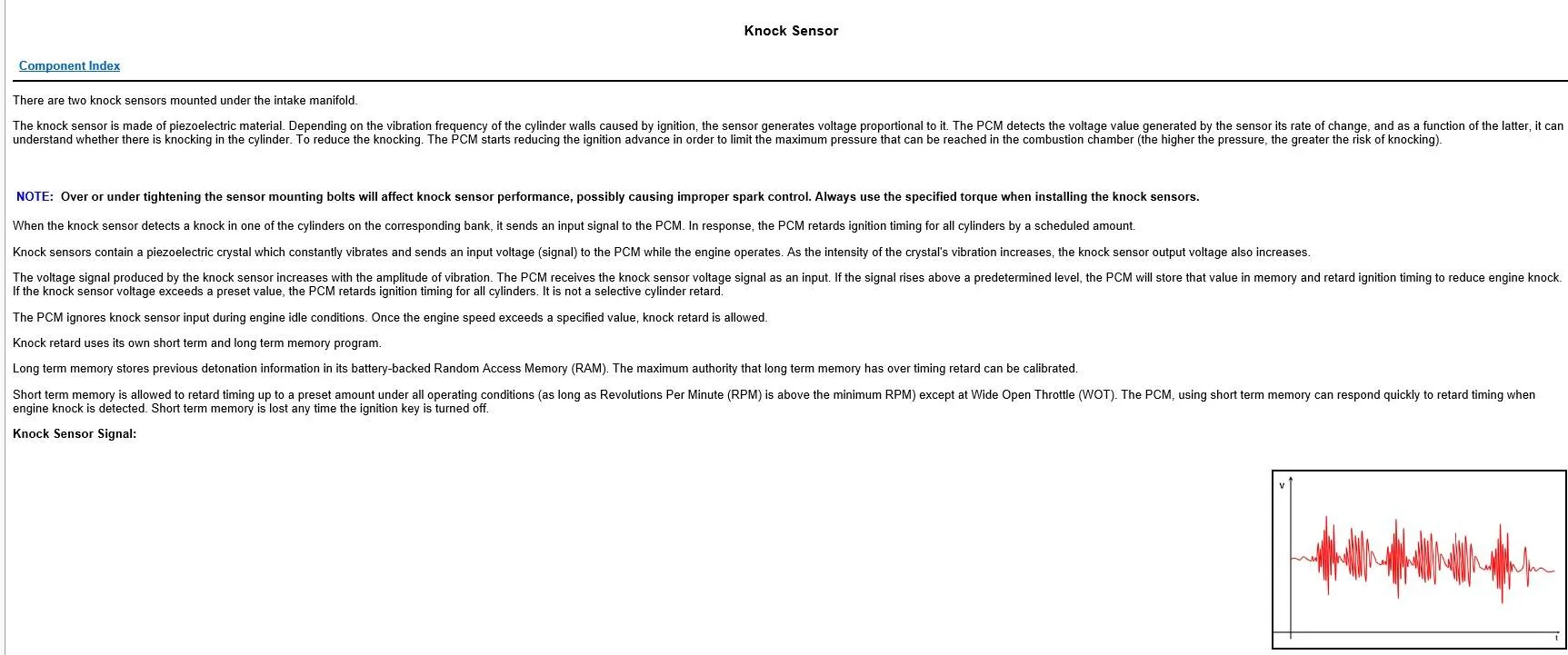

I have a 2018 3.6, auto JL. I never hear it ping. I have 37" tires on it now and it still never pings. First thing to look for is trouble codes.
Jeep Wrangler JL My engine is knocking/pinging on 87/89 octane knock sens
