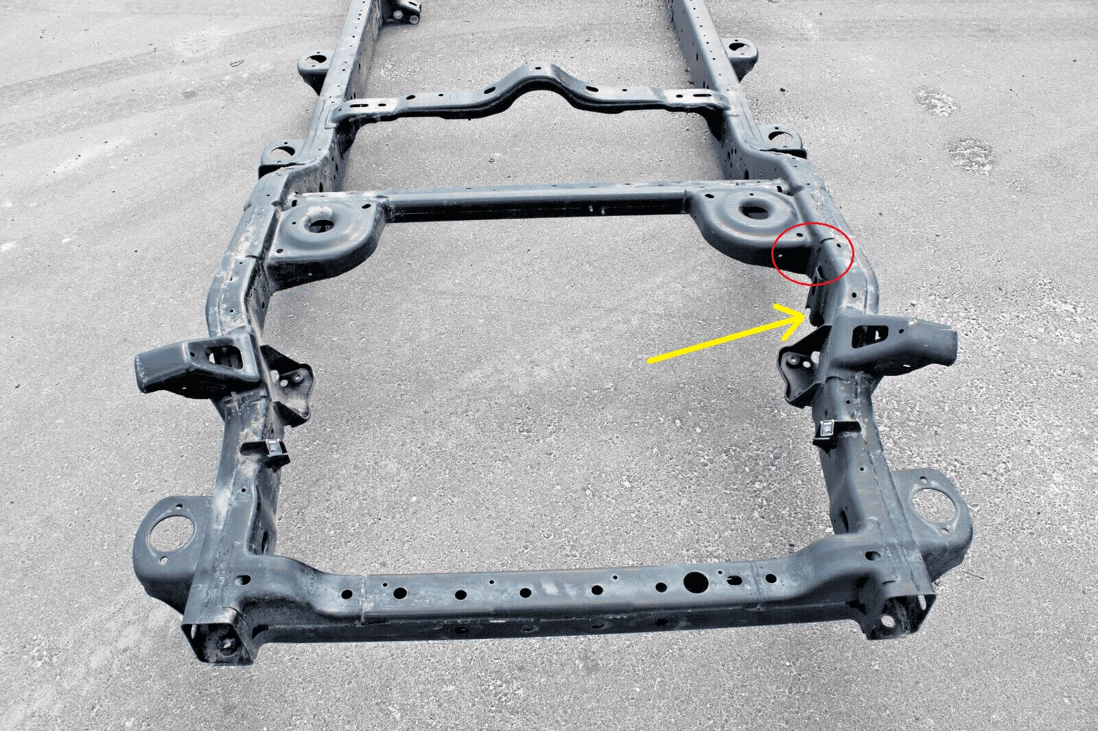

Jeep Wrangler JL 2018 JL upper rear spring perch failure..... 1715624499708-sd
AnnDee4444
Jan 14, 2019
54
5,529
7,948
'18 JLR 2.0
I think I noticed a trend: most seem to be happening on the passenger side, which happens to be right next to the track bar bracket. The forces on the track bar could try to pull the frame apart horizontally, getting the crack started.
If correct, Synergy's bolt-on brace might help prevent this. https://www.synergymfg.com/synergy-jeep-jl-rear-track-bar-brace.html
