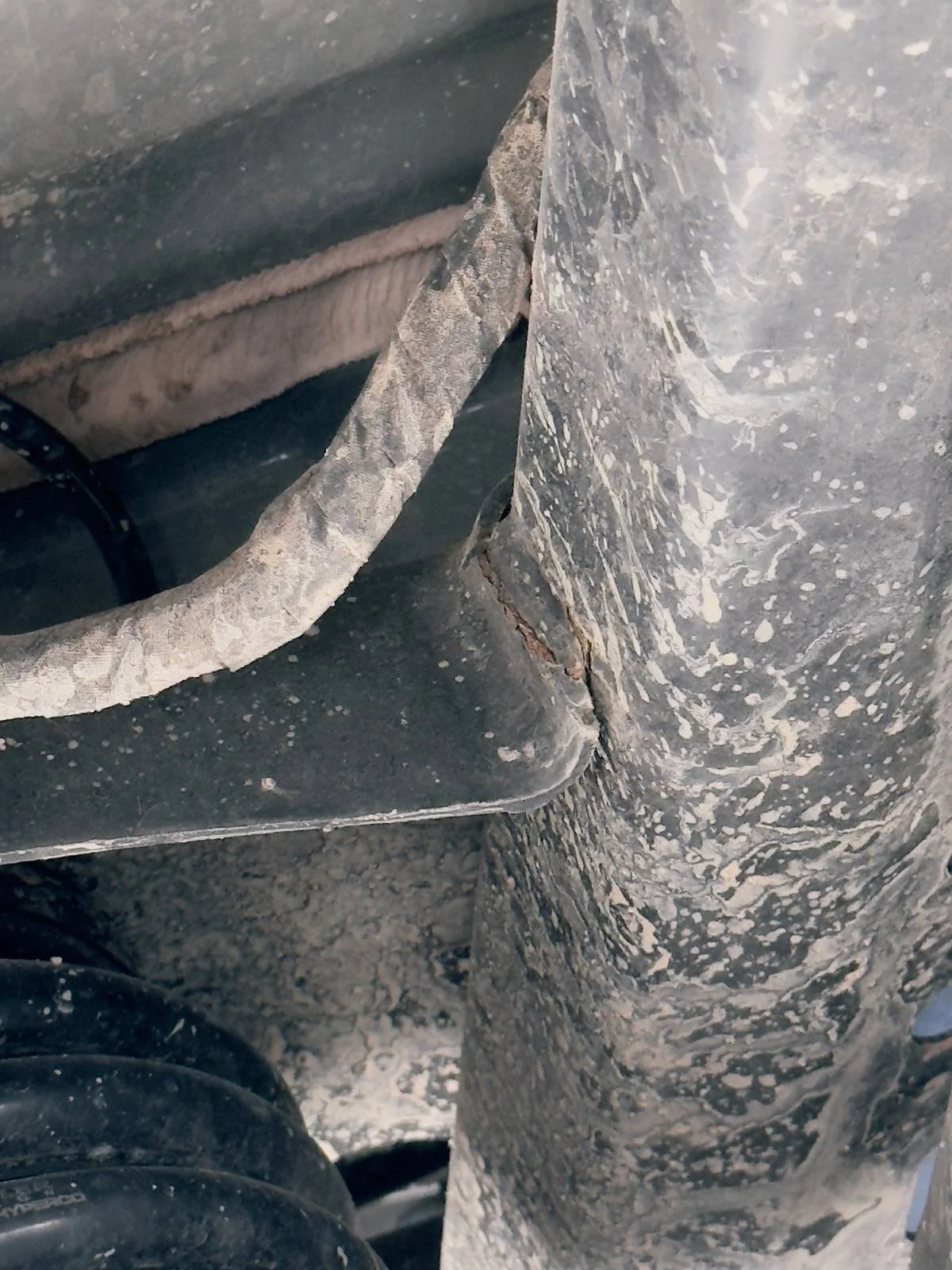

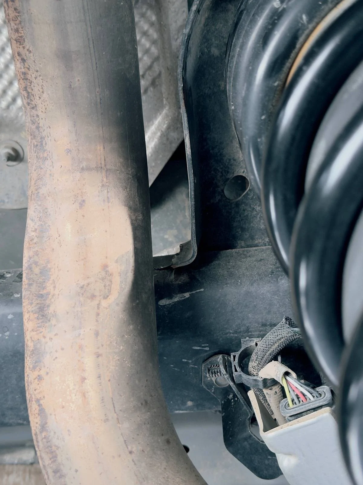

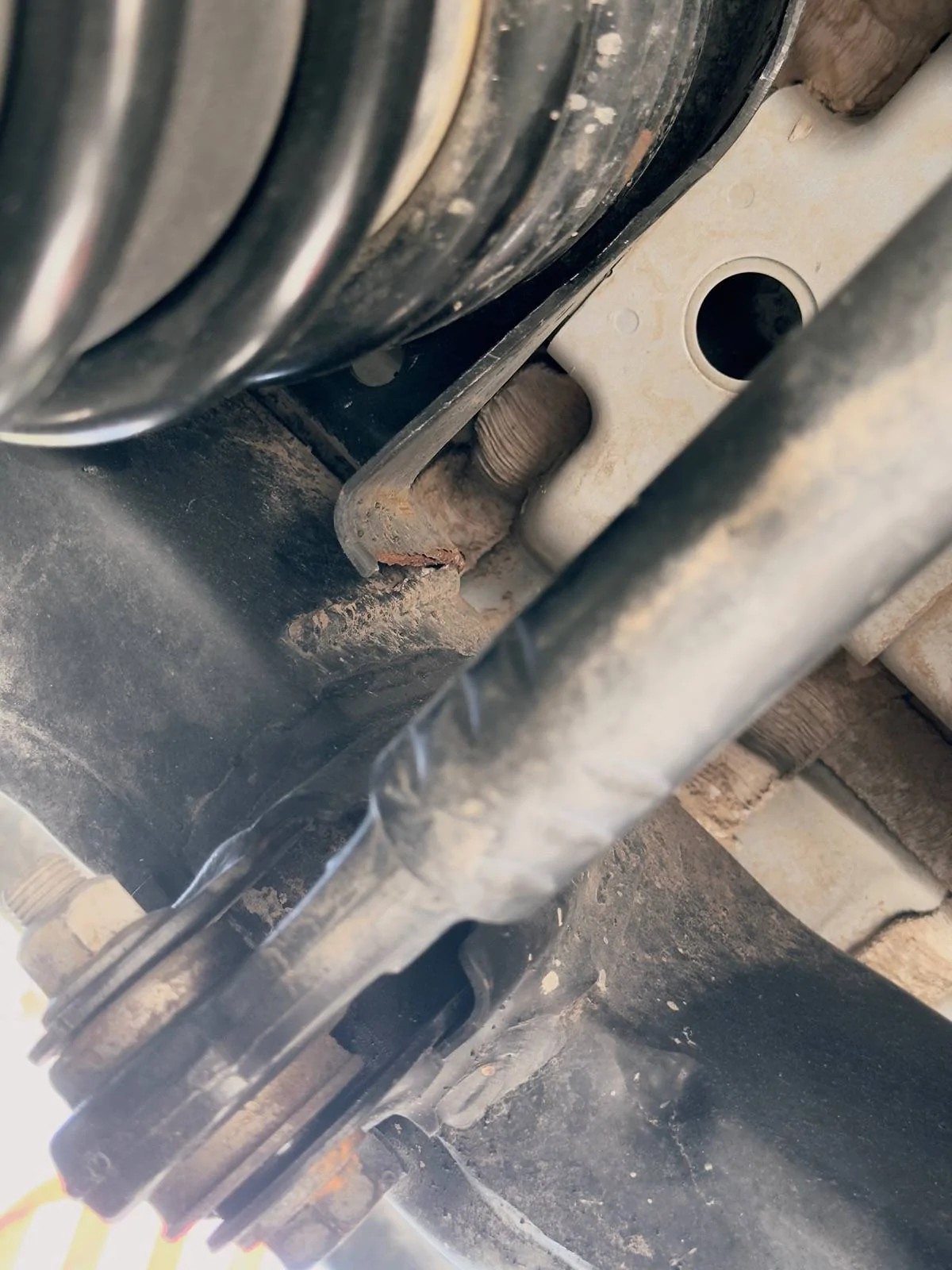

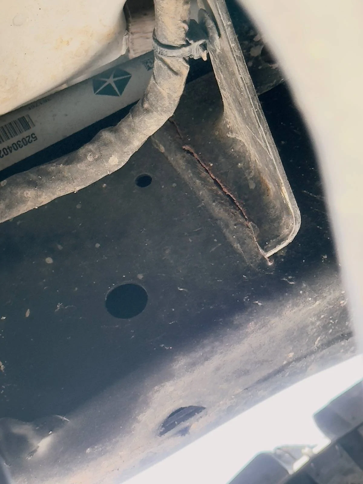

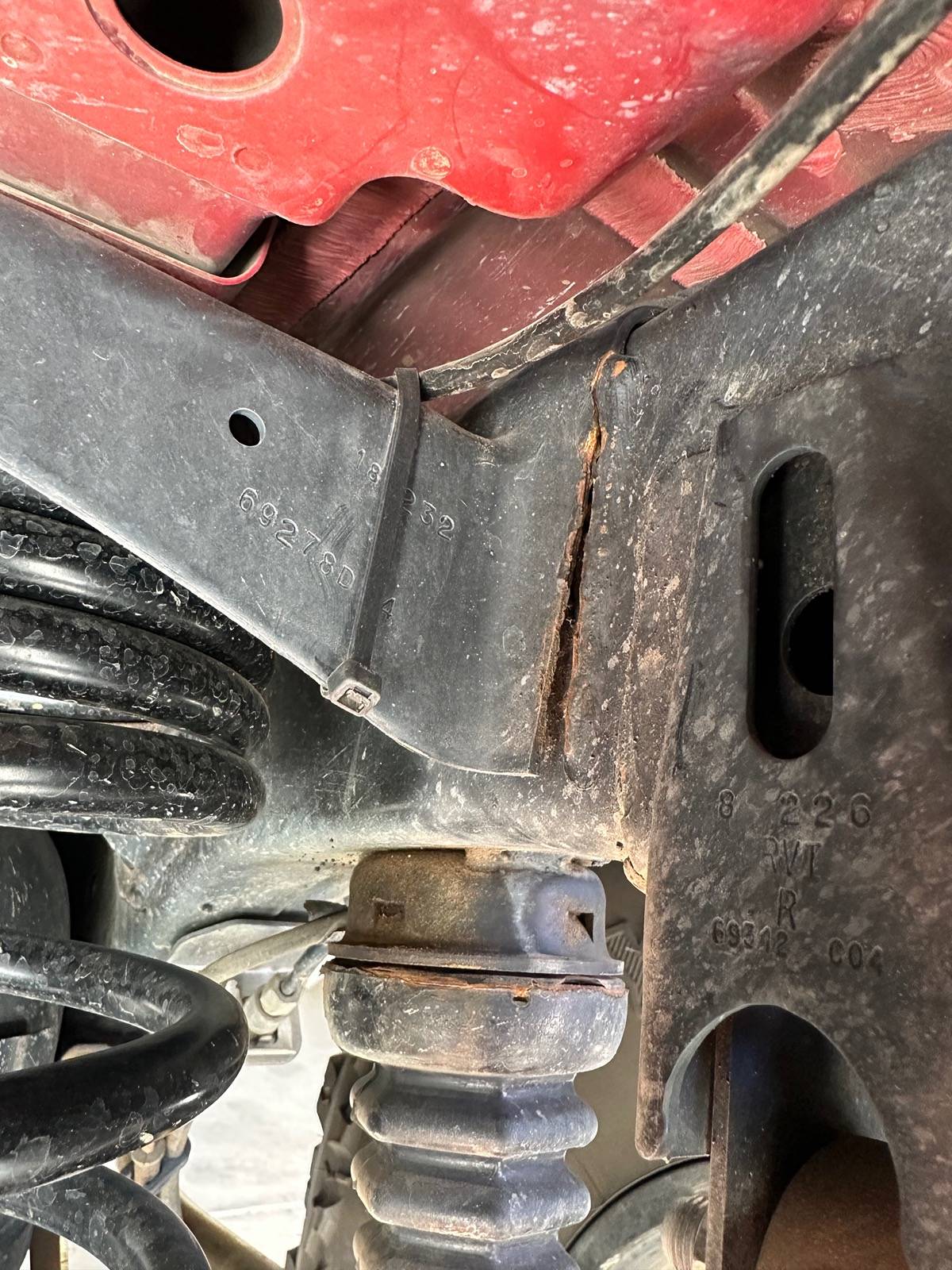

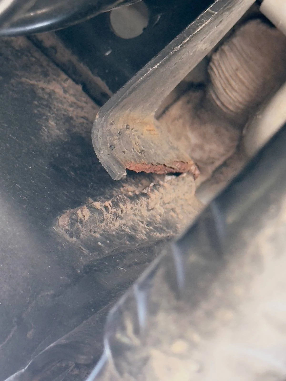

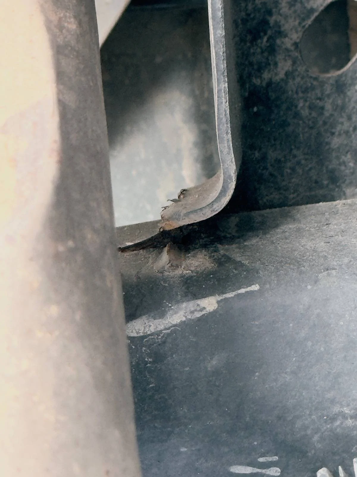

Well, add me to the club. Found this when trying to reseat the rear passenger coil after finding it had slipped off the lower isolator (probably flexed it a bit much in Moab). Both sides are tearing off the frame.
That looks like there's a lot of rust too, yikes!

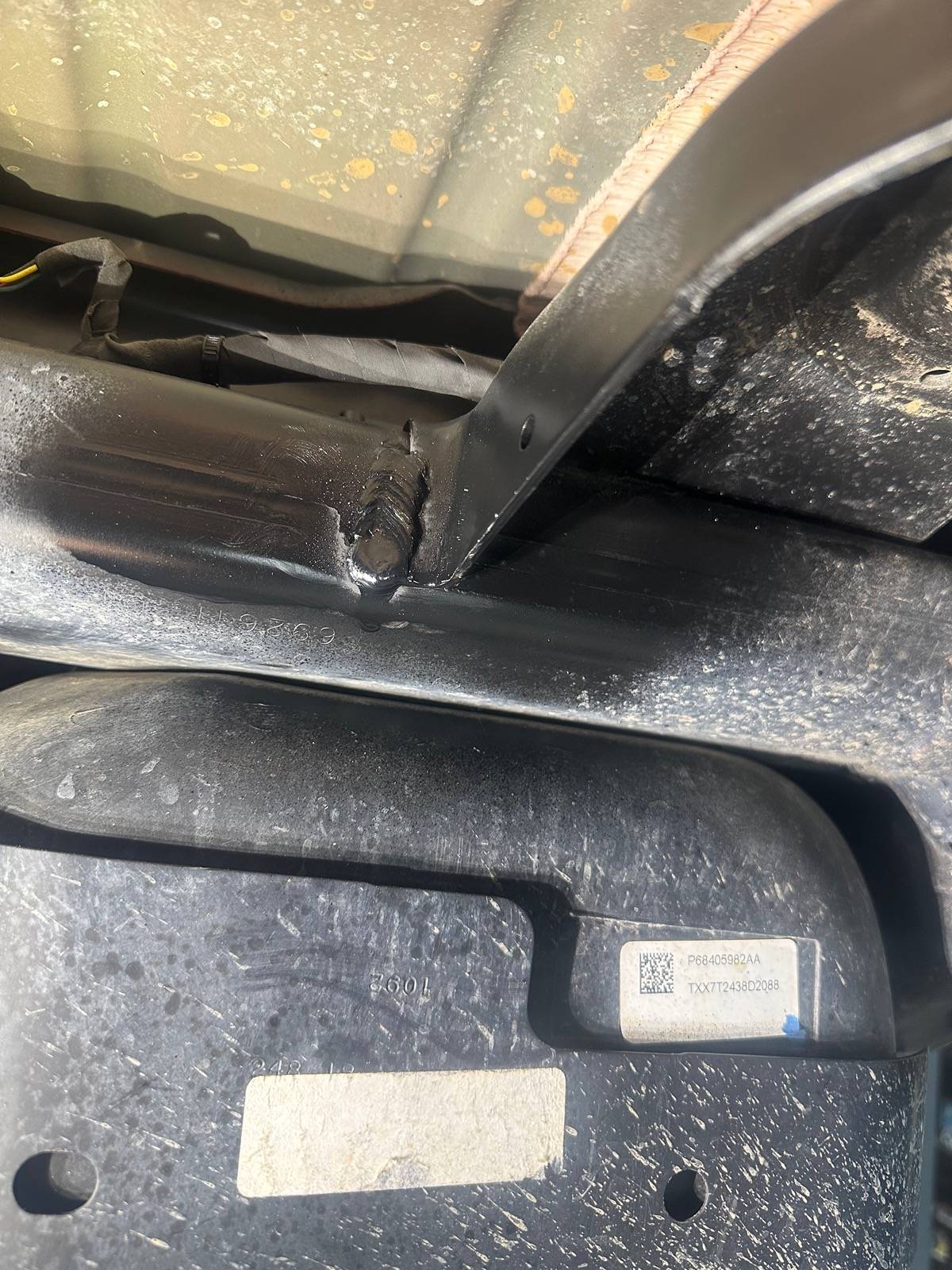

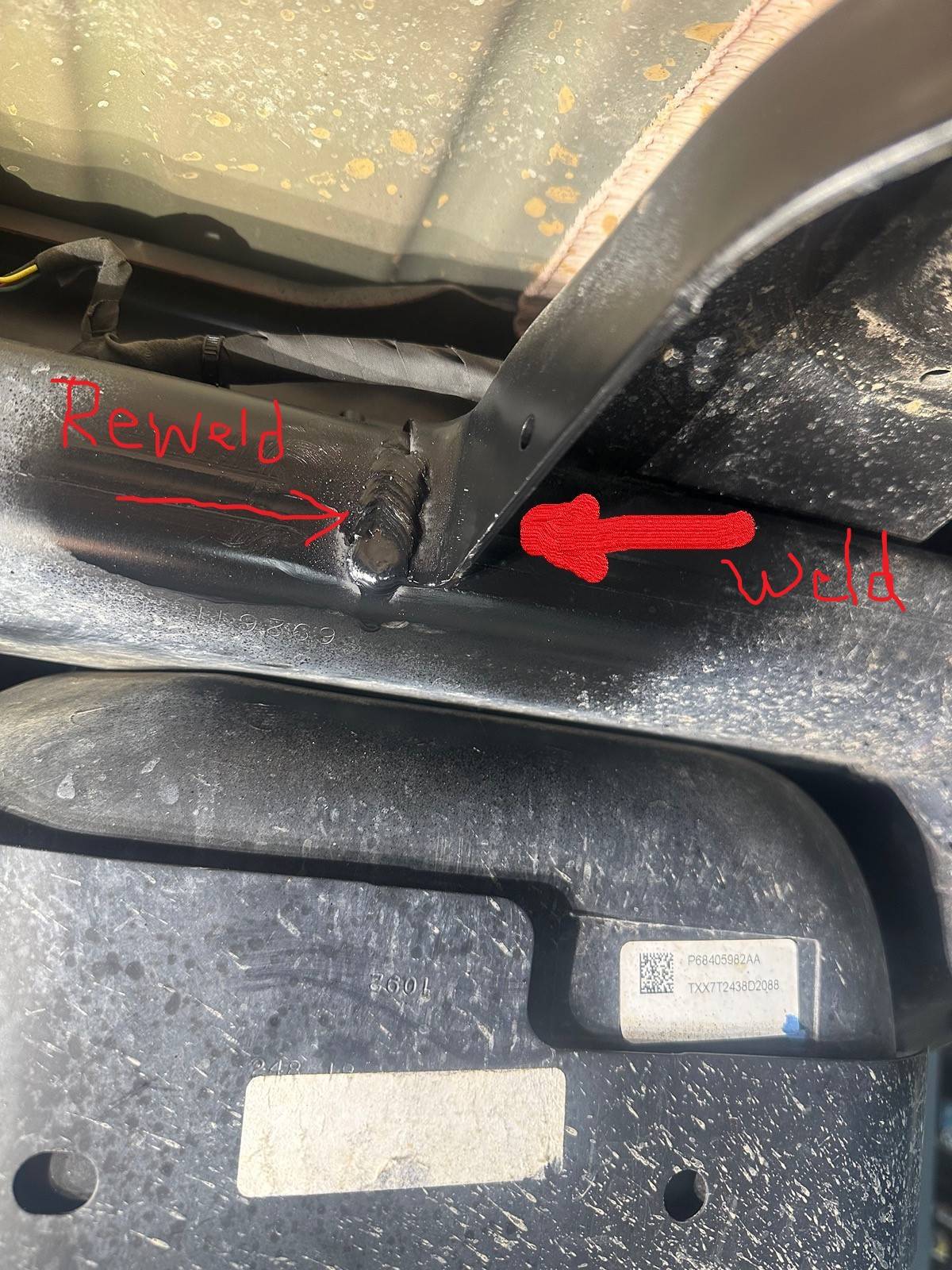

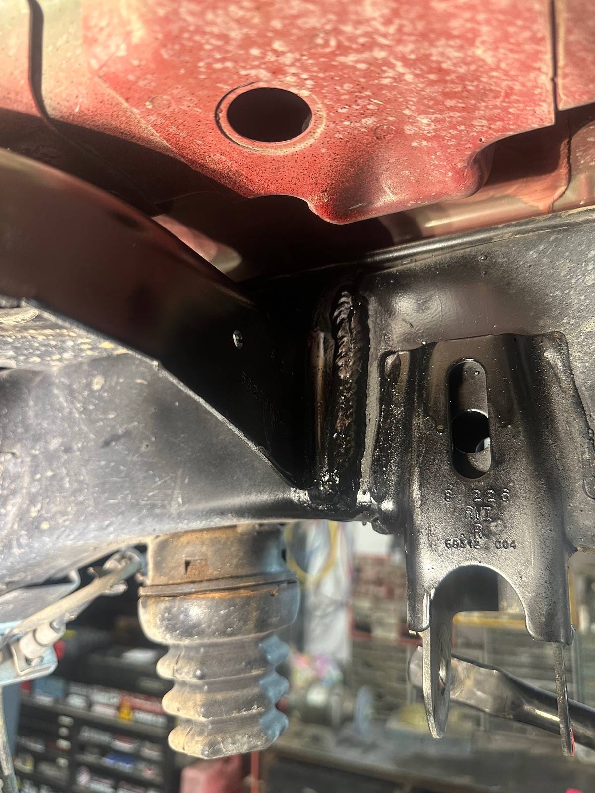

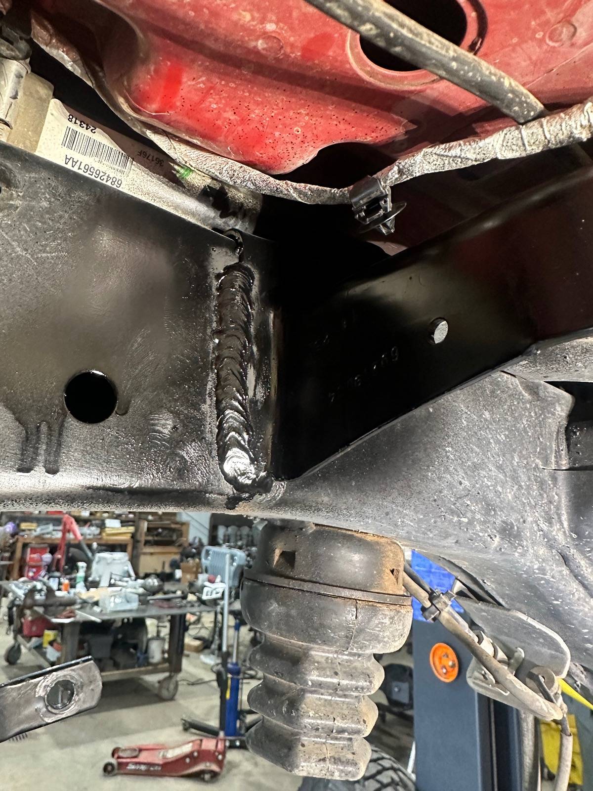

I’m going to have them welded back and gusseted like above. May see if they can add a cross member as well. Guess I should have the rear axle trussed while it’s out too. Also, it’s time for a regear ?

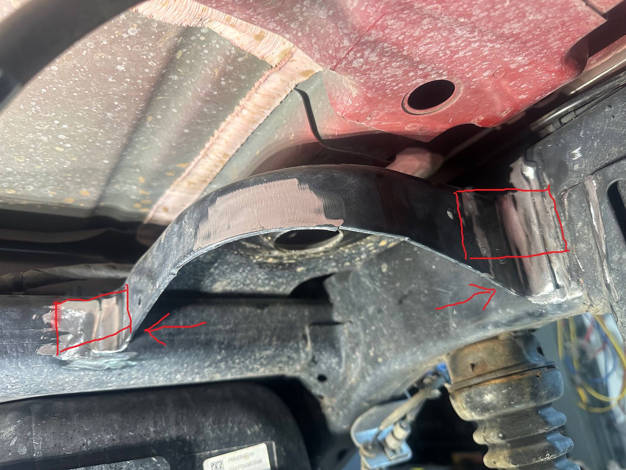

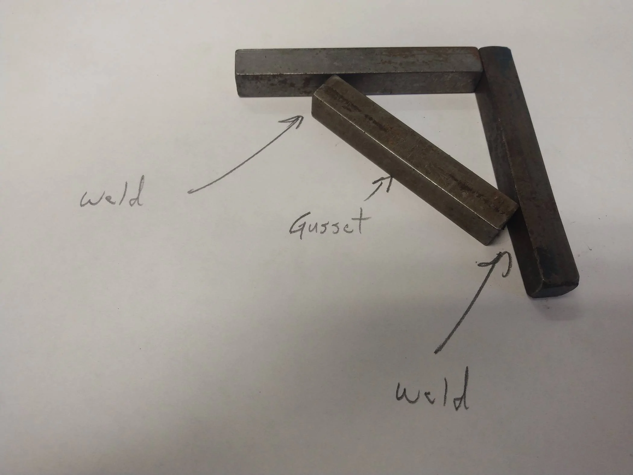

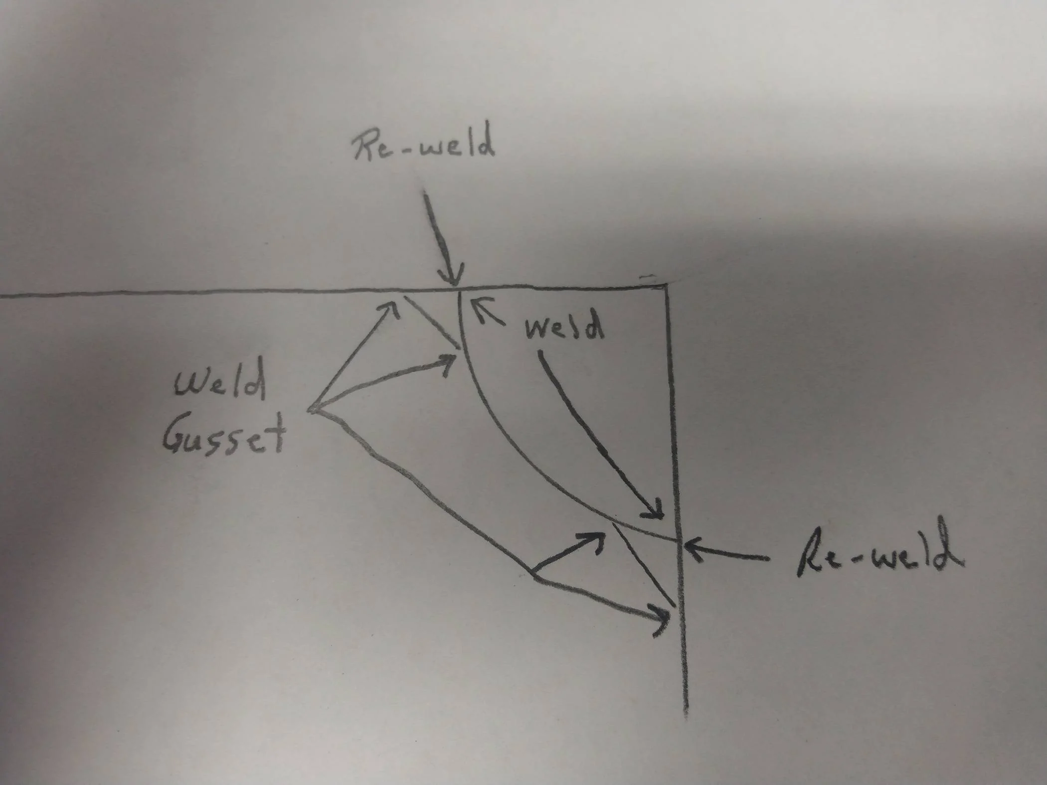

My plan:
1. Grind off the factory welds and re-weld them. Weld a fat bead on the inside of the bucket/perch pad.
2. Welding in a gusset on both sides of the bucket/perch pad will provide significant strength, without a crossbar.

My plan:
I had a very limited time in the shop to get it done (yeah I could have added more welds... ). I have a couple of trips coming up so I'll keep and eye on it.
If I see any deviation in it we're going to lift the body and remake them.
We took a scan of the buckets to make them in cad, so I wont be surprised if we just go ahead and go that route anyway.
