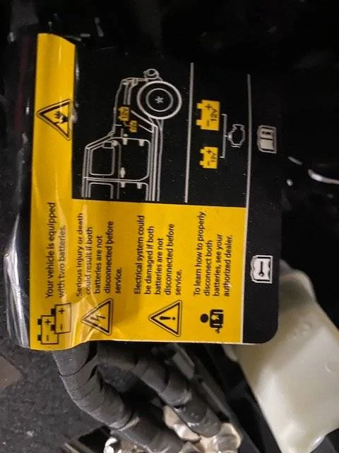

This is how I found out (picture of big label on battery wires), bummer. I disappear deep in the mountains sometime where you don't see anyone for hours or at all. Thanks to this forum, I need a jumper and to put it with my camping gear.
Jeep Wrangler JL 2.0T Only has ONE battery? IMG_0498
