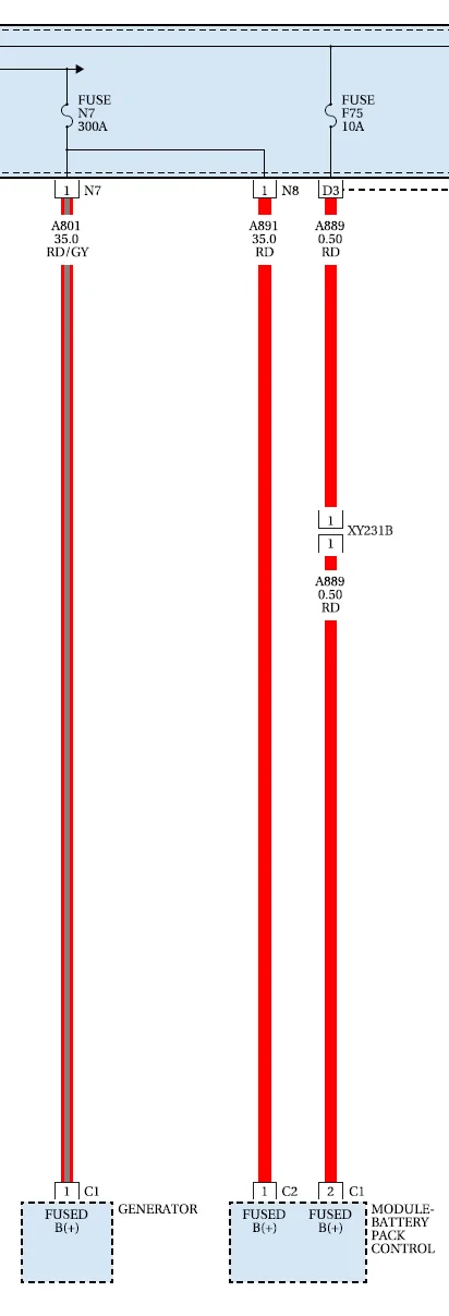

@Genesis Offroad , here's a screen shot from Fuses - Battery - eTorque schematic that appears to show a 12V connection directly from the generator to PDC terminal N7 (this is where the alternator connects on the ESS system). This would charge the 12V battery directly from the generator while the engine is running. Is it your understanding that this is not correct? I have not been able to verify this connection with any other schematic.
Actually, can anybody with an eTorque system verify whether or not they have a wire connected to N7?
Here's how mine looks. Was a quick picture on my lunch so I couldn't trace where the back wire is going.
Jeep Wrangler JL 2.0T Only has ONE battery? 20210302_135122
Jebiruph
Jerry
Feb 18, 2018
57
2,403
3,000
Iowa
2018 JLU, 2020 JT, 2024 WL
Thanks for the pic. No wire on N7 - the schematic is wrong.
