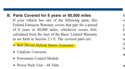

Because it's part of the etorque system and considered part of an emmissions device, like the etorque batter is, it may be covered under the same party of the warranty. I believe it's 80k miles (I forget the time, but at least 5 years) Worth a shot. That generator is expensive.
100% agree. Jeep however doesn't play nice. They state this is a basic bumper to bumper part. So is covered under the 3yr/36,000 mile warranty not the power train as it should be. This is such a wrong interpretation of this part of the Jeeps system. Once agian the small guy gets hosed.
Actually, it's 80k miles or 8 years for all of the etorque components, including the belt start generator.
Don't let them pull that. At the very least it's part of the drivetrain. It's attached to the engine and provides some forward movement al very low speeds. Bumper to bumper is for body stuff. Anything attached to the engine is drivetrain. If the engine won't run without it, it's a drivetrain component. If it triggers "P" codes for the check engine light, it's drivetrain.
I fully agree with not letting them easily brush someone aside. Especially because I'm pretty sure the entire etorque system is considered an emissions system. Emissions is a much stronger word in service work, than drivetrain is.
Best of luck, OP! And don't hesitate to try multiple dealers in your area. You're not obligated to the dealer that you bought the jeep from.

I would 100% argue that with the dealer. alternator should 100% be considered part of the powertrain regardless if its the etorque generator or a regular alternator
An alternator is definitely not a drivetrain component. However, the BSG is not an alternator, and is covered by the emissions warranty as stated by others.
The real question though is how did someone test the generator? The BSG produces 48V, not 12. It sounds like your welding fried the hybrid system inverter which is where you get your 12V.

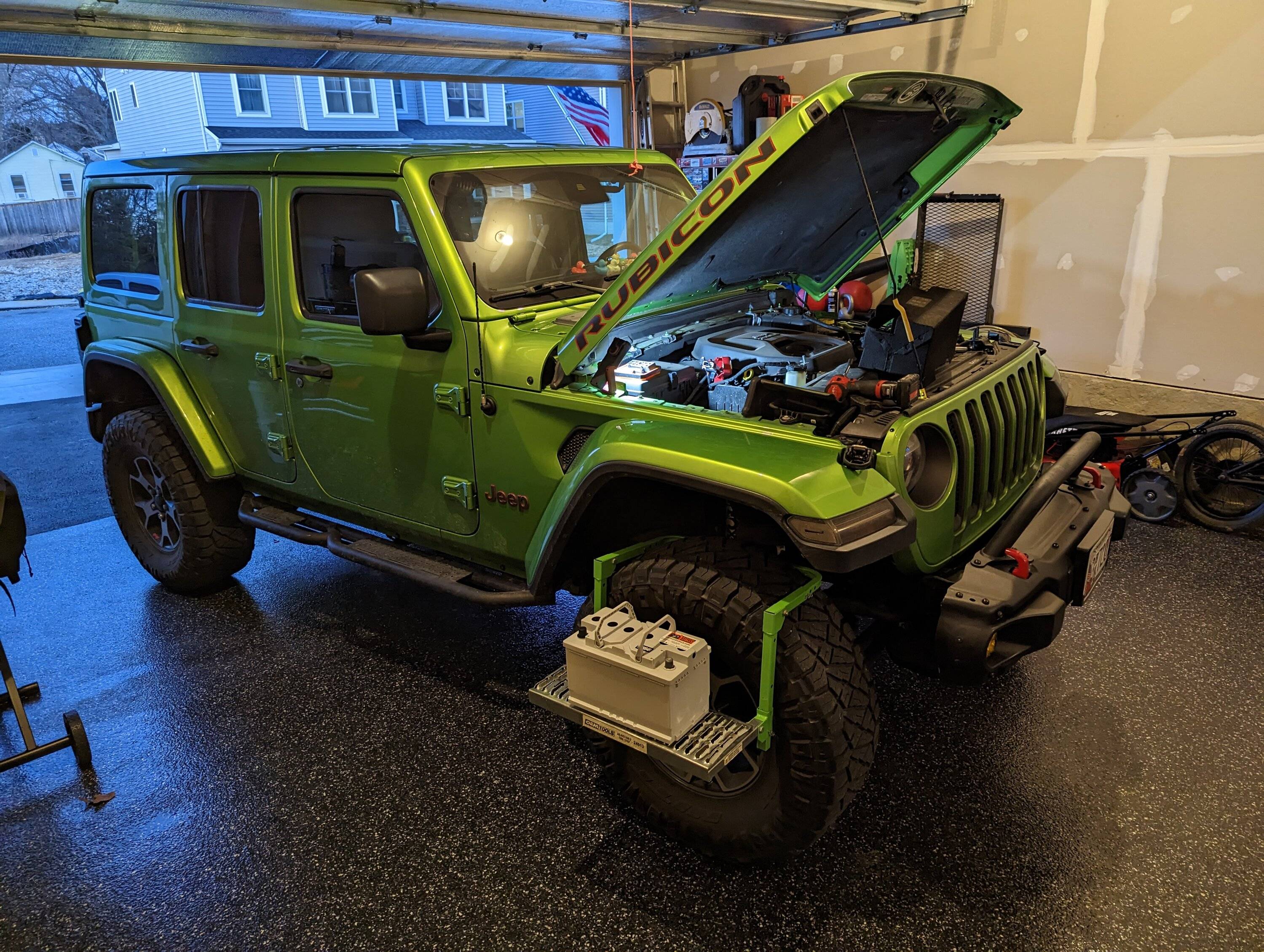

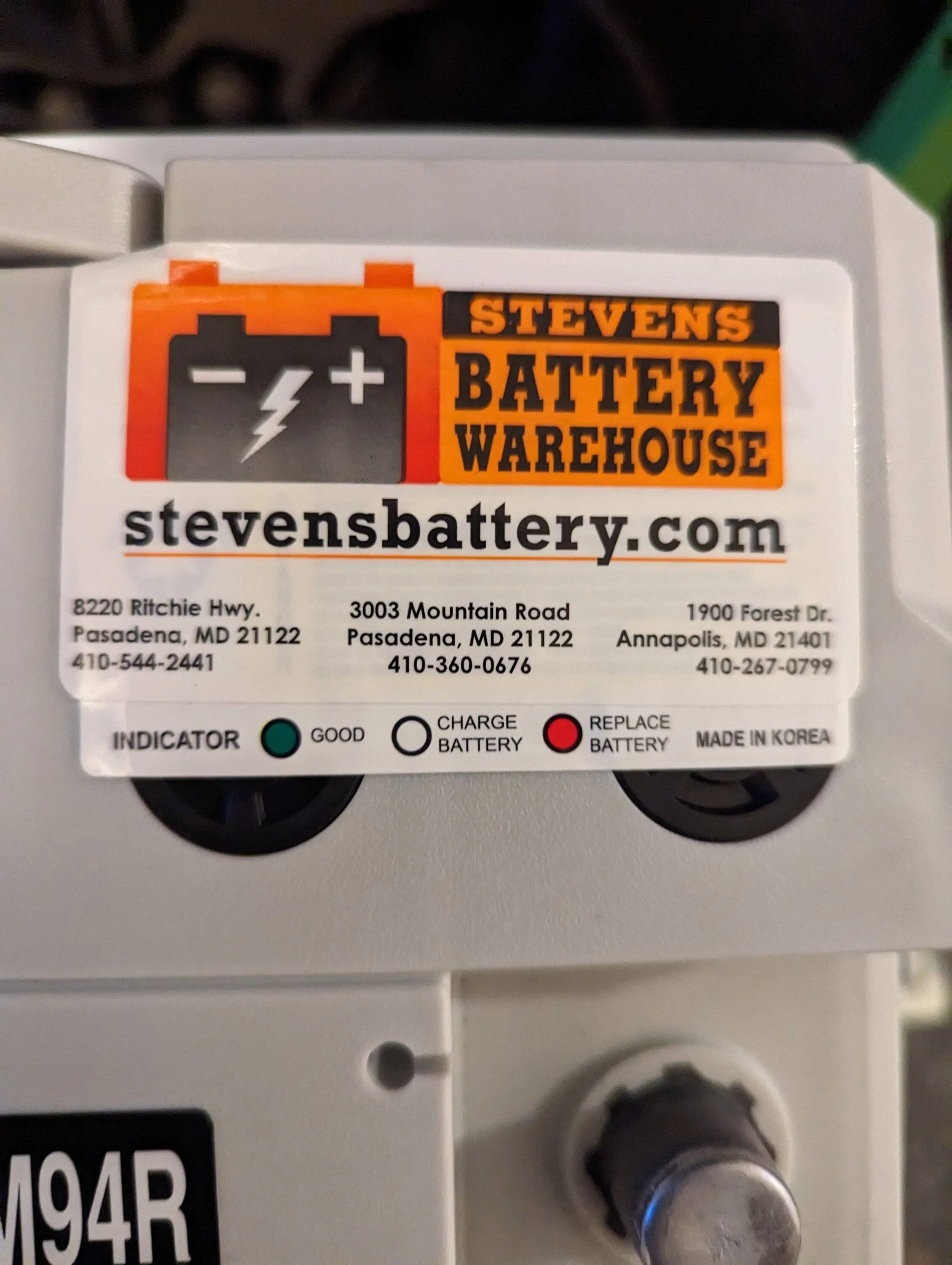

Load tested the battery quickly went from 11.9v to 8.6v w/o the motor running.
At idle it was charging at 14.3-14.6. So the alternator is good, battery is toast. So I just went to a local batter warehouse and they were surprised I got almost 4 year out of the OEM battery. Their batteries come with a 12 month replacement for free and prorated out to 5 years.
Time to install and test
