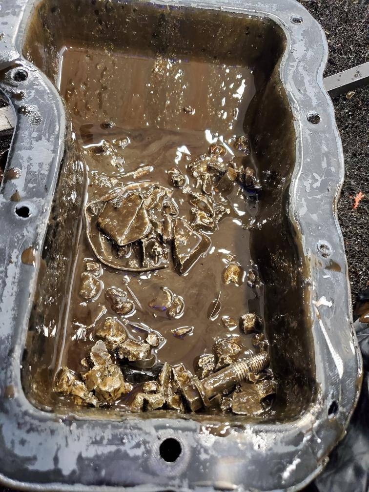

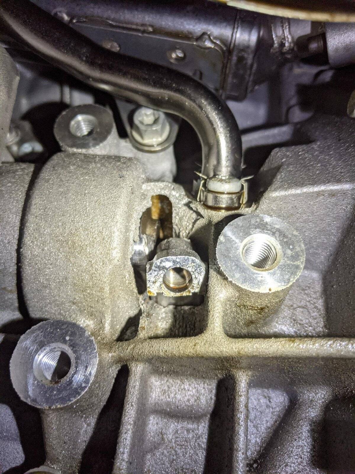

Hi all, new to the forum. I do have some input on the knock with my 2.0. I too thought it sounded odd however I hadn't owned a 4 banger in years. It sounded pretty much the same as the sound clip and would go away after warming up. It never got worse until.....I was leaving the house one day and it finally got worse and in that minute of noise the engine died and now the rod sticking through the block tells me it was a bad noise. Still under warranty getting a new engine, turbo, and computer.

Yeah, Sorry I can give you a sound on the knocking I too once had. How about a visual? Here is the inside of my 2.0 oil pan after 40,000 miles. This is the carnage from the connecting rod sticking out of block as I posted earlier. Jeep still at the dealership getting new engine, almost 2 months now.
Missing bearing cap bolt found.

Ouch!!!
