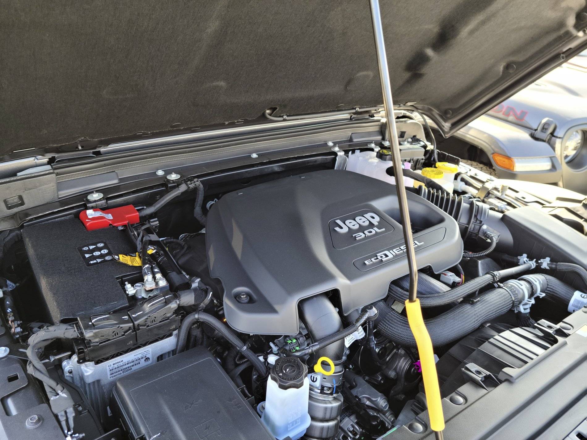

On my 3.0L diesel, the aux. battery is below the main battery. The main battery is moved back to the front of dash (some folks call it the firewall, but it is not a firewall) and the PDC is moved forward of the main battery.

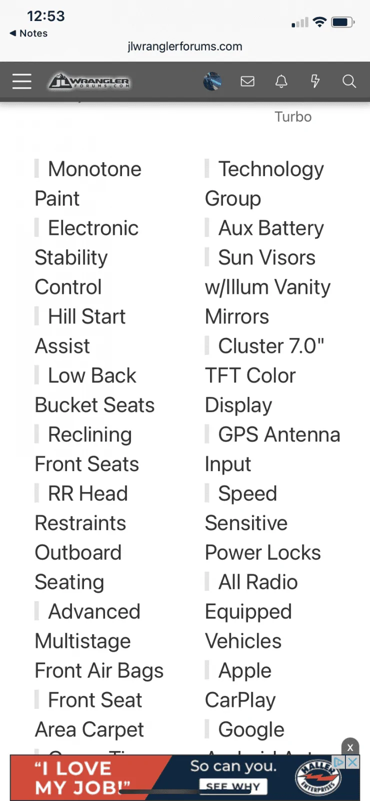

I have the 2018 JLR Turbo with e-torque (LOVE IT BTW), So I don't have the Aux battery under the main battery, correct?
Also would the Aux battery be listed in the build/spec sheet for those that don't have e-torque???
Yes it’s listed, see my post #34.
