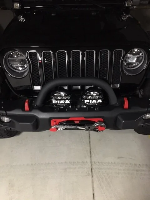

Mounted the Maximus 3 winch plate with Smittybilt Gen 3 winch this weekend...No issues on the install, everything went smooth. The clearances are super tight between the Gen 3 control box and the grill, like millimeters tight...but man, this thing spools FAST. Probably the fastest winch I've ever used. I will say that using a quality ratchet set is key, you need one that makes micro adjustments with a swivel head in order to get those inner bolts on easily. A crappy wrench with bad ratcheting action will have you wanting to cut yourself. Now I just need to figure out where to wire the positive LED power wire for the control box LED...Any suggestions??

For those with the Maximus-3 plate with hook anchor - how's the red match up with the OEM red hooks on the bumper?
