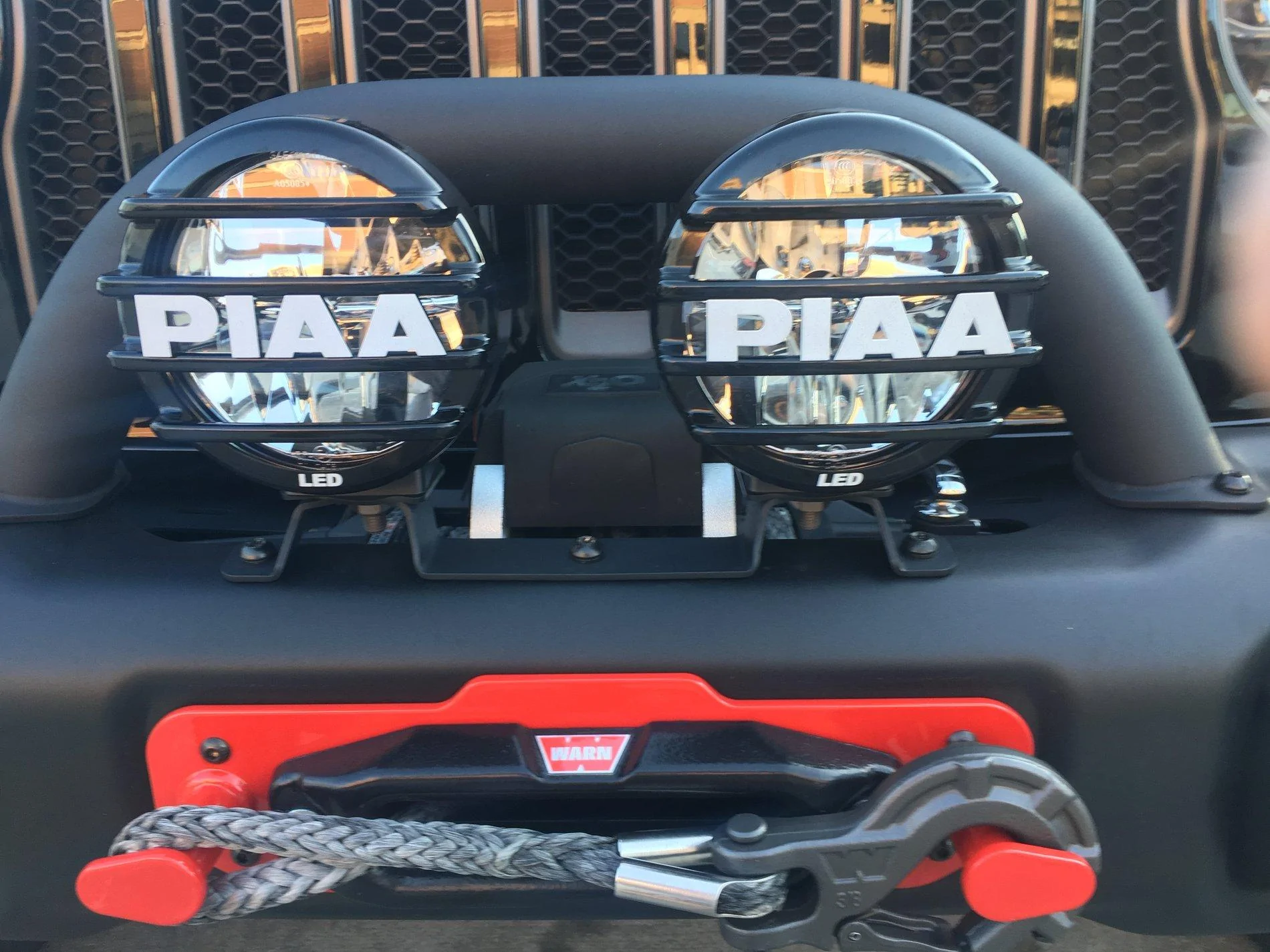

Yea it’s the SLP hoop. I also used the Maximus 3 light bracket. It’s part no. JL1007AB. The lights are 6 inch. Tried to get a better pic.Is that the Maximus-3 SLP Hoop? If so, what did you use to mount your lights and what size lights are those (5-inch)?
