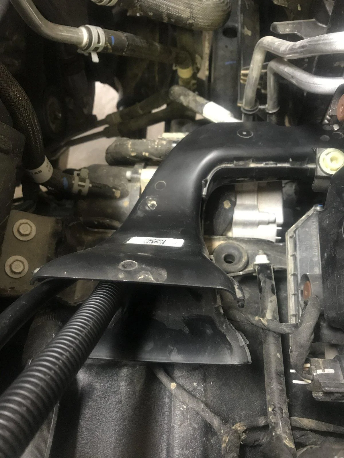

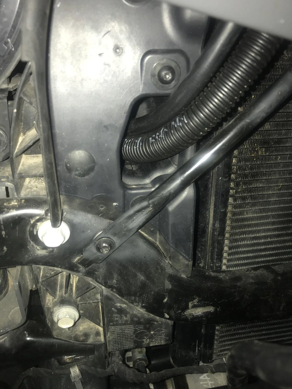

I don't think I've run across this tip when mounting your winch, and routing the cables.
If you remove the grill (6 clips and it pulls out relatively easy), you can route the cables around the frame, up under the airbox to the battery area.
Clean install without the cables showing.
I had the typical cable issues we all seem to have experienced, but removed the grill today, and found you can tuck everything away nicely. Simple 10-minute project...
Just a tip if you are interested.
