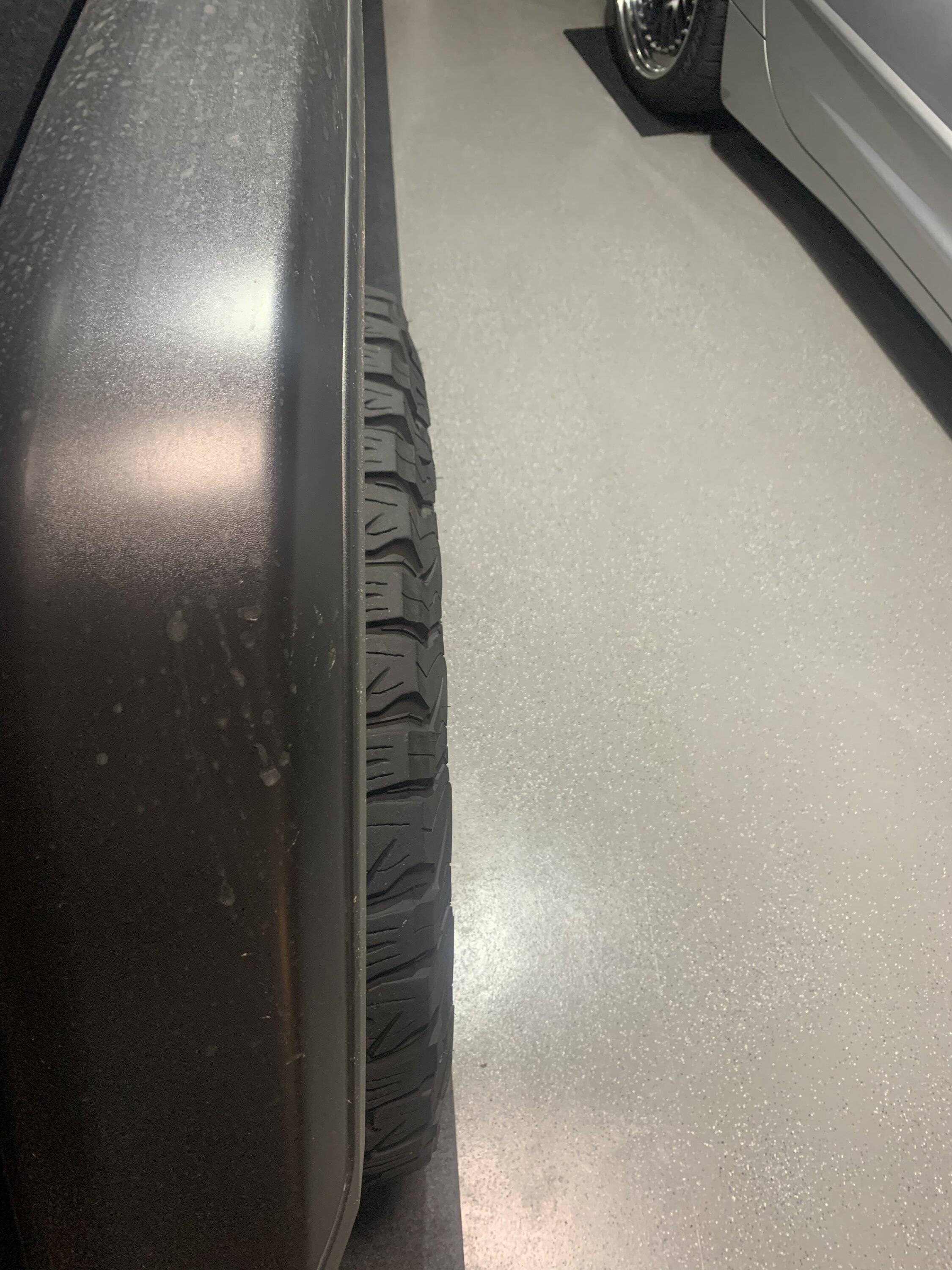

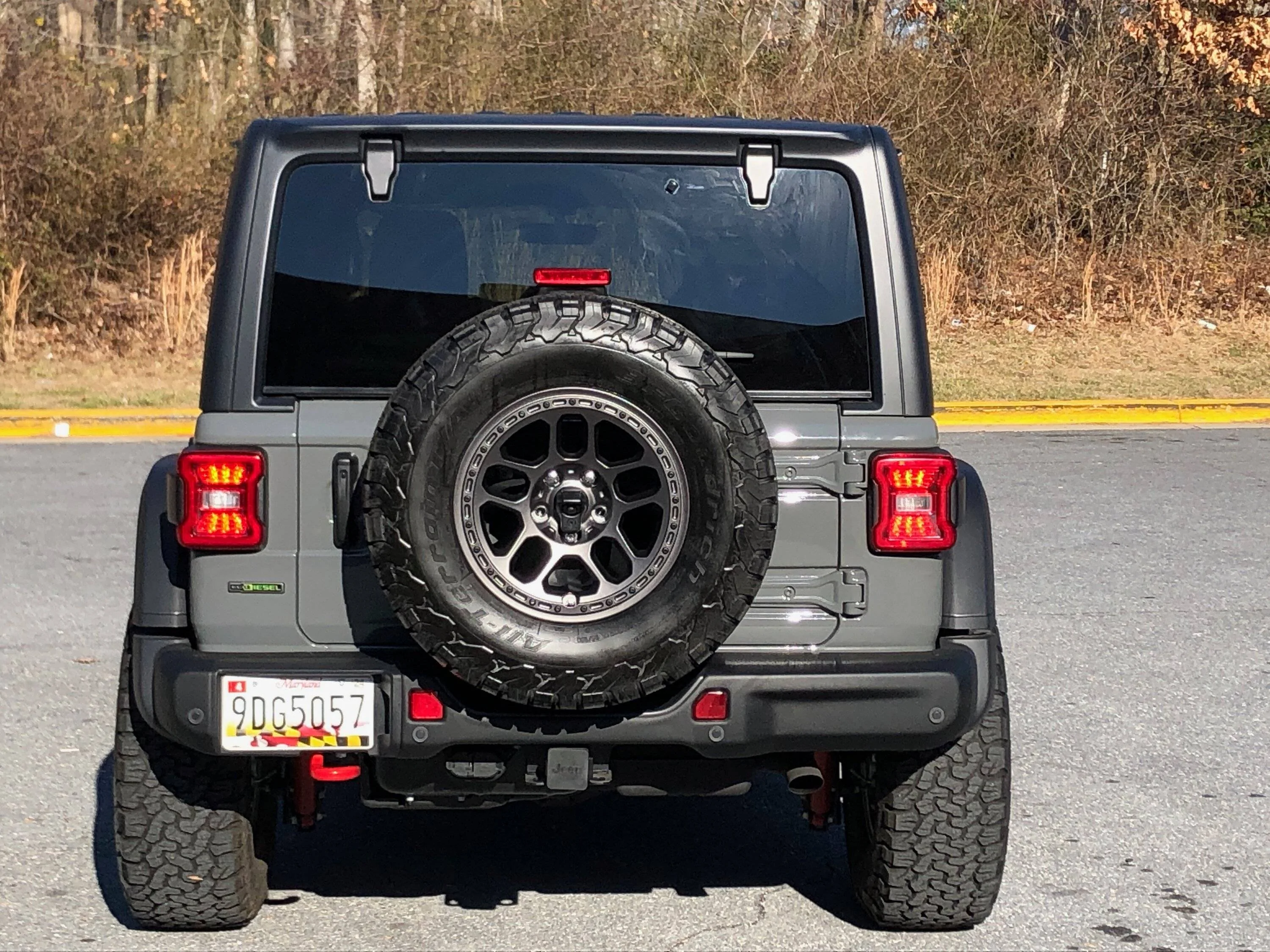

Here’s an argument in favor of a small amount of poke that came about around 2 hours ago. First here’s my level of poke:
Jeep Wrangler JL why do people like poke? 9197B790-C4E7-4286-A47A-8AB9C144121E

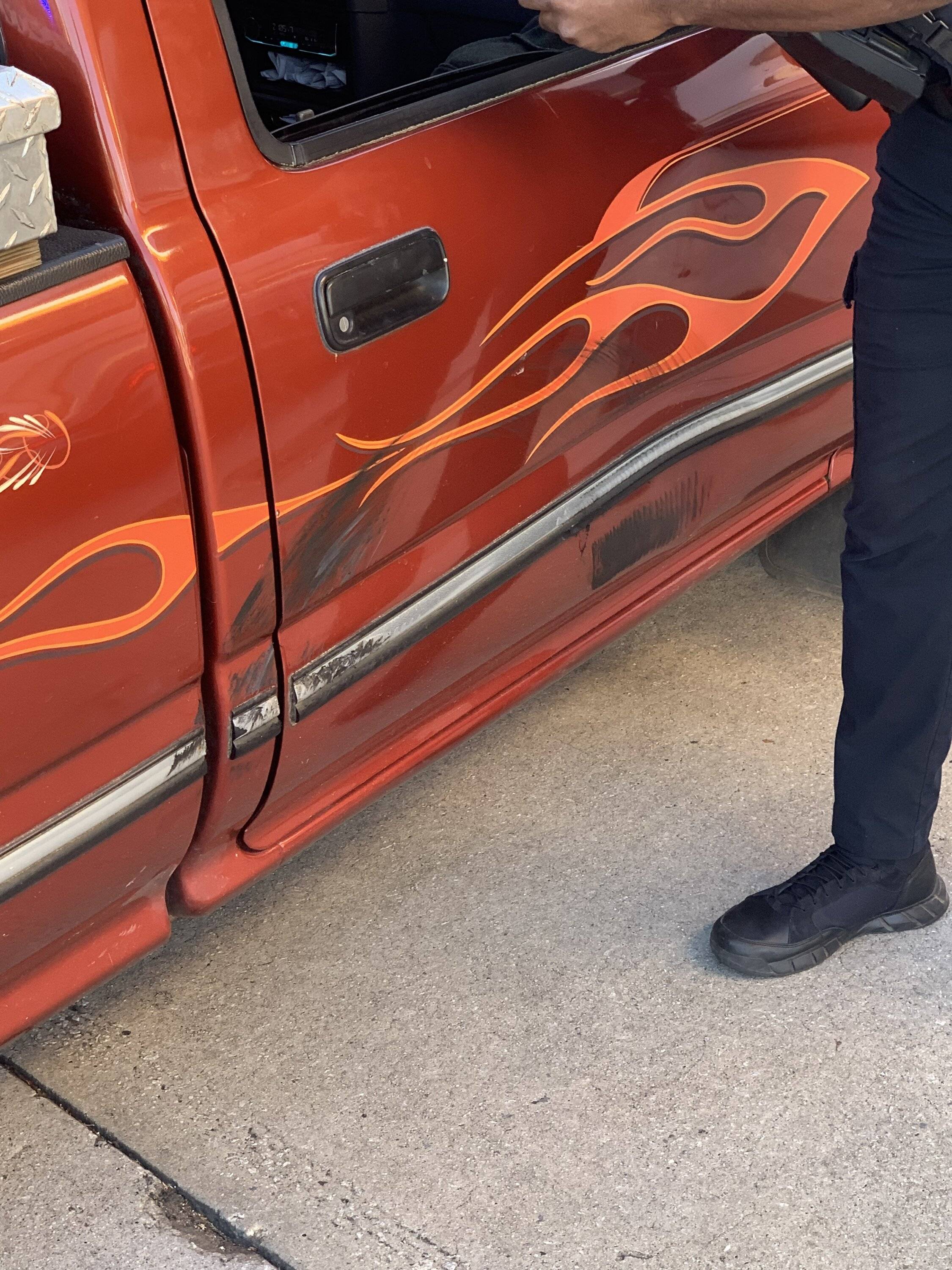

Now, here’s the side of the asshole’s truck who changed lanes into me a few hours ago:
Jeep Wrangler JL why do people like poke? 82668AFB-0151-49B9-BD00-FE89B941AC6B
Notice the round, black, 35”-sized tire marks on his dented door. I had a few scuffs on my fender and a slight scuff on my rear driver side door. Tried to get a pic but I buffed them all out to where you can’t see them anymore. But the white letters on my KO2s have seen better days. Until I clean them that is. I have the original Mopar beadlocks and they weren’t touched.
I thank poke for preventing any actual damage to my Jeep.

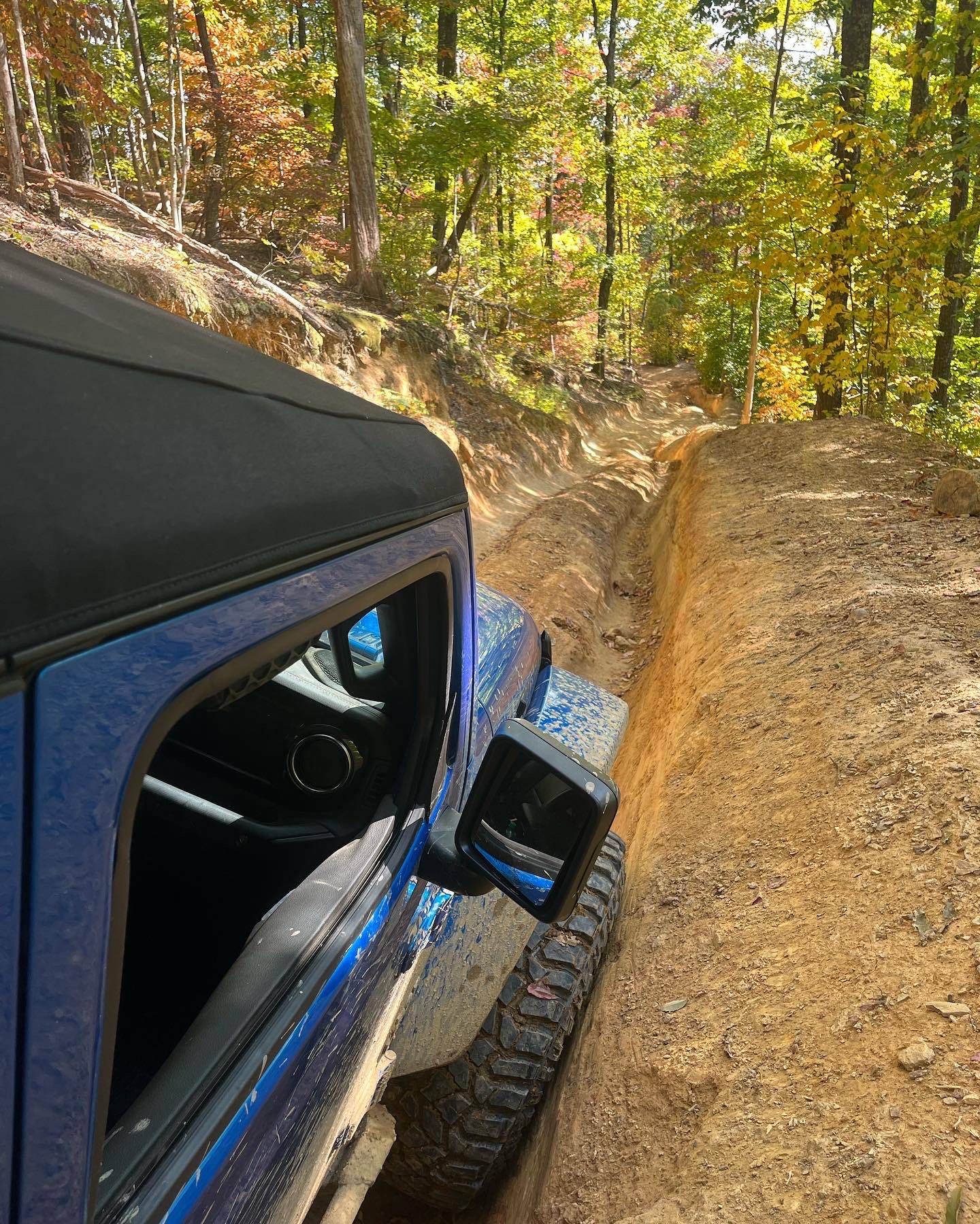

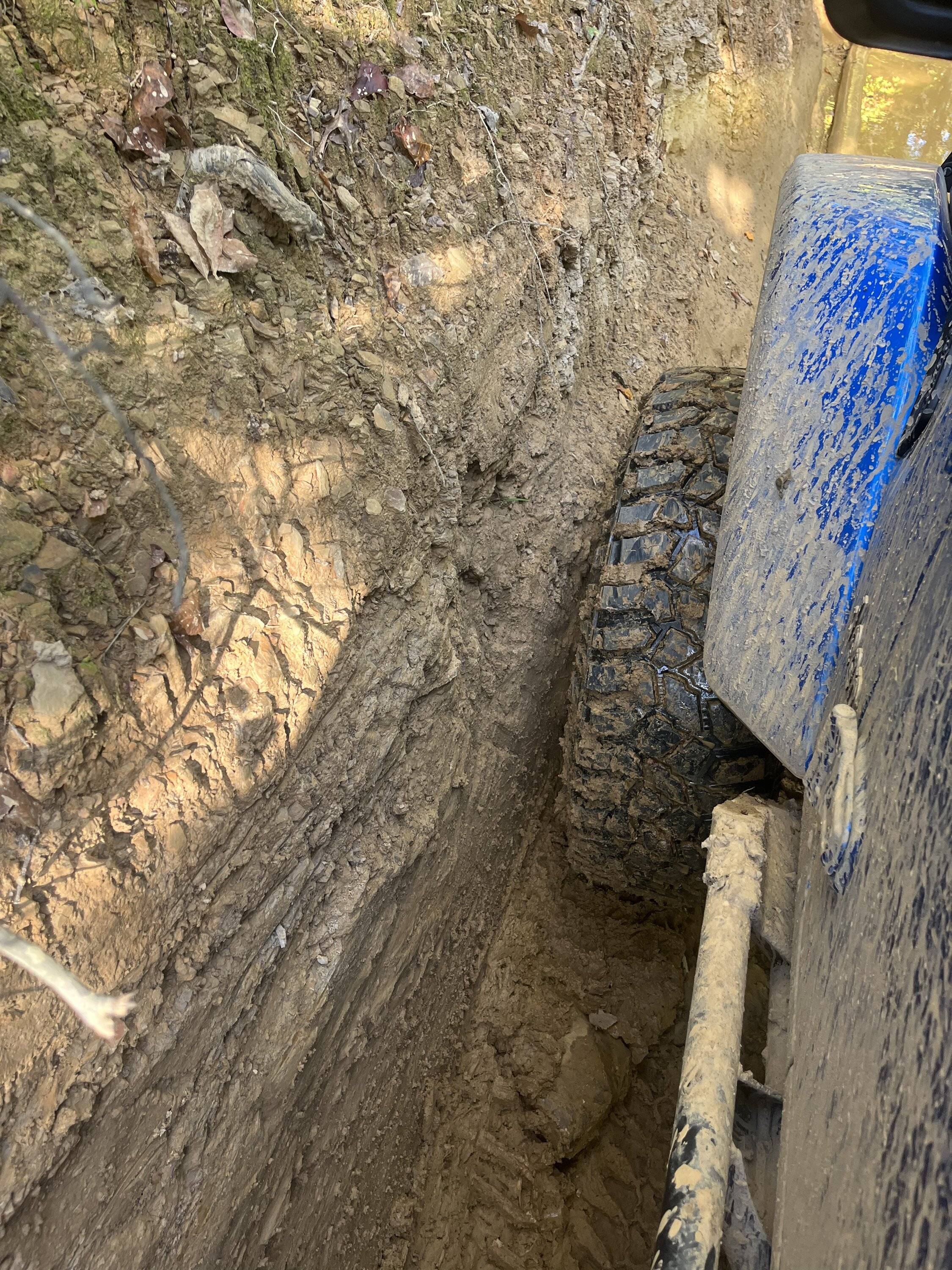

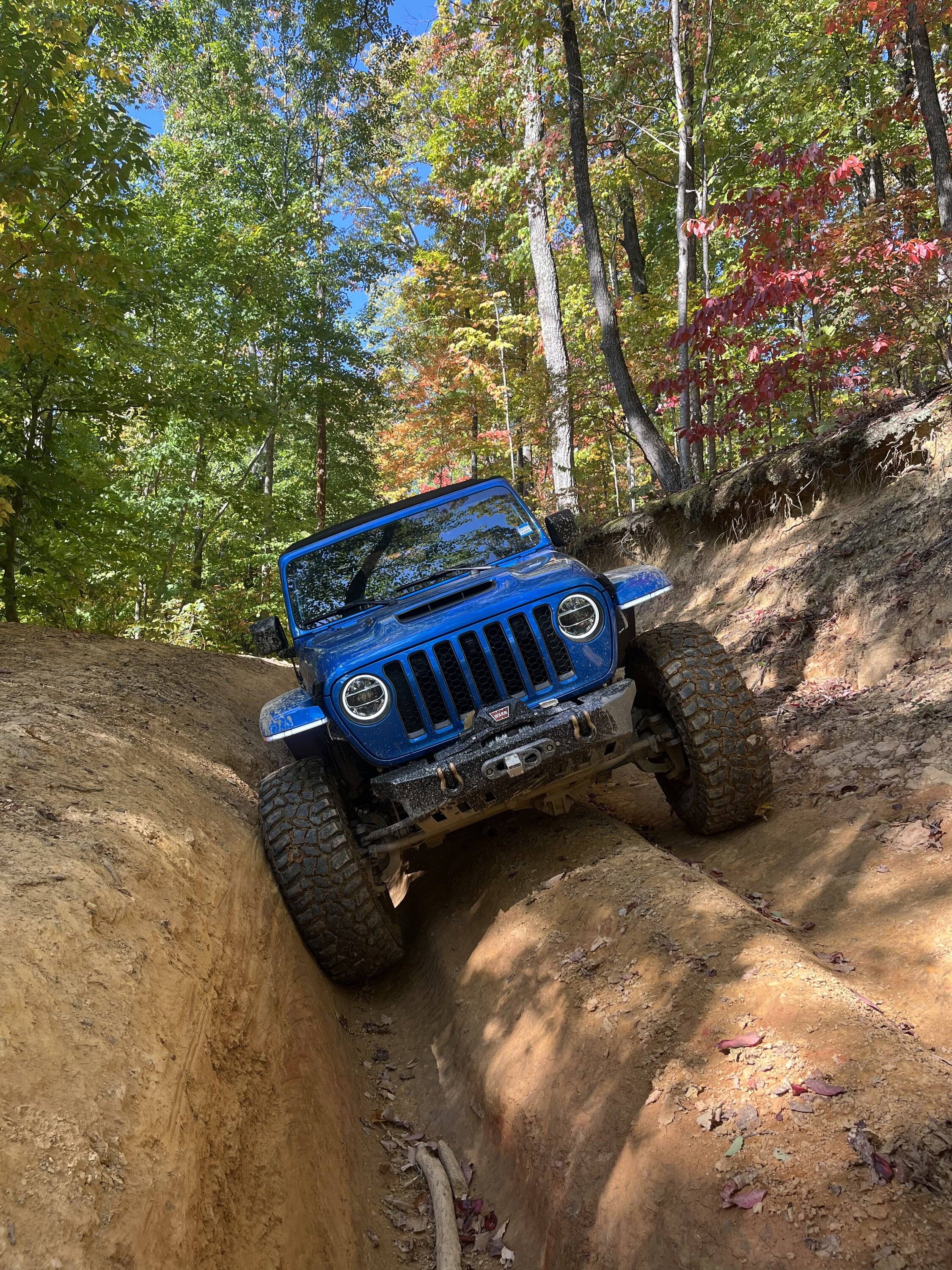

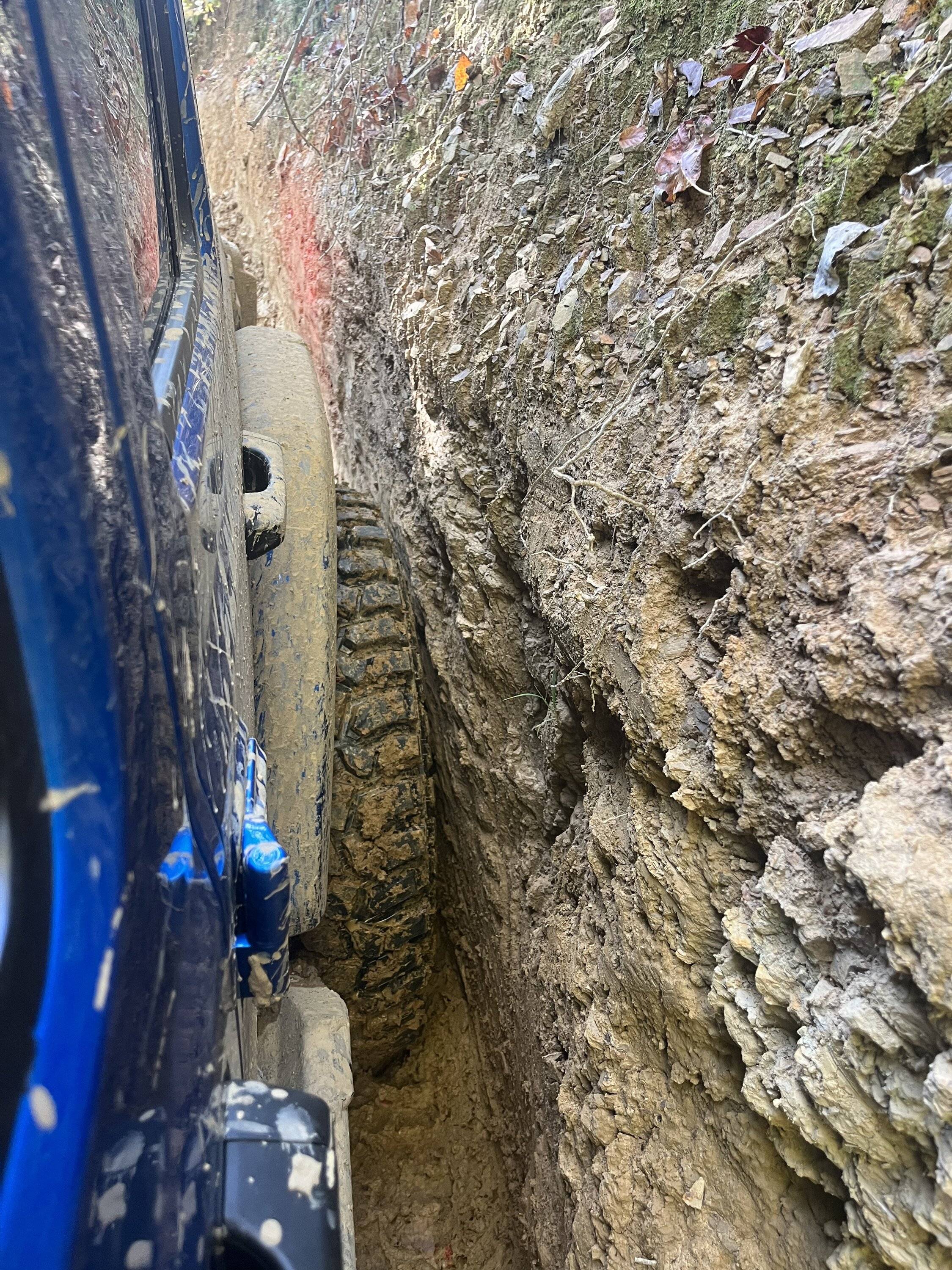

Well here on the east coast trails some poke helps keep the body/fender flares away from the vehicle height ruts that often develop on the trails. Was running 4.5” backspace with 37s and now I’m on 3.5” with 40s. I hit my fenders a lot less with the 3.5” backspace wheels.
For example…Trail 16 at Windrock:
Jeep Wrangler JL why do people like poke? 0FB1CA3A-AF96-42C7-82B3-E14A7CE55999
Jeep Wrangler JL why do people like poke? F6005FB2-88D0-46F2-86B0-5DAAE941EB35
Jeep Wrangler JL why do people like poke? 7B09EE4B-B01B-47EA-9E0B-A260B7A4CEE0
Jeep Wrangler JL why do people like poke? A5350818-C844-4B99-AE41-001D49CAF37A

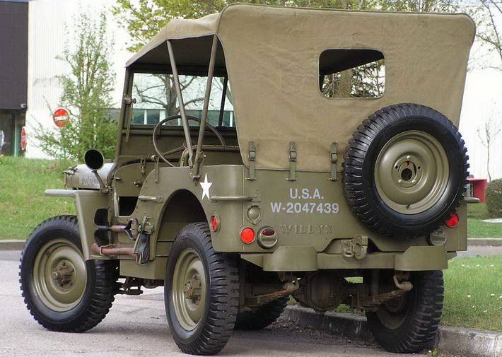

Interesting how it started with the tires under the body, and has steadily grown larger flares over time.
In relation to the body, the outside of the tire below is approximately where the inside of the tire is now...
Jeep Wrangler JL why do people like poke? willys-mb-6
