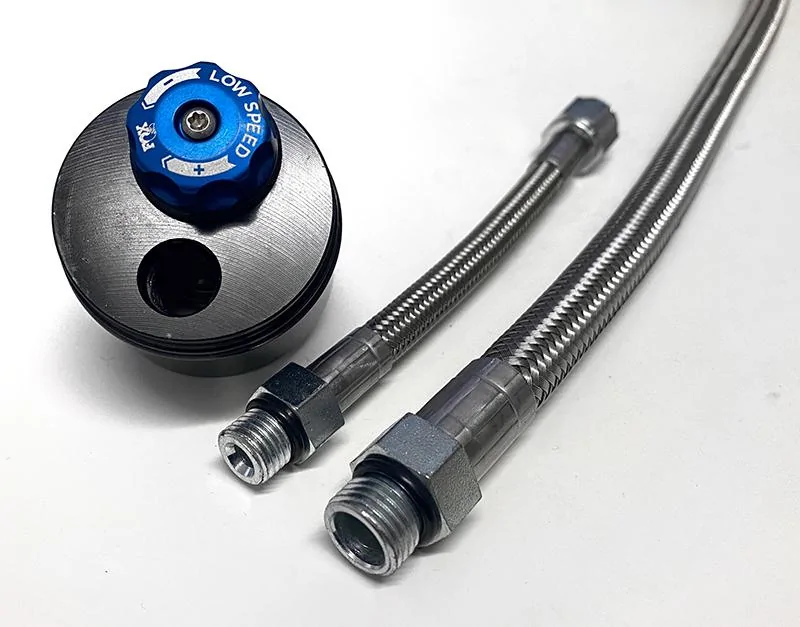

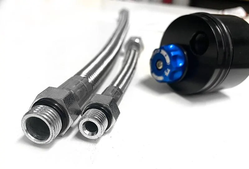

Upgrading a Fox 2.0 to have a LSC adjuster. For most shocks, yes this is an option and pretty straight forward. However, Fox and their JL specific 2.0 R/R shock... this is not currently an option. The JL shocks have a larger hose/fittings than a standard 2.0. The fitting simply is way too large and wont work. I went and snapped some photos to visually explain it a little better:
[images below] Fox 2.0 for the FRONT of a Jeep JL is the larger of the two hoses. The smaller hose is standard size for the 2.0 shocks, which is also used the the LSC shocks.
