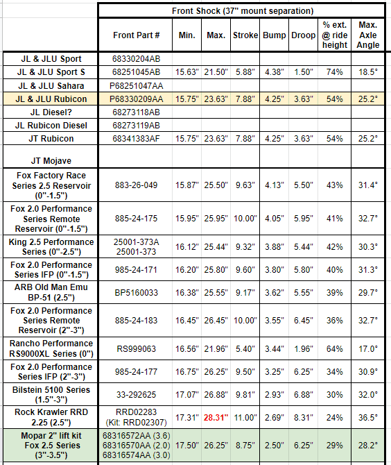

The OP has a Rubicon with no lift, which means that at ride height the front shock is about 20" long. The Mopar shocks would only have 2.5" of compression, which in my opinion is not enough.
Also the Rancho shocks are terrible when it comes to stroke length. The OEM Sport shocks should flex more than the Ranchos.

Unfortunately, I don't have any actual experience with any of these shocks (except for the OEM Rubicon). I'm trying to make sense of it all, and decided to compare it in a spreadsheet.
Here's some things I've learned from the forum/internet:
  • You want your ride height to be somewhere between 1/3 & 2/3 of the shock length
  • Minimum up-travel (a.k.a. bump) per Accutune:
    • Rock Crawling = 4”
    • Trail Riding = 5”
    • Desert Racing / Ultra4 Type = 7”
  • The OEM front driveshaft flange bends at about 26" of shock droop
  • A long enough 2.5" shock will contact the frame. I'm not sure of the maximum length for no contact, but 26" is OK and 30" is not.
  • Personally, I want the minimum bump stop possible so that you can achieve full stuff. Bump stops should be sized based on tire clearance at full stuff. The shocks should have a compressed length that doesn't bottom out before the bump stops, but not so short that there is wasted stroke.
  • The 'Max. Axle Angle' I've calculated is probably the best way to compare flex on paper. In reality, there are many things that could prevent this from happening.
Edit: One more thing... the rear shock travel is not 1:1 with the suspension due to the mounting angle (it's closer to 1.2:1).
