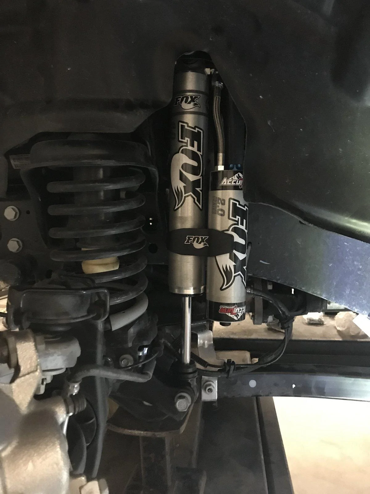

Is that coming from accutune? Heres the Jeep we did with them
brett
Brett,
With this front shock being in the piggyback configuration, it looks like you’ve used one of the 2.0 remote reservoir LSC adjustable shocks that Accutune has listed for use in the rear of a JL. Is that what you did? Did they tune them for the front? Any drawbacks to using a piggyback setup in front vs. the more typical remote (aka not piggyback) setup?
thanks!

Brett,
thanks!
I honestly can’t answer what exactly they were besides there was 2 for the front and two for the rear. They weren't interchangeable at all. Most if not all of the 2.0 Resi shocks we’ve installed we’re piggyback. Get into the 2.5 and they are remote. Space is limited in there and the 2.0 just fits.
brett
