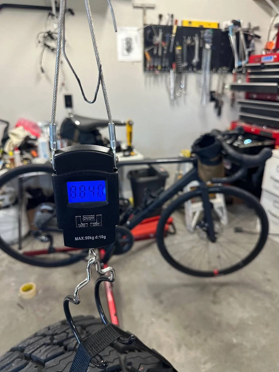

curious what 315/70-17 (not in an e rated tire) weighs 26 lbs more than the stock 285/70-17? stock is around 51-52lbs. I have an e rated 255/85-17 ie 35x10 and total weight of tire and wheel is just over the 85lb recommended rating..

I don't have a scale and didn't measure it personally, but just going by manufacturers' ratings, Tiresize.com says the 285 BFG KO2s are 50.2 pounds, and the 315 AT4Ws are 75.7 pounds. Again, just the weights of the tires themselves. I'm using the same (factory) rim, so the only differences would be the mass of the actual rubber, plus the difference in the mass of the air in the new bigger 315. Maths and physics make my head explode, so I don't know what that would come out to, but I doubt it's a huge difference.
