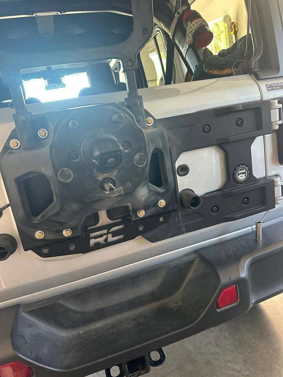

I have the mopar HD hinge and just added a $80 Rough Country relocation bracket..people bag on Rough country but it is a nice piece and made in the usa and super easy to mount and will allow a 37" tire..the jl hinge is stronger than the jk's were and with the HD hinge addition should be good.

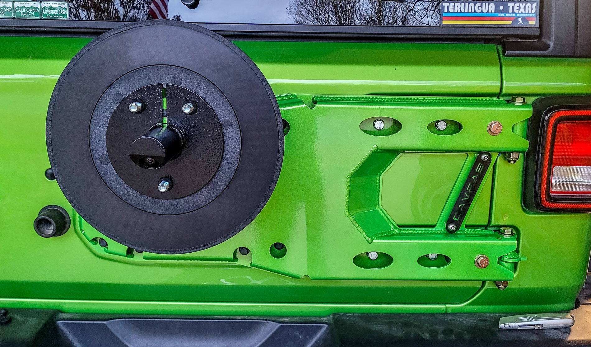

CavFab all day. Has a bracket for the 4XE speaker. I went from stock 33s on stock wheels to MT BB AT 35s on Method 0mm offset wheels and my tire is actually closer to the gate than the stock mount. I can swing on it for days. My bike rack still works without mods. The carrier comes raw metal. Spend $100 on some Steel-It rattle can paint and do a half-way decent job and it will look great. The CavFab bumper in the pictures is DIY black Steel-It. I had the carrier powder coated to match the Jeep.
