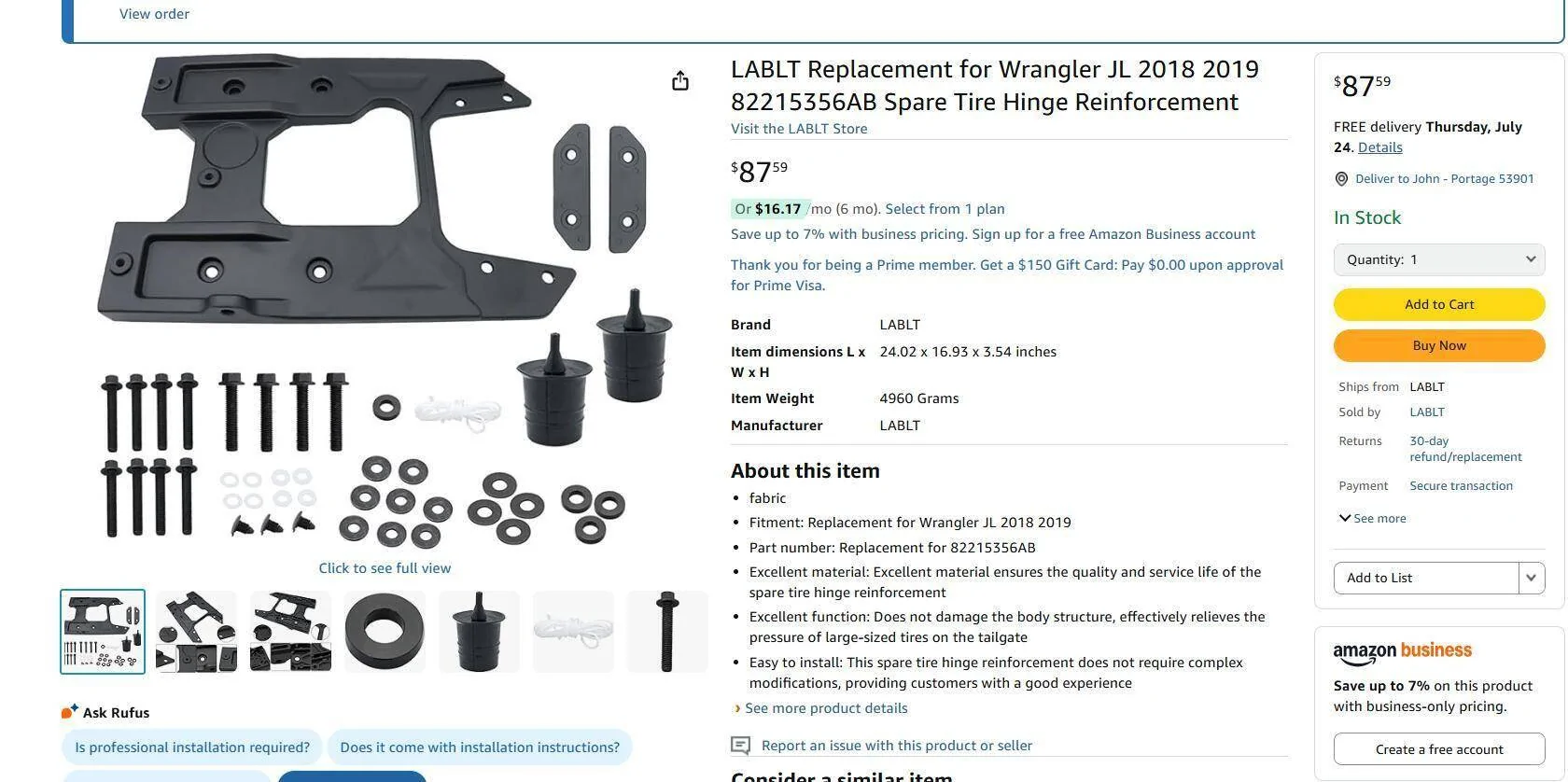

This is identical to the Mopar reinforcement.
I just put one on my 2021 2 door willys.

I put on one of the knockoffs shown in a post above and the photo below. My 35"x11.50 Toyos fit perfectly. I haven't noticed any flex. I deleted the factory 3rd brake light and installed a "Ring of fire" under the spare. There was a post in this Jeep forum that influenced me to make this change. One of the recommendations in that post was to replace the vendor supplied hardware with higher quality bolts.
Alternative To Mopar Tailgate Reinforcement | Jeep Wrangler Forums (JL / JLU) -- Rubicon, 4xe, 392, Sahara, Sport - JLwranglerforums.com
