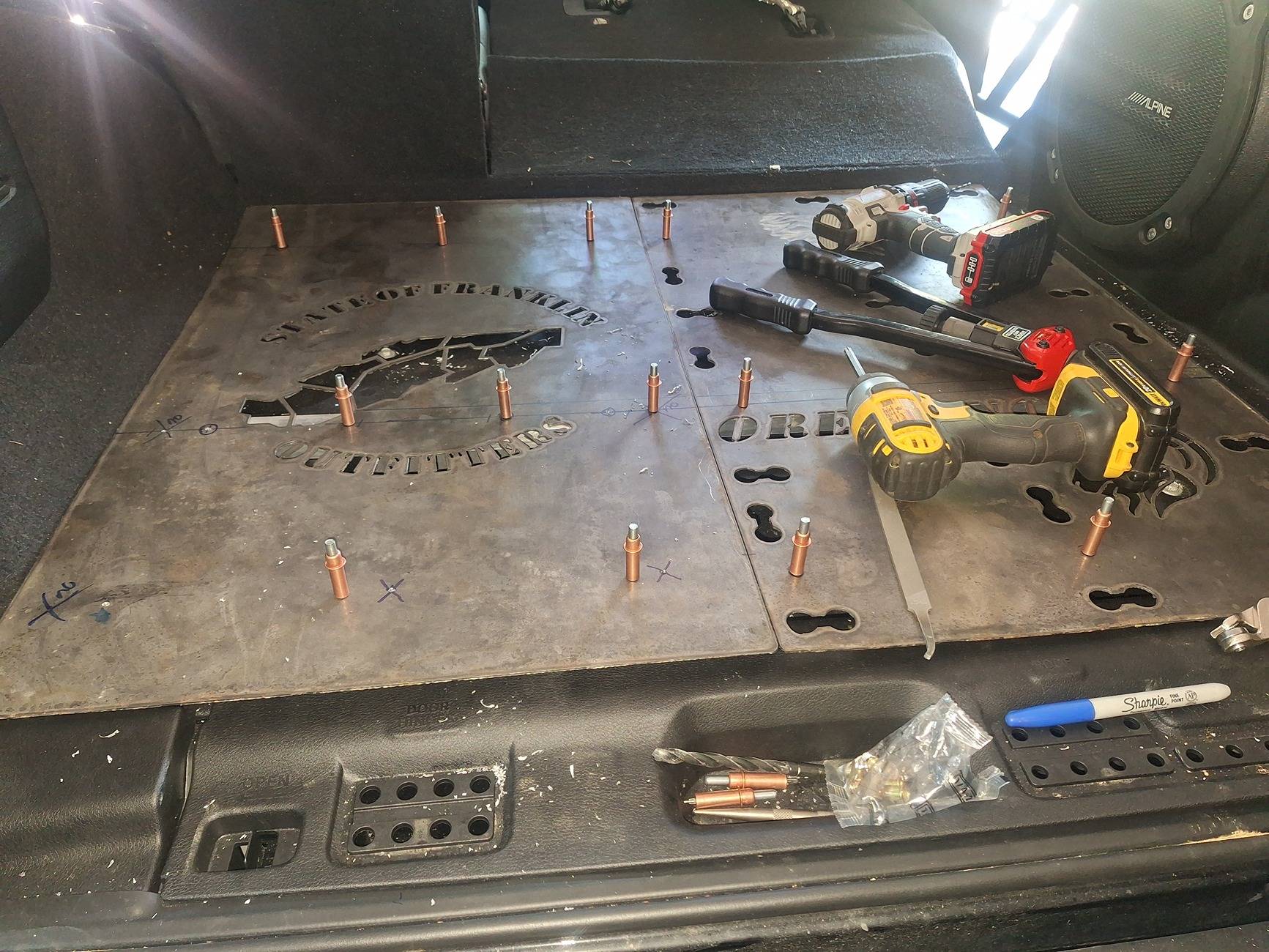

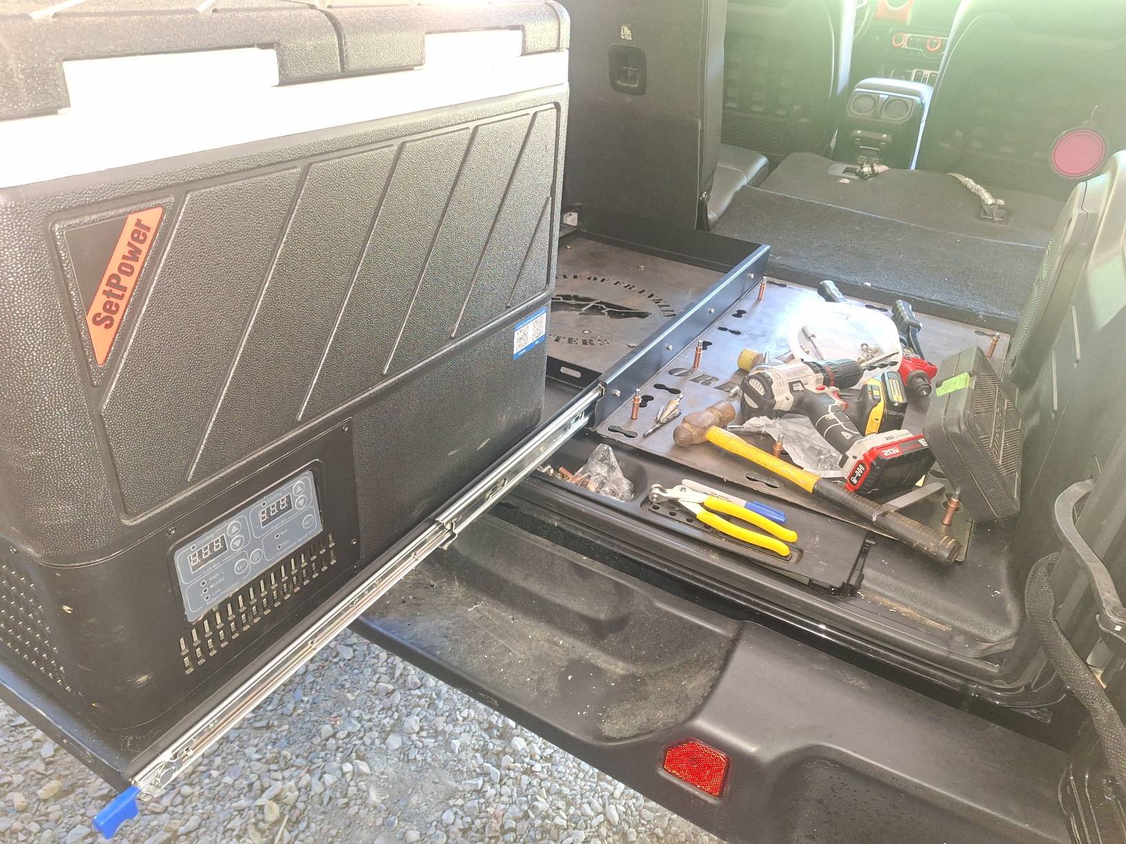

3 main rails, cut drilled and mounted, both panels are pre-drilled.
Lots of clearance holes to drill and nut zerts to be installed.
Then deburr and paint after mounting freezer...

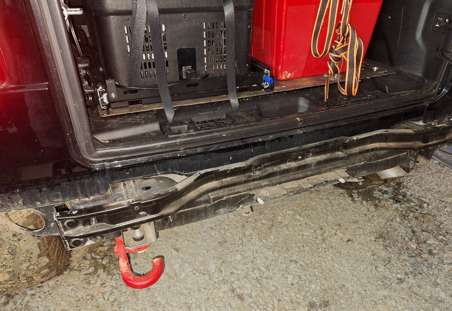

Well, the back bumper ended up in the corner, what a PC of shit!
Well, apparently us east of the Mississippi folks wheel harder in our backyards than the west coast Rubicon junkies 😛
So, I bent/tore/ripped the pos shit into a parrellagram s/p? At a 30* angle backwards.
So, need to put a bumper on now.
J/k and poking fun fun, but really jeep? 25 pcs of plastic for a rear bumper on a vehicle capable of traversing the most famous trail....🙄

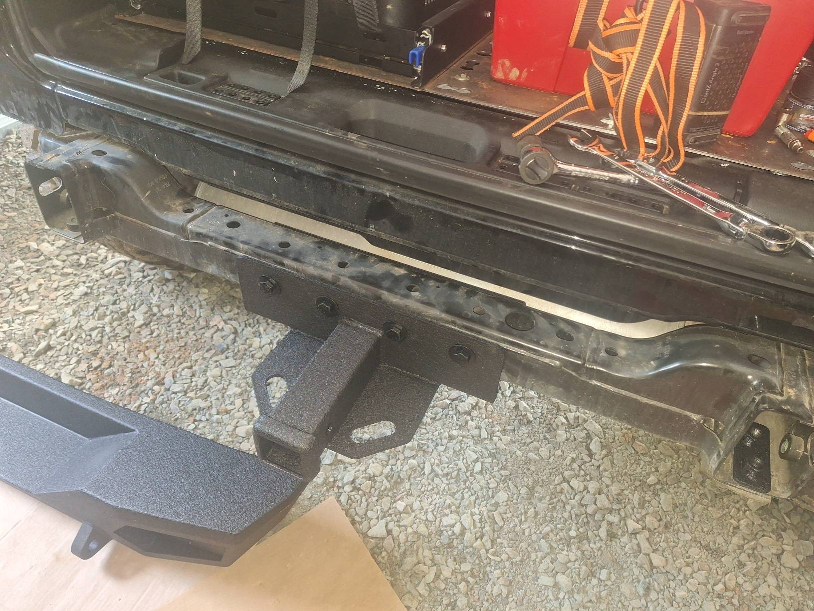

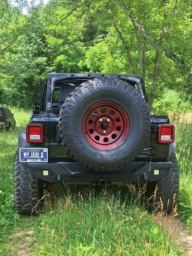

Got up and put a hitch/bumper on.
Jeep Wrangler JL My JAALA...Lets get back into wheeling...mama is back on board...so its a couples thread/journey now... 20250627_113650
1st hitch with backing plate, then mounted up thr bumper. I pushed everything up so bolts stopped and pulled back so interia won't have help shearing off bolts.
It's tucked up nice and tight.
Jeep Wrangler JL My JAALA...Lets get back into wheeling...mama is back on board...so its a couples thread/journey now... 20250627_114854
Jeep Wrangler JL My JAALA...Lets get back into wheeling...mama is back on board...so its a couples thread/journey now... 20250627_114845

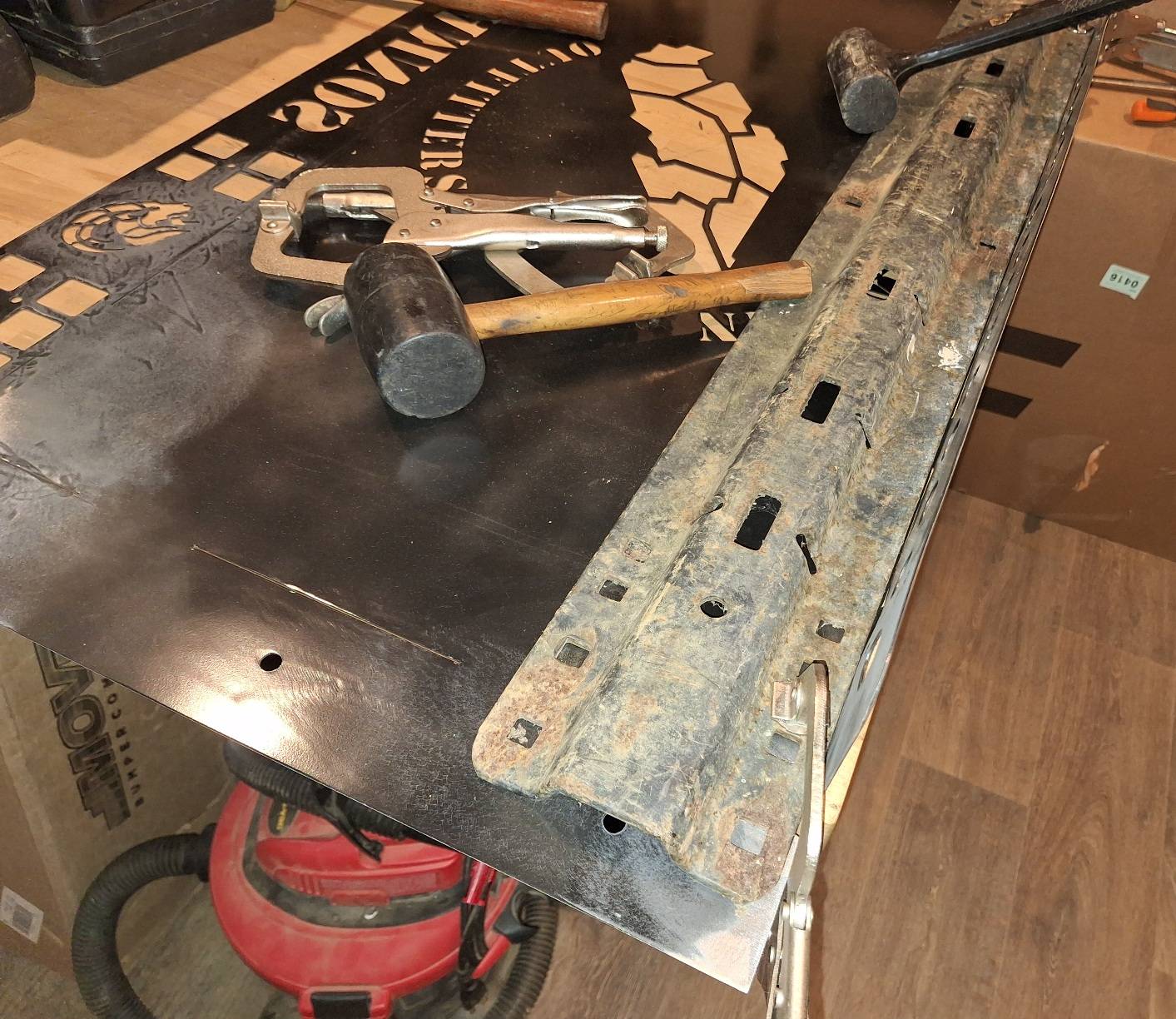

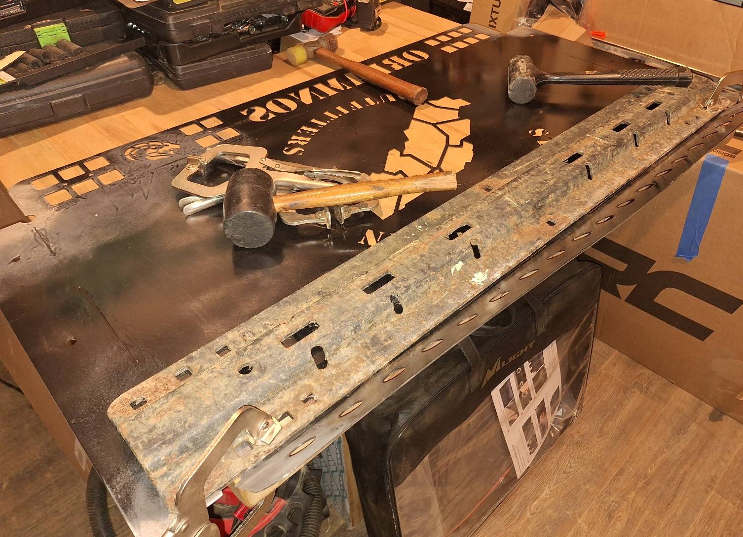

Taking a beer break to do some dishes, I knocked the slag off 1 side of rack. Will sand and the bend and weld, hopefully today.
Jeep Wrangler JL My JAALA...Lets get back into wheeling...mama is back on board...so its a couples thread/journey now... 20250627_134010

Well today is or was last night, lol.
Started the bending process.
Jeep Wrangler JL My JAALA...Lets get back into wheeling...mama is back on board...so its a couples thread/journey now... 20250627_183916
Jeep Wrangler JL My JAALA...Lets get back into wheeling...mama is back on board...so its a couples thread/journey now... 20250627_184022
Jeep Wrangler JL My JAALA...Lets get back into wheeling...mama is back on board...so its a couples thread/journey now... 20250627_184648
More to bend and straighten out. It got to late last night to be banging on sheet metal lol

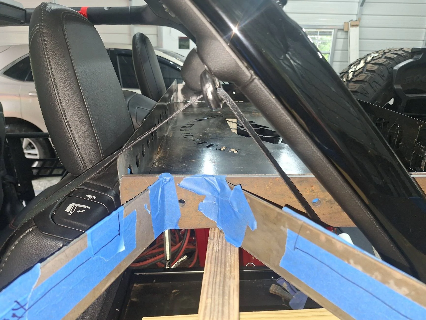

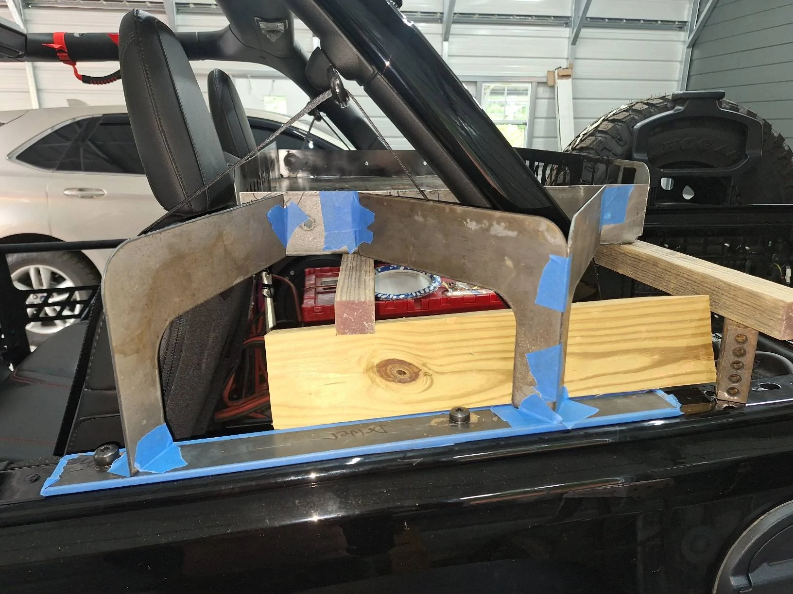

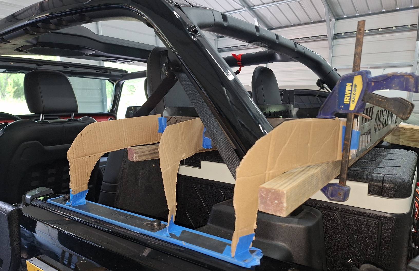

Continued work on rack today, lots of small details
Jeep Wrangler JL My JAALA...Lets get back into wheeling...mama is back on board...so its a couples thread/journey now... 20250629_163208

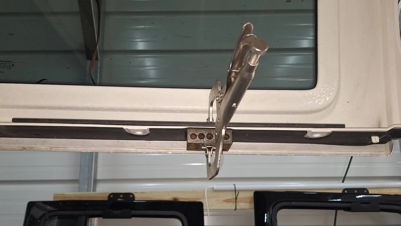

Made 2 mounts for the top rail/cap/top bolt down .
Used some A36 1/4 x 2.0 I had, clamped the metal to the top cap rail area to mimic it being mounted and traced the holes with a sharpie
Jeep Wrangler JL My JAALA...Lets get back into wheeling...mama is back on board...so its a couples thread/journey now... 20250629_164207
drilled out to size
Jeep Wrangler JL My JAALA...Lets get back into wheeling...mama is back on board...so its a couples thread/journey now... 20250629_165530
Taped and mounted
Jeep Wrangler JL My JAALA...Lets get back into wheeling...mama is back on board...so its a couples thread/journey now... 20250629_171308

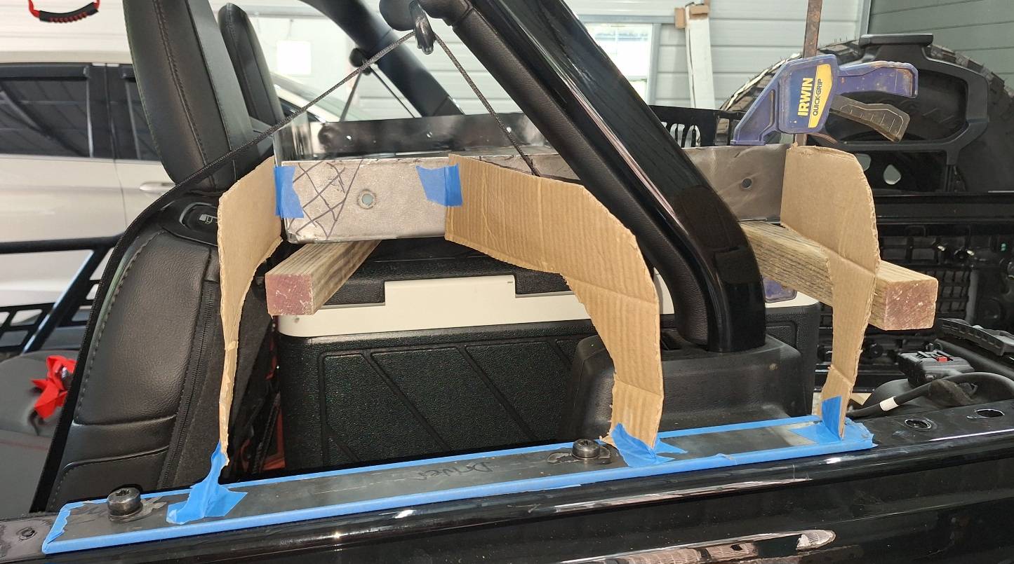

I then grabbed a beer and started on bracing and mounts
Jeep Wrangler JL My JAALA...Lets get back into wheeling...mama is back on board...so its a couples thread/journey now... 20250629_181040
Jeep Wrangler JL My JAALA...Lets get back into wheeling...mama is back on board...so its a couples thread/journey now... 20250629_181027
Now remember these are cut out of very damp cardboard, they will mor square and several other items need to be mounted.

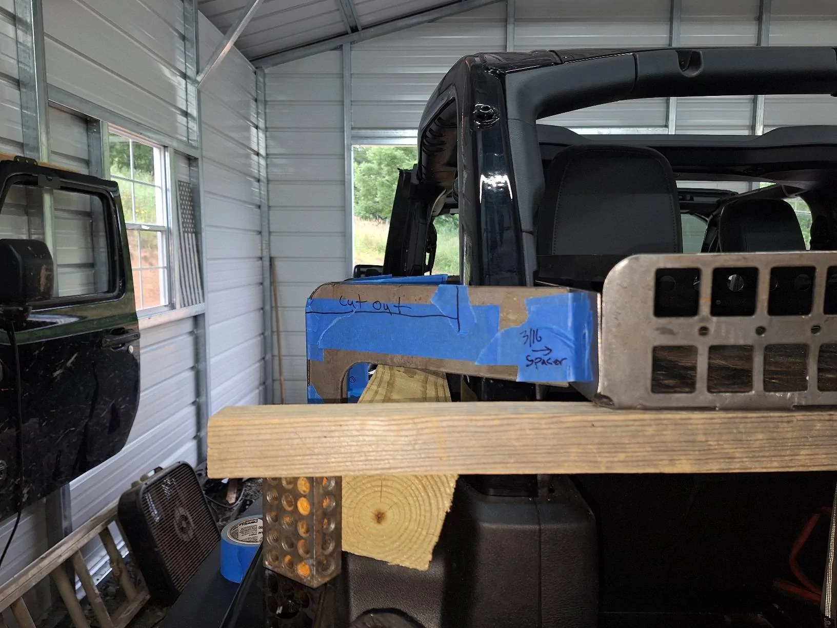

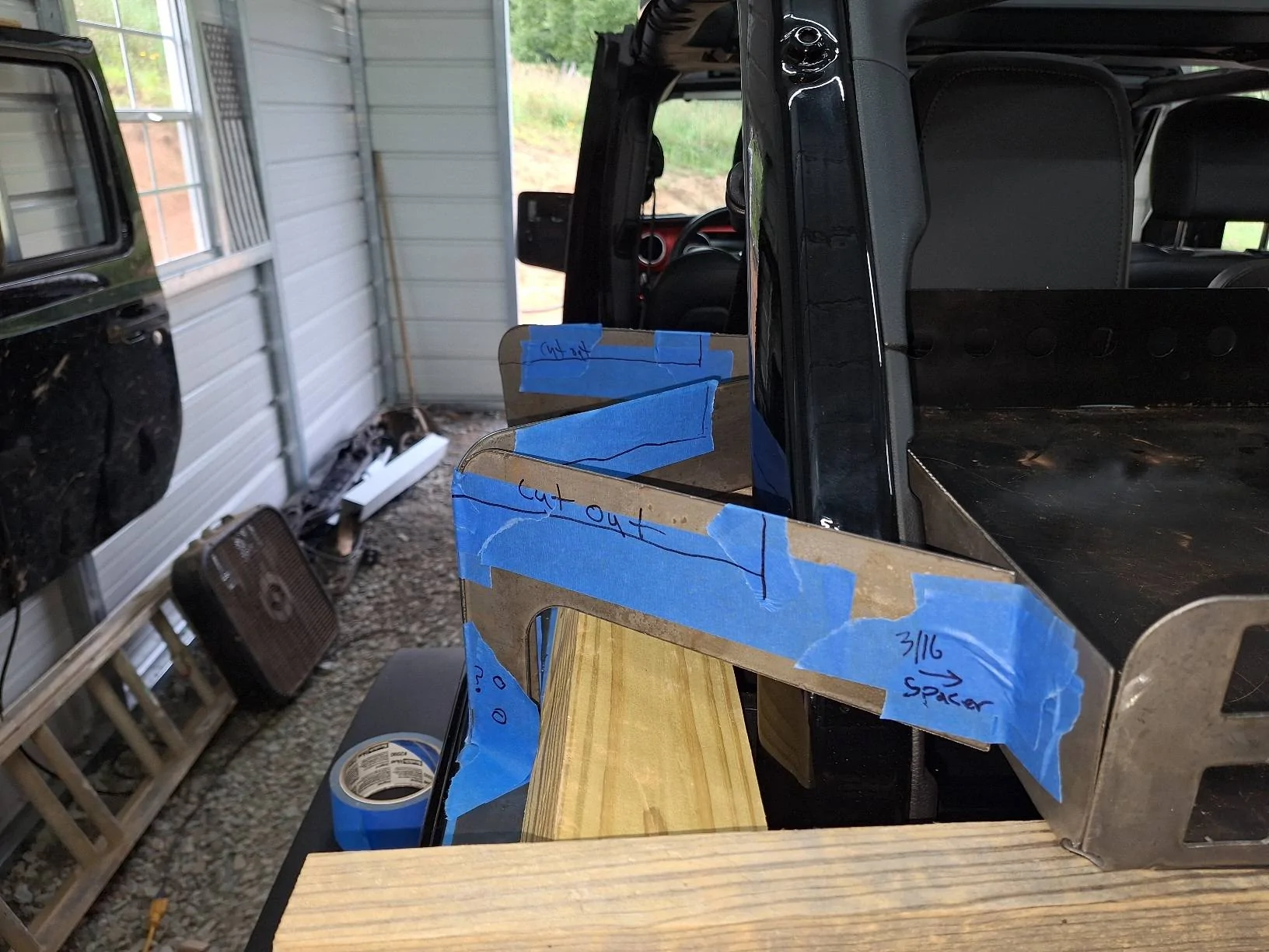

Made a spacer/mount for driver side.
Now to work on passenger side.
I will need to cut it so it can be removed.
Jeep Wrangler JL My JAALA...Lets get back into wheeling...mama is back on board...so its a couples thread/journey now... 20250701_192541
Jeep Wrangler JL My JAALA...Lets get back into wheeling...mama is back on board...so its a couples thread/journey now... 20250701_193015
Jeep Wrangler JL My JAALA...Lets get back into wheeling...mama is back on board...so its a couples thread/journey now... 20250701_193036
