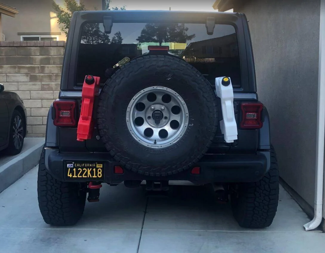

Heavy wheel, 35" tire, fuel and water put me at about 160lbs on my stock JL gate and hinges. I drove it like this for over a year on a lot of off-road trails and never had an issue with the gate or hinges getting "sloppy", sagging, etc.
Jeep Wrangler JL Which tailgate reinforcement kit and tire relocation kit? 1752762053608-el
@Jeeperz Kreeperz this is what the 3rd brake light looks like when adjusted for a 35" tire on the stock carrier.
