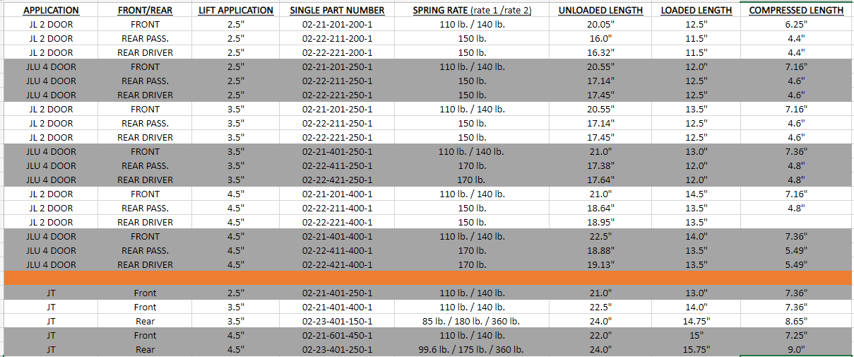

I'll bite...How do your spring rates compare to those used on the MetalCloak Gamechanger?
Secondly, from your website, it appears the Teraflex kits only provide a single spring rate for everything from a Sport to the 4xe. Do you offer more than one spring rate?

Ah this is a good question. At the exact moment, we only offer "normal" coil springs, if that makes sense. We do have "HD" style coil springs just about to be released, which do have a higher coil rate over what we're currently offering. These HD springs will be packaged into application specific kits for 4Xe, 392, etc. We're hoping to have them out by EJS (easter jeep safari) this year. I don't have the full spec chart for the new upcoming HD springs, but here's the full spec sheet for our current coils.
That's because in the Jeep world a lot (not all) of suspension lift companies are outsourcing their coils from one or two manufacturers. They don't want to release spring rates because with a little research you can find out where that coil spring came from. It's a dog eat dog world out there.
This is pretty spot on. However, there's not much stopping companies from retail buying our springs and putting them on a spring tester to find out most of the specs. However, with that being said, we are okay with people knowing the specs if it helps them better find the best spring option for their Jeep. Our springs are made in California for reference.

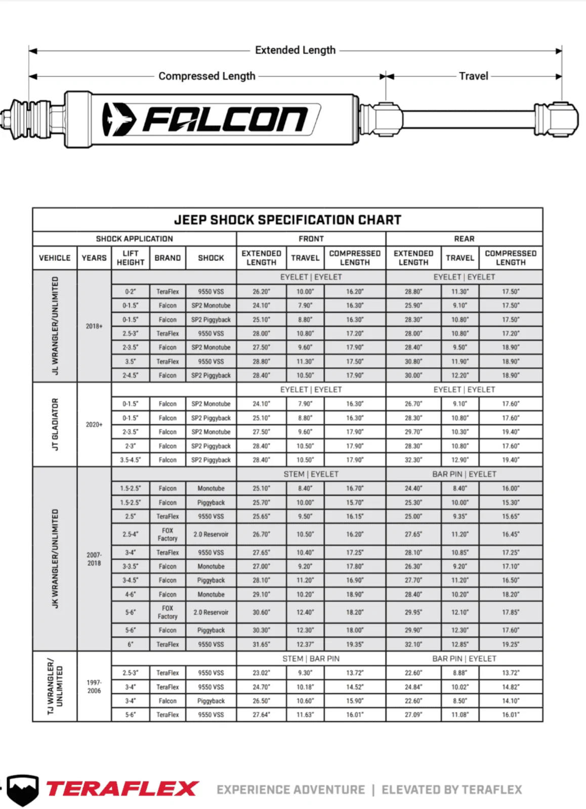

I've read that the factory 2-door has higher font spring rates than a 4-door, due to the shorter wheelbase, ride frequency, and probably being designed for "flat ride". It appears that this wasn't addressed here. Was that a conscious design choice for off road purposes or just the typical 2-door afterthought?
Also why does your website not clearly list the compresses & extended shock lengths? Same question for shock extensions.

We don't list the shock lengths because there is so many variables and different shock options. We don't want to cloud up and confuse customers with an already wide range of offerings and related info. Over the years we have made changes to our shock lineup such as the SP2 Mode Adjust and other tweaks that have changed the extended/compressed data, which further complicates the situation. By no means do we try to keep that info secret, and if those numbers are wanted a quick call to our customer service team can get you those current numbers. That being said, this is the most up to date chart we have excluding the recent SP2 update to the JK shock lineup.

We found during our own testing with 2 vs 4 door spring rates both on vehicle(s) and on our spring tester that there was little to no difference in the factory spring rates between 2 to 4 door front springs. Less than 5 lb per spring for reference.
Our spring rates up front are almost identical to that of the stock 2 Door JL. We felt the stock JLU springs up front were too soft and unpredictable.
Not sure who I believe... but I've felt that the JLUR springs on the front of my JLR were softer...
Also, since our springs are a higher lb rate than factory, it made the "needed" difference even less.
JLU Sport - 114/121 Front 171/174 Rear
JLU Rubicon - 123/128 Front 172/176 Rear
Mopar 2" Coils Lift - 131/133 Front 180/182 Rear
With TaraFlex's 110 #/inch front ride rate & 150 #/inch rear... Again, I'm not sure who I believe here.
As a result, it made more sense as a manufacturer to produce 2/4 door front springs at the same lb rate.
Why? They're already unique springs for the 2-door.
140 is ride rate. 110 is the extended part on top for extension during droop. The 2 door rears are less at 150 vs 170 on JLU.
