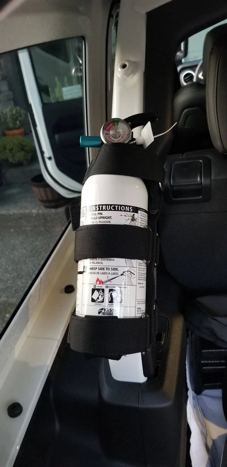

Fire Extinguisher and Roll Bar Mount:
Maybe this is not necessary given high quality of wiring in a new JEEP. I hope I will never need to use it. White extinguisher with blue nozzle may have been the deciding factor for this purchase.

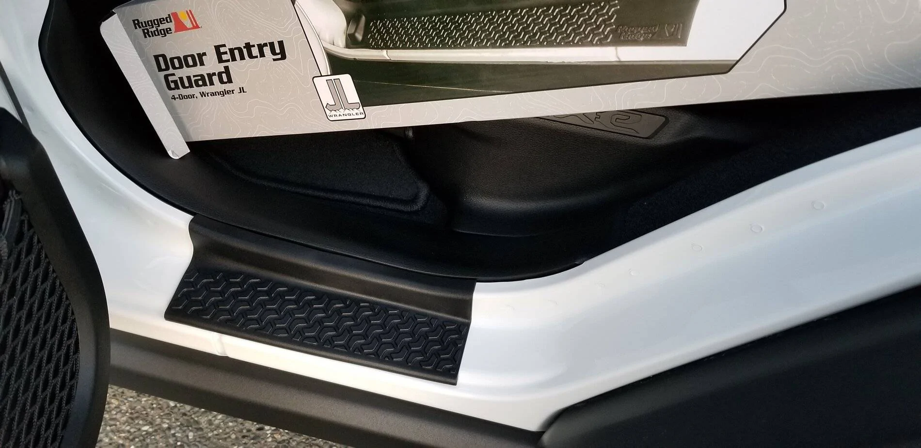

Rugged Ridge Scuff Plates:
These covered more area than the Mopar units and I like the black color to continue with my black/white/blue color scheme. These were extremely easy to install, but the rear units were hard to tell right from left. Rear fit was only OK which contributed to my installation confusion.

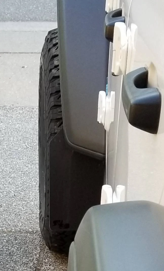

Rokblokz mudflaps:
I did not want mudflaps, but, after seeing the amount of damage to my rear fenders and door hinges, I felt this was the fastest way to gain protection - especially if I add wider tires & wheels later.
Image shows mud flap with 37x12.5 tire. $169

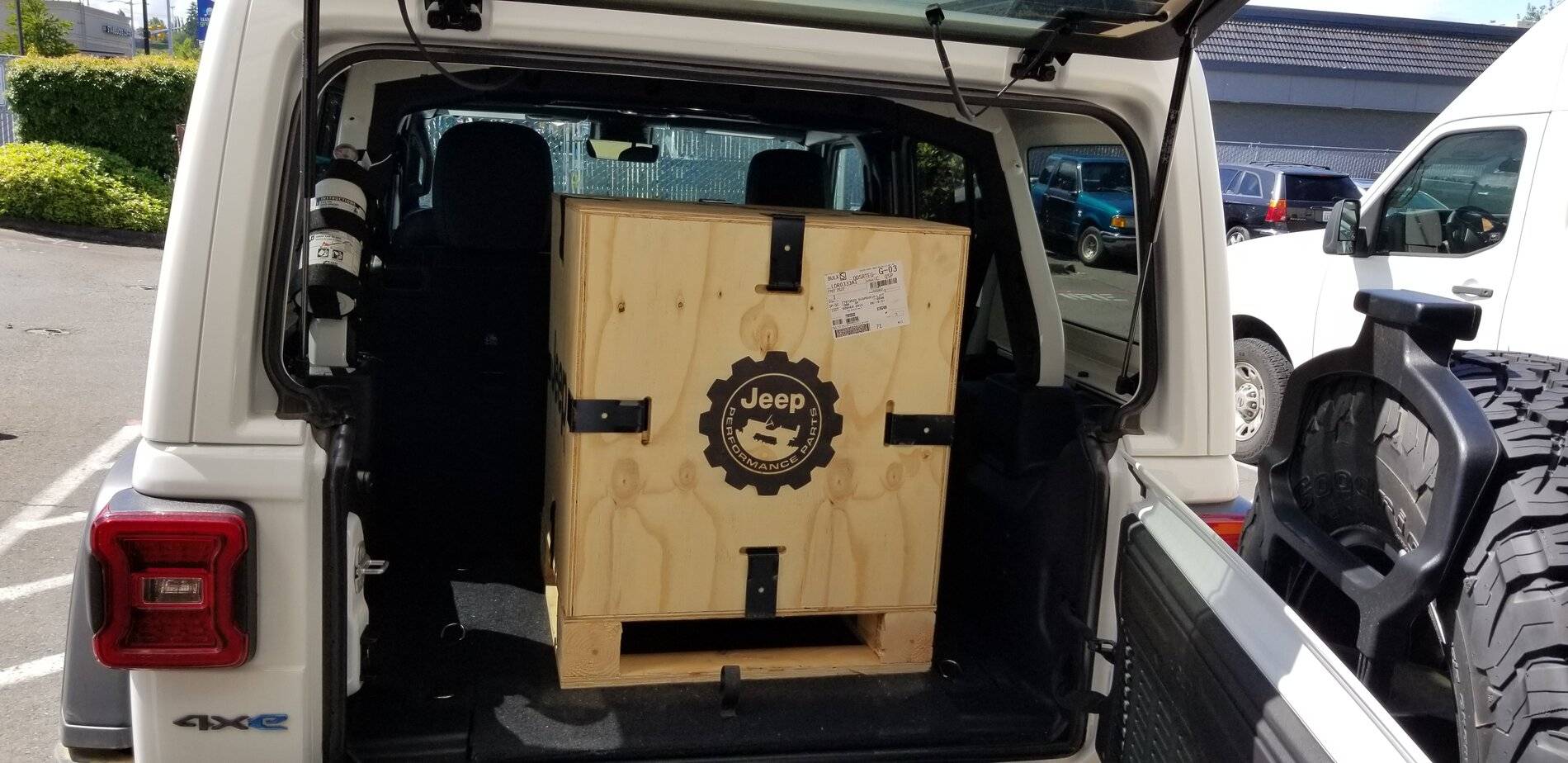

MOPAR Lift, p/n 77072522: (corrected p/n)
This is now available through Jeep Parts departments with an MSRP of $1495. Many dealerships will offer a discount just for asking; I paid $1270 before tax. Yet to be installed...and, yes, the crate easily fits in the back. $1399.

MOPAR Lift, p/n 7772522:

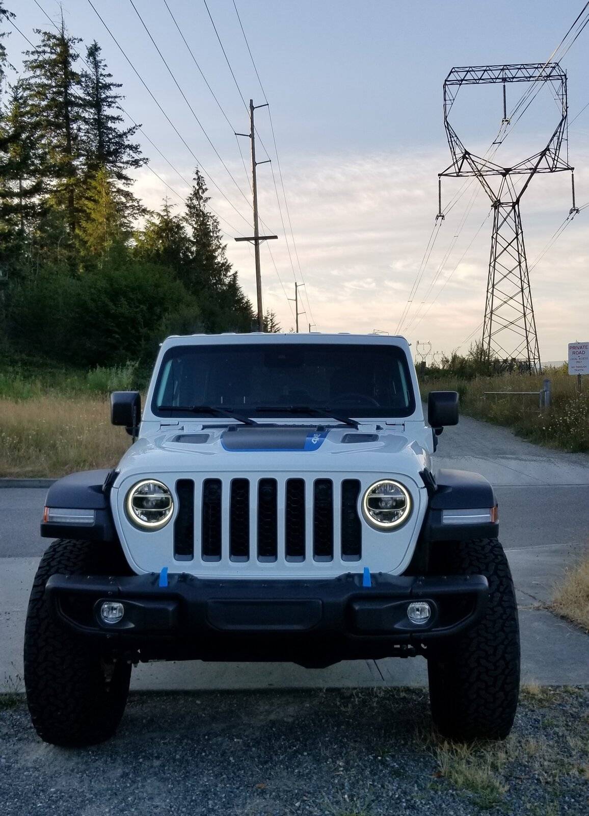

It's been a while since I updated this thread.
I installed the Mopar lift and re-installed the 37" KO2's on July5. Note to self: don't try to loosen any flag nuts. :facepalm: Thanks to forum members Roky & Hoag4147 by quickly answering my plea for help on July 4 & pointing out my careless mistake. This forum is awesome. Every time I learn
Also -triple checking all loosened hardware is a good idea. Somehow I left the rear, upper shock bolt loose and the shock produced an audible "clunk" on every bump. I don't have directional hearing, one ear is just for decoration, so I had my partner take a short ride with me. She was able to pinpoint the direction which gave me a clue where to look for loose bolts.
The next issue from the lift was a slightly off-center steering wheel which required a little adjustment of the drag link to re-center. Funny, but I also noticed the Automatic Cruise Control wouldn't work. The Jeep gave me an odd error, something like, " ACC not available when traction control disabled". Anyway, re-centering the steering wheel fixed that issue as well.
I've driven about 500miles since the lift and really like how it rides and drives.

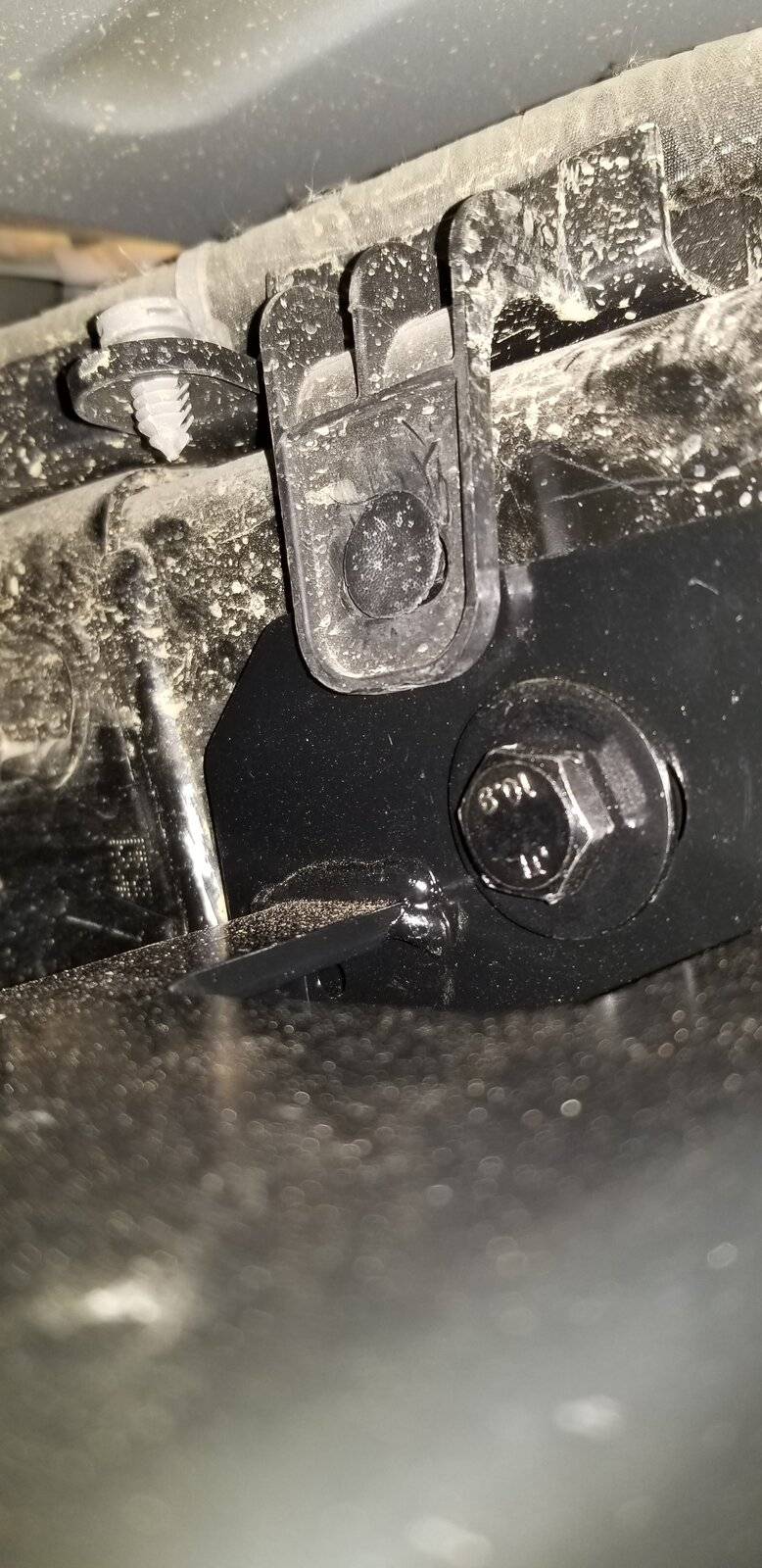

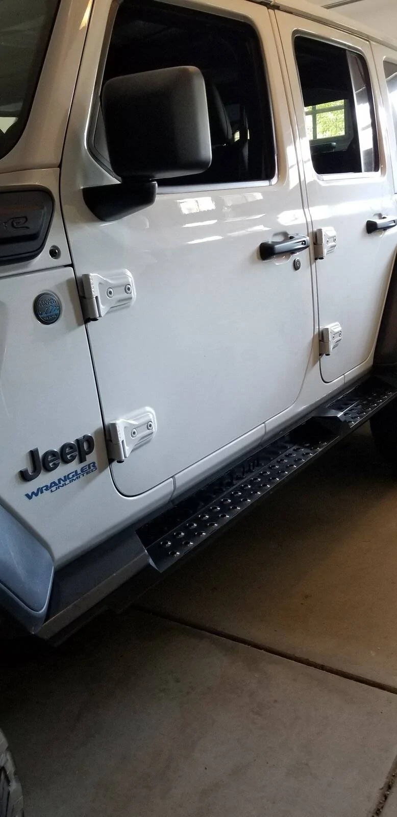

After five failed attemps, I have finally, successfully climbed up Mt. Rainier. This has freed up some time for me work on my Jeep, rather than training. So on July 24, I re-torqued all the suspension bolts I touched while installing the lift, and then began installing the Roam rock sliders that I've had since Jan (I've had the 4xe since May).

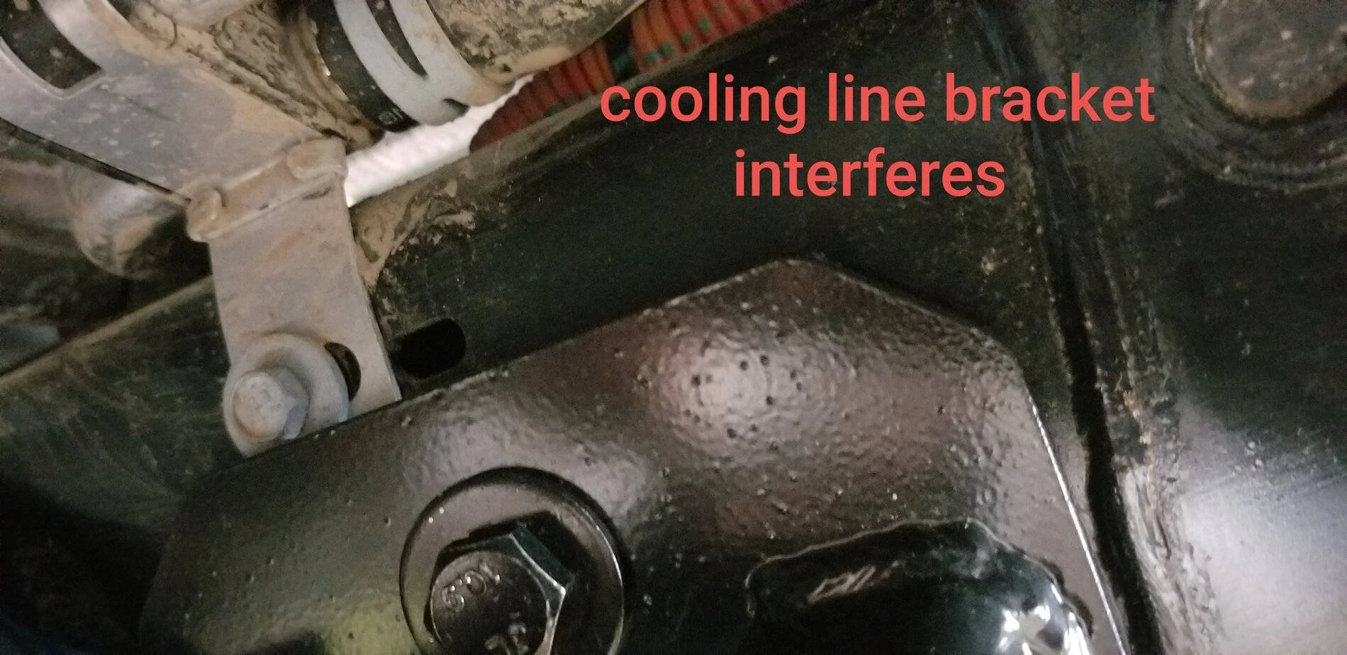

I've seen two others post about the Roam sliders. One stated they did not fit; the other said they fit, but required modifications to the slider mounting brackets...or not using 1 of 4 brackets on each side. Given low expectations, I began the installation and found it quite straight forward. There was one minor issue per side with features unique to the 4xe's cooling & electrical lines.
On the driver's side, the bolt and lower edge of a metal bracket for the battery cooling lines interferes with the number 3 slider mounting bracket (all slider mounting brackets have holes drilled in them indicating their mounting position). I lifted the edge of the cooling line bracket and bolted it down on top of the slider mounting bracket.
Jeep Wrangler JL White JLURe Build Journal 20210724_174452
On the passenger side's 3rd mounting bracket, a plastic bracket and pin which hold the electrical cables interfered with the slider mounting bracket. Similar to the driver's side, I simply lifted the plastic bracket, bolted the slider bracket in place, then reinstalled the plastic bracket on top of the slider bracket.

The end result looks pretty good, should definitely help my shorter passengers with ingress & egress while providing rock protection.
I still need to install the lights and then the lower, "boat side" panels which provide a smooth sliding surface.

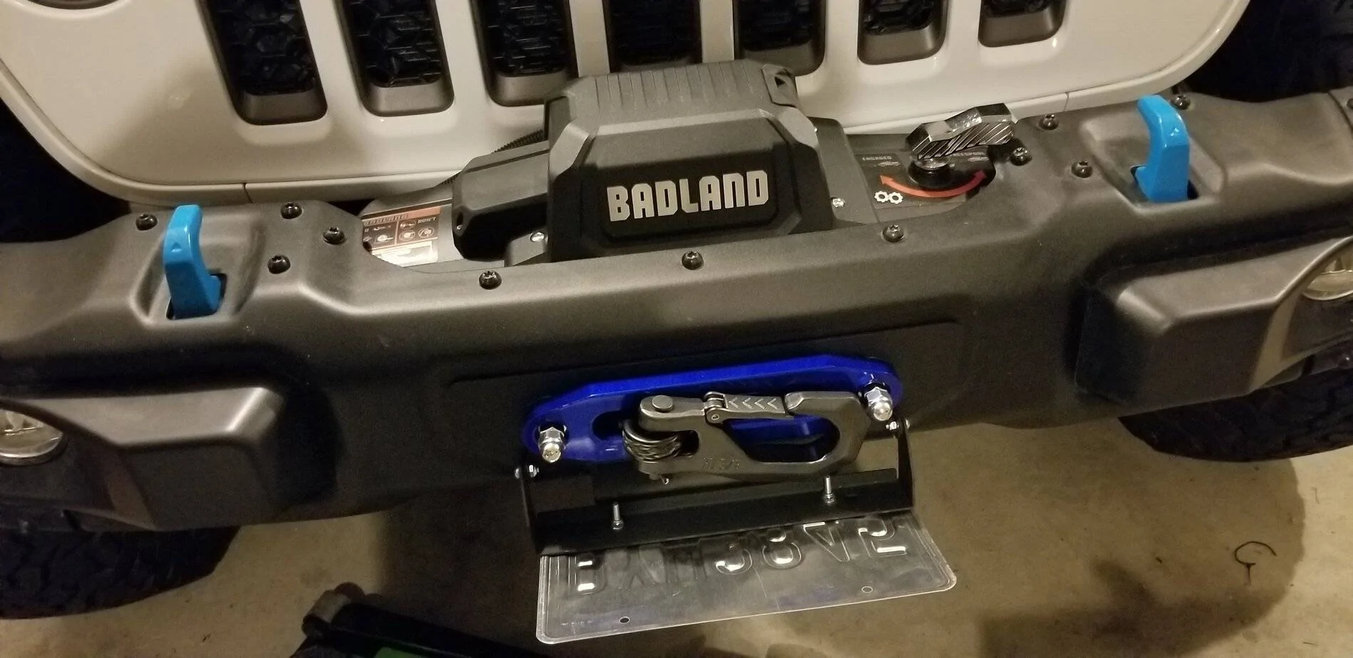

Back in early August, I installed the Warn winch mounting plated & Badlands winch.
Two tricky parts of the installation were the need for some spacers under the winch to allow clearance for the engaged/freewheel lever and a need to loosen both sets of bumper mounting brackets to allow alignment of the bumper bolts. It took me a full day, including hacking & spray painting the 1/8", predrilled metal straps used for spacers & a quick trip to Home Depot for some longer, grade 8 fairlead bolts.
Painted spacers doubled up. Longer grade 10 bolts pass through these into the winch (the bolts which come with the kit are too short).
Jeep Wrangler JL White JLURe Build Journal 20210814_180233
Finished installation including a blue fairlead & rotating front license plate bracket. The fairlead's blue doesn't match the tow hooks, but I prefer its color to the baby blue hooks, anyway.
One forum member commented that the bracket should pivot from the top, but it seems to me that would be more likely to interfere with the rope than the position below. Maybe I'm missing something?

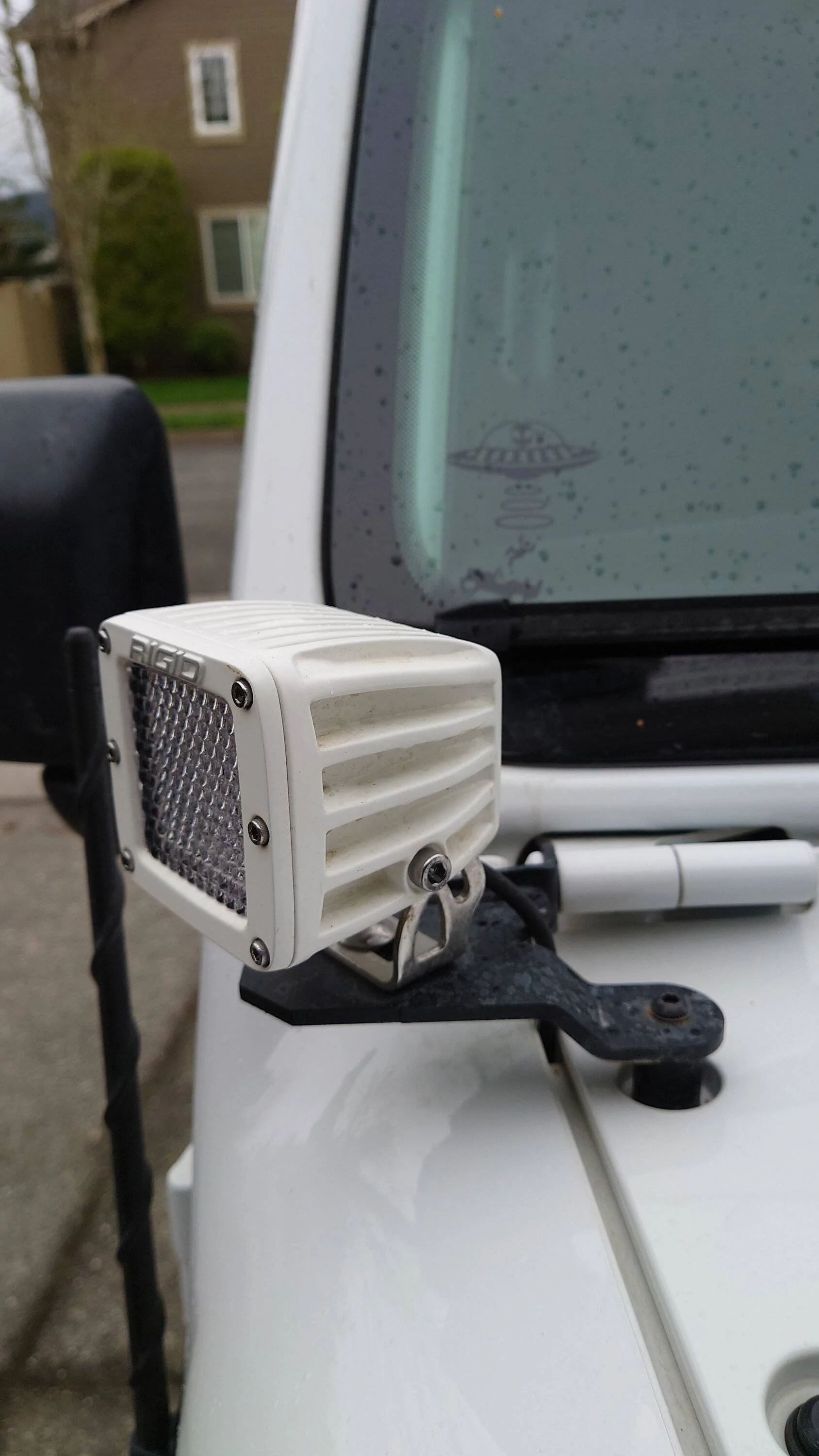

While trail running late last Fall, I found I really needed some extra lighting toward the sides of my Jeep in order to illuminate intersecting trails & camp spots. I added a pair of Rigid brand, white, D series lights ($220 from Northridge.com) on KC A-pillar light brackets ($72.24 also from Northridge). The lights are aimed about 45deg from the front and cover a very wide swath close to my Jeep. Exactly what I was hoping for.
