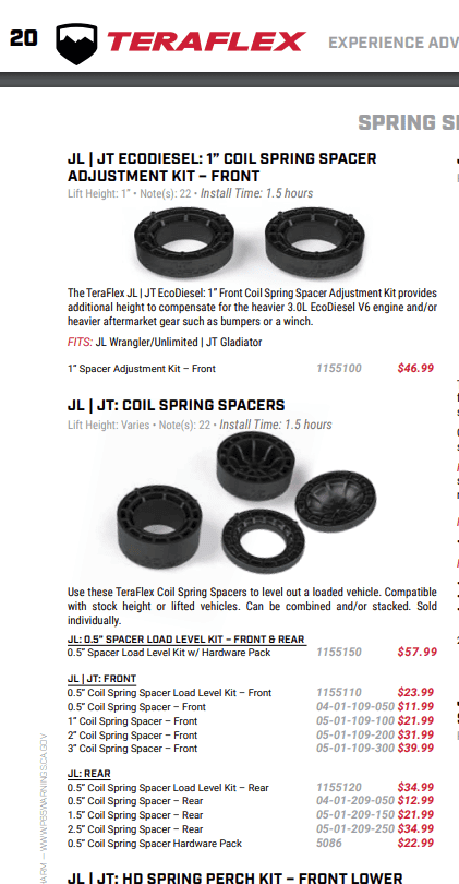

On your last question, we do most of our spacers listed in pairs, for example kit #1155150 for a pair of 0.5 front spacers, kit #1155110 for a pair of front 1 inch spacers, etc. There's a few of the rear spacers that are not listed, but they can be bought in pairs or individually if wanted, you'd just want to reach out to us direct or to one of our dealers/vendors.
Let me restate: there are no 1.5" front or 1" rear spacers available individually or as part of a set. There should be.

I have a question for you @TeraFlex
as part of my frankenlift I used your suspension spacers. Specifically 1inch front and rear. I did this by buying 0.5inch spacers for front and rear and then I stacked them. Did I mess up? should I replace them with 1inch version instead?
I had a really hard time finding 1inch front and 1inch rear as a set. And I think I found 1inch for either the front or rear, but buying the 0.5inch sets came out cheaper.

By no means have you messed up or done anything wrong. Our spacers are intended to be stackable, so no worries at all. The only advice I'd give is to not stack the spacers over 3 tall.
