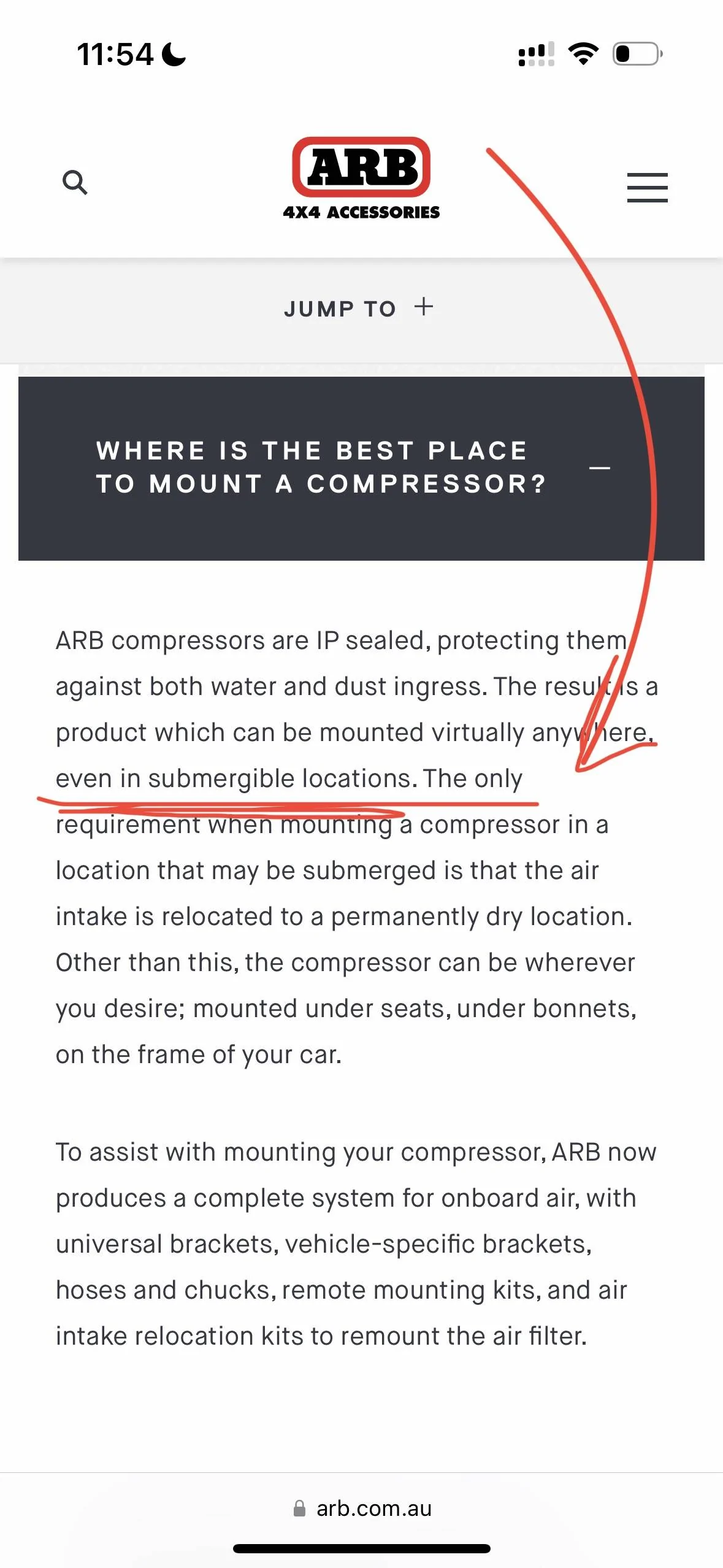

Apparently you need to read more on their site instead of just looking at pictures-
Jeep Wrangler JL Taillight air compressor install 810DCBA8-CF69-482E-B7D9-B6D9A1A6F850
https://www.arb.com.au/assets/air-lockers/3-05.pdf

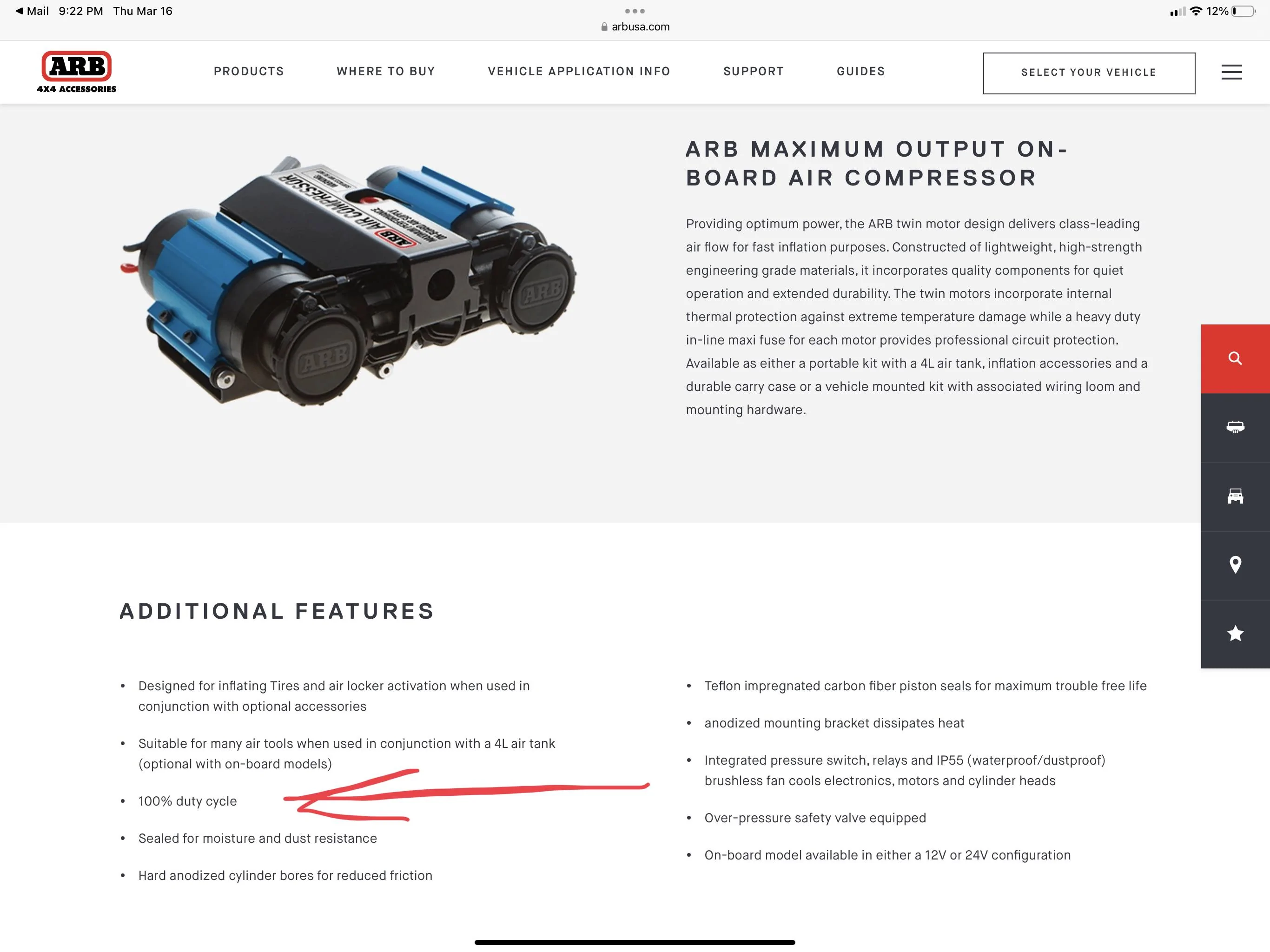

These are two air cooled 50% air cooled compressors. If ARB wants to call the Twin 100% in marketing materials and you want to believe that then go ahead.
My mom has Alzheimer's and we are driving down to spend time with her Saturday. Thanks for that....
I have opinion with rational arguments. If you have a problem with that or something else and need to vent then go somewhere else.
By halving the load of each of them it will increase their duty cycle. ARB is known as a company who has been very thorough in their testing. So yeah, I will believe them.
