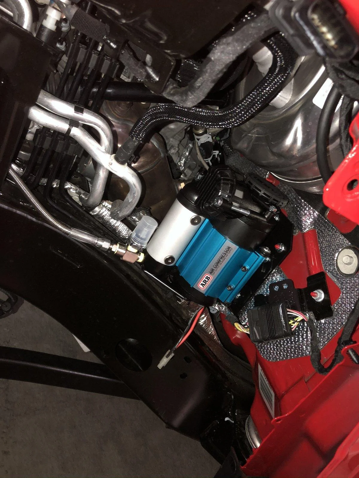

Here’s how the aforementioned ACM mount by Eddie looks after mounted. Driver side fender has to come off for install. Wheel removal is not necessary. Also an extension is not needed as you are able to reach in behind the fender and plug in your hose.
