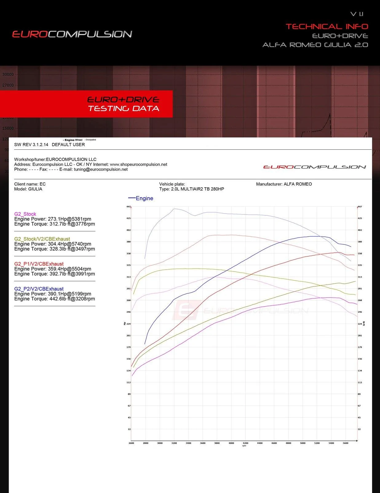

Nothing substantial? The euro tuner guys are pushing 395hp and 443lb/ft from the same engine with just a tune. 130hp and 148lb/ft isn't substantial? 50% more horsepower and torque is pretty damn substantial. If only someone would figure out how to let us tune this jeep. New ecu, patch cable, whatever to be pushing 5.7L hemi numbers without the hassle of a hemi swap would be well worth a few thousand dollars.

Which part do you find amusing? Show me one factory turbo vehicle ever made that can't gain at least 100hp from an aftermarket tune? This engine is used in the alfa romeo stelvio. There are documented, dyno proven cases of the gains I described with an aftermarket tune. The only laughable part is that so many people are so forced induction ignorant that they don't believe that the manufacturer leaves a lot on the table with the factory tune.

On another thread on this forum, someone mentioned that the Alfa 2.0 has a closed deck block while the Chrysler Hurricane 2.0 has a semi-closed block. That means the Alfa 2.0 could safely handle much more hp and torque. I used to have a Mitsubishi Evo X. The Evo IX had the 4663 closed deck block while the Evo X had the 411B semi-closed deck block. The Evo IX is much better under more boost. https://www.jlwranglerforums.com/forum/threads/2-0l-turbo-non-bsg-engine.33049/

The poster claims they are different and the Jeep engine is built in America, then multiple posters point out that our window stickers say the jeep 2.0 is built in Italy. If they are built in the same factory, I'm willing to bet they are the same. If a portion of his information is verifiably false, I tend to doubt the rest of it.

Even the Giulia forum seems to be confused on this topic, with the consensus being open deck: https://www.giuliaforums.com/threads/is-there-a-code-name-for-the-2-0t.33666/
Whether it's open or closed deck, I think you are right about the motors being the same. It's logical for an engine called the "Global Medium Engine" to be the same globally.

The Jeep 2.0 GME is not the same as the Alfa 2.0 GME. A simple look under the hood shows that the Jeep is DOHC while the Alfa is SOHC. This means that the heads are different, the cam drive is different, the VVT is different, etc. etc.
The block differences are explained here: https://www.allpar.com/mopar/fours/hurricane.html.
Other info about the two GME engines is here: https://en.m.wikipedia.org/wiki/FCA_Global_Medium_Engine
https://www.freep.com/story/money/c...rbo-engine-built-trenton-michigan/1018617001/
I imagine there are even more differences. How someone could call them “the same” engine is mind boggling.
