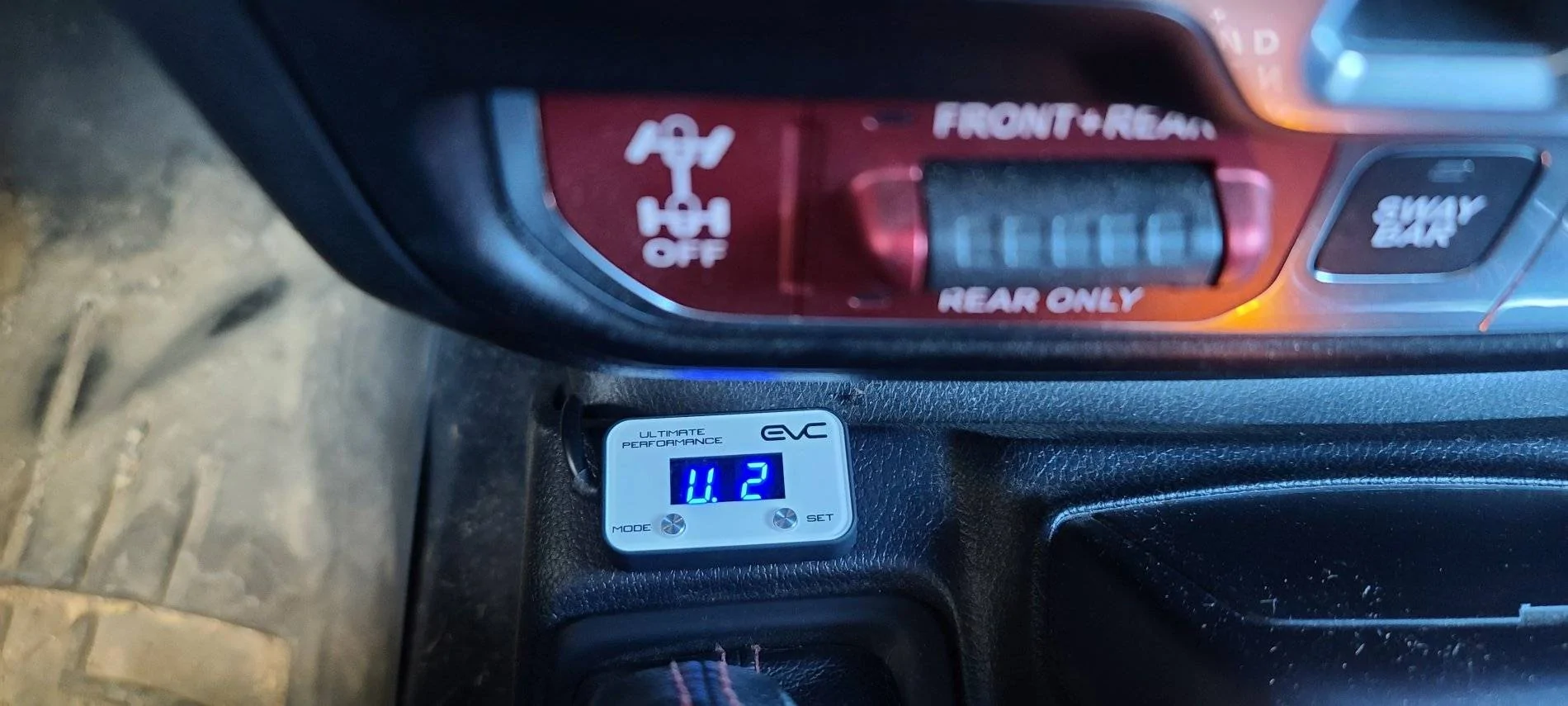

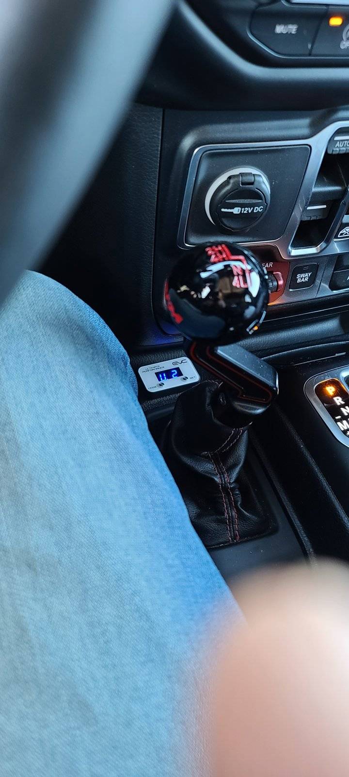

Yeah, I'm with Swagger on this one. I've got the 2.0 and a few months ago I installed the EVC iDrive throttle controller. It removes the delayed response between the throttle pedal input and the opening of the throttle body butterfly valve. Also, the sensitivity can be adjusted to suit the driver and the driving conditions. Meaning, wide open throttle can be achieved with as little of 20-25% of the total pedal travel. My particular unit includes Ultimate (sport) and Eco modes. I daily drive in U2, which is the 2nd level up out of 9 total in Ultimate. But for offroad, when bouncing around and not wanting a hair trigger throttle response, I can switch on the fly to Eco mode and have a smoother and more forgiving feel to it.
I highly recommend it as a worthy upgrade. Heres a pic of mine, taken from my pov in a normal driving position. And another closer in.

Yeah, it doesnt change the transmision shift points, but the effect is the same. The Jeep engineers may have detuned the drive by wire throttle response on the 2.0 vs the 3.6 to get a smoother throttle response, to the detriment of not downshifting as quick with the same amount of throttle pressure. Works with the auto trans better than the manual trans for this reason. The aftermarket throttle controllers allow you to adjust the throttle to your own liking.
I'm thinking that the softer throttle response is yet another stupid proofing for the masses. All vehicles have become faster and more powerful, so it helps prevent your average person from having a herky jerky ride as a result of their inability to control themselves. Same reason for not being able to use the rear locker in 2 and 4hi, or the auto park feature. The general public can't even be trusted to not run themselves over. Lol
