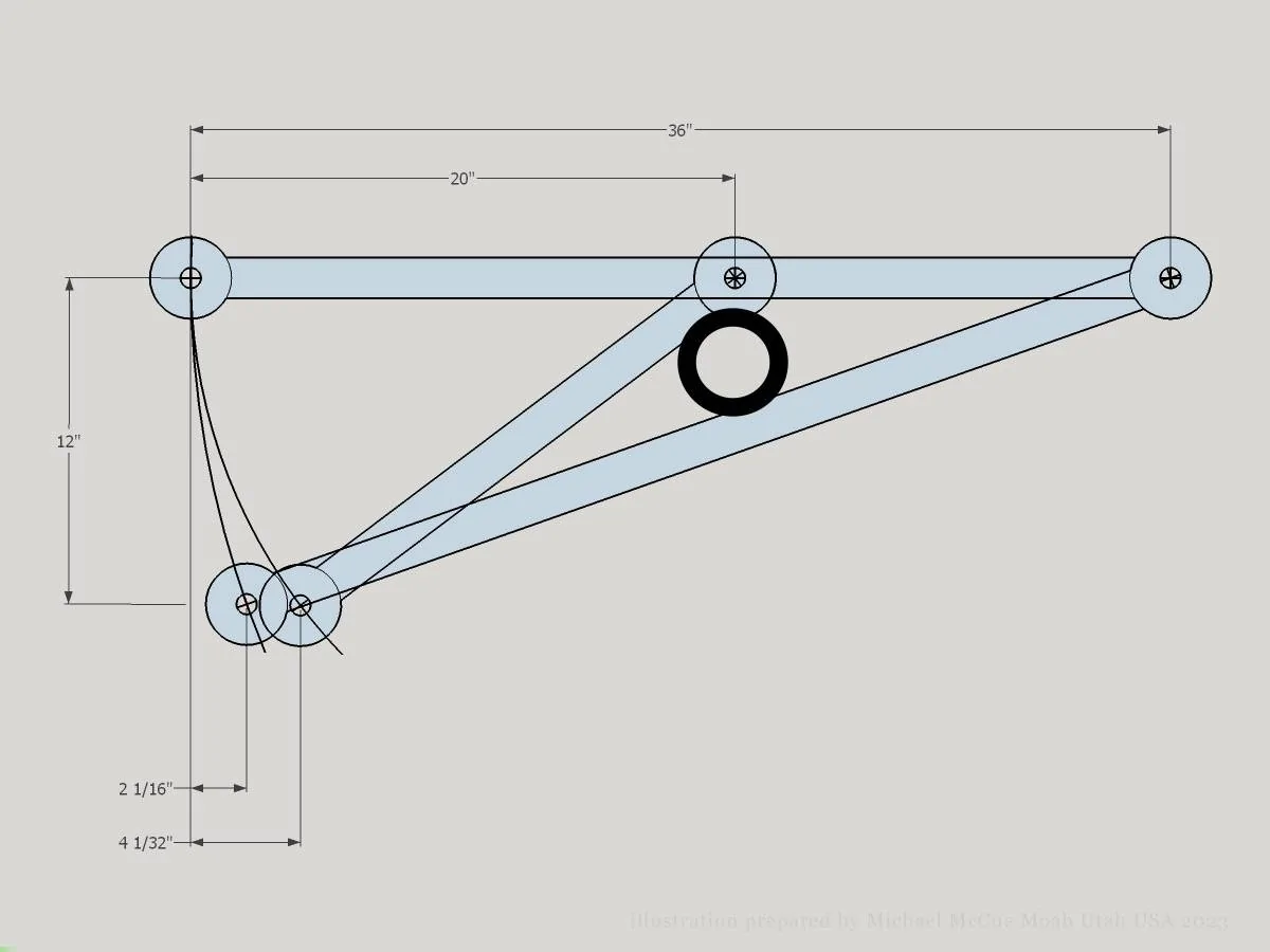

Here is a generalized illustration of rear lower control arm arc swings
Are the upper & lower axle-side mounts really in line with each other? And do you have the front also?
I believe this just shows a long arm versus a short arm.

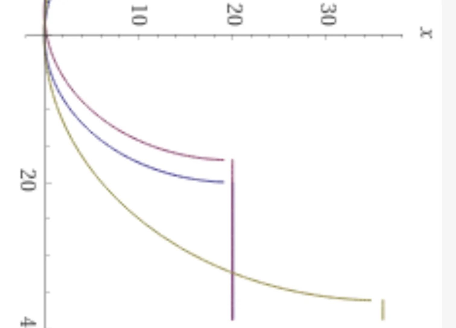

What does the arc look like if you drop the short arm down 2” at the frame side…..
0.1” in up top. At front line at -2”. 2.68” in at bottom

Thanks Matt……. So I’m assuming the blue line is the 2” drop ? I just looked up the DB3 and it actually drops the arm 3”….. ?
Yup, here’s three inches. It’d be better if I wasn’t on my phone using wolfram.

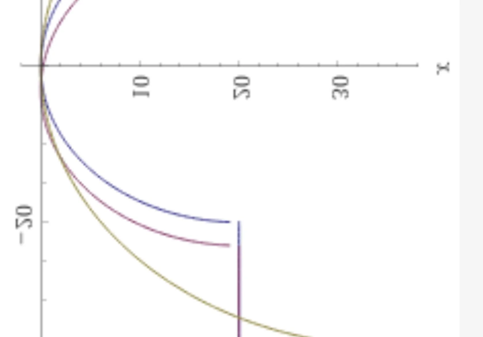

Whoops, helps if I grab the correct side of the graph.
Red is actually the -3”
