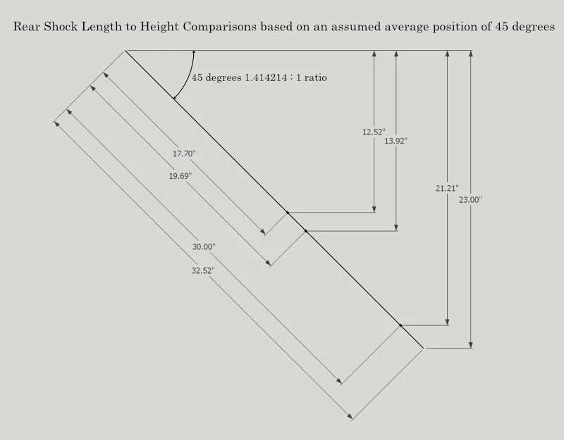

...Given the angle of the rears you lose about 20% vs front straight travel...
That is a good point, which I had not considered when I made the post.
Thank you.
This made me curious, so I approximated the dimensions by using an assumed 45 degree angle, which is probably a bit slacker than the actual angle of the shocks, but does illustrate the point you are making about the angles.
Jeep Wrangler JL Metalcloak lock-n-load vs Game changer Jeep Rear Shocks geometry

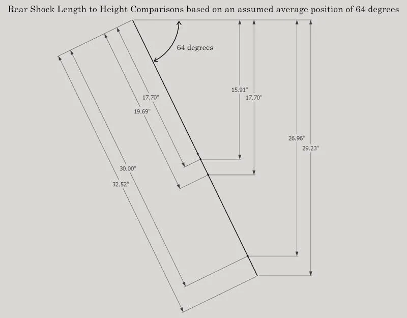

Then I realized I could easily go out and measure the resting angle of the rear shocks on my Jeep. I measured 63.8 degrees, so I made a second illustration that approximates the dimensions by using an assumed 64 degree angle.
Jeep Wrangler JL Metalcloak lock-n-load vs Game changer Jeep Rear Shocks geometry 64 degrees
Thanks again for mentioning the need to acknowledge the angle.
FYI per AnnDee's data, the length of shock at full metal-metal stock (non XR) bump is 17".
This is really just a close enough number... almost all Jeeps are +/- 1"
Thank you.

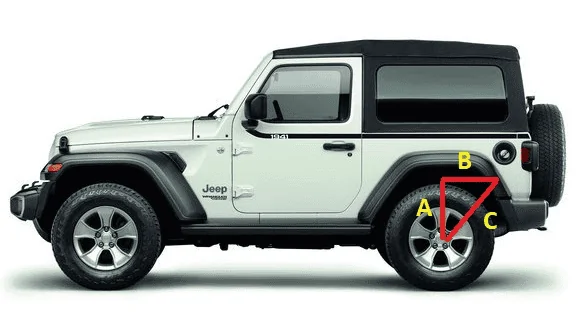

Here's what I've been using:
A = Suspension Height (actually vertical distance to top of shock)
B = 11"
C = Shock Length
Jeep Wrangler JL Metalcloak lock-n-load vs Game changer 1679508440472
