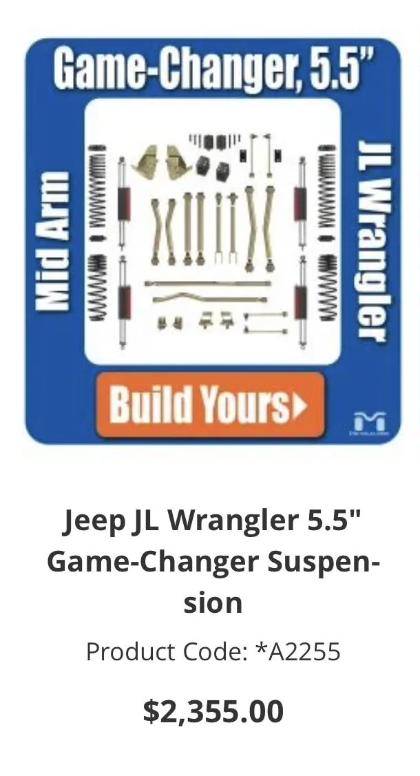

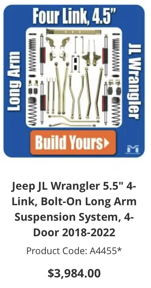

Thanks, I can be an over thinker trying to get every last bit of juice out before I even squeeze sometimes.
Also, I see there are now 5.5 inch versions of all the MetalCloak lifts now. Didn’t notice them a few days ago, when did this happen? Wondering if that piques @Headbarcode ’s curiosity…
Edit: must be very new, the long arm version picture even still shows “4.5”, but the link says 5.5.
https://metalcloak.com/jeep-jl-wrangler-suspension-fenders-skid-plates.html
Jeep Wrangler JL Metalcloak lock-n-load vs Game changer 550A3843-EB21-4405-9B35-B2B1B10EBAFA
Jeep Wrangler JL Metalcloak lock-n-load vs Game changer DAF1F472-2F57-4163-99F6-AA5BEA02CBB3

Yeah, the 5.5's must've just showed up in the last couple of days. Even their product page descriptions are stuck on the 4.5" springs specs, namely the 21.5" free length. Also, they aren't showing a seperate listing for 4 door front 5.5" springs. Only 4 door 5.5" rears.
No, I'm good with the 4.5" springs. They have my Jeep sitting 5.5" higher than stock up front and 6" out back. Their new long arms, on the other hand, are becoming more and more enticing with every day that passes. Only thing that gives me pause, is the idea of pairing the Metalcloak 4.5" springs and 6-packs to Rock Krawlers super high tuck long arm setup, and rounding it out with a pair of Dynatrac axles that can be ordered with Rock Krawlers long arm brackets.
