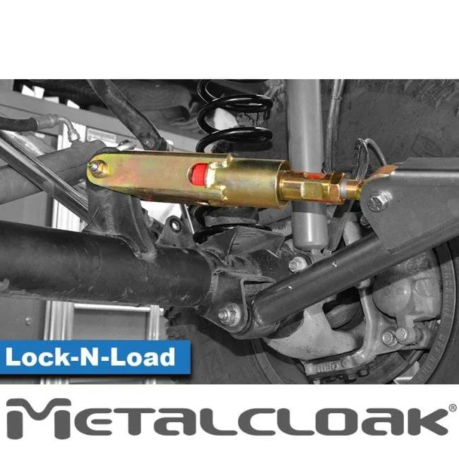

The lock-n-load turns the front suspension into a 2-link. The benefit I see is that this affects how the pinion angle changes under droop/compression, which is ideal if you get the pinion pointed directly at the transfer case (assuming a single cardan joint at the front, some sort of CV at the rear... like a stock shaft). This is because the 2-link's pivot point is approximately the same as the transfer case joint. Check out the driveshaft vs. link angle below:
Jeep Wrangler JL Metalcloak lock-n-load vs Game changer 7287-front-radius-arm-upgrade-system-10
Here's the magic that makes it flex: "Remove the bind in the Radius Arm suspension with a Lock-N-Load control arm. Allows up to 1.5 of movement under extreme forces that allows your suspension to really flex. Removes strain on bushings and brackets and provides the safety of 4 attachment points to your front axle without loosing any of the flex. Lock it for street use to stiffen up the handling and unlock it for massive articulation."
Jeep Wrangler JL Metalcloak lock-n-load vs Game changer 7287-front-radius-arm-upgrade-system-1_1_1
