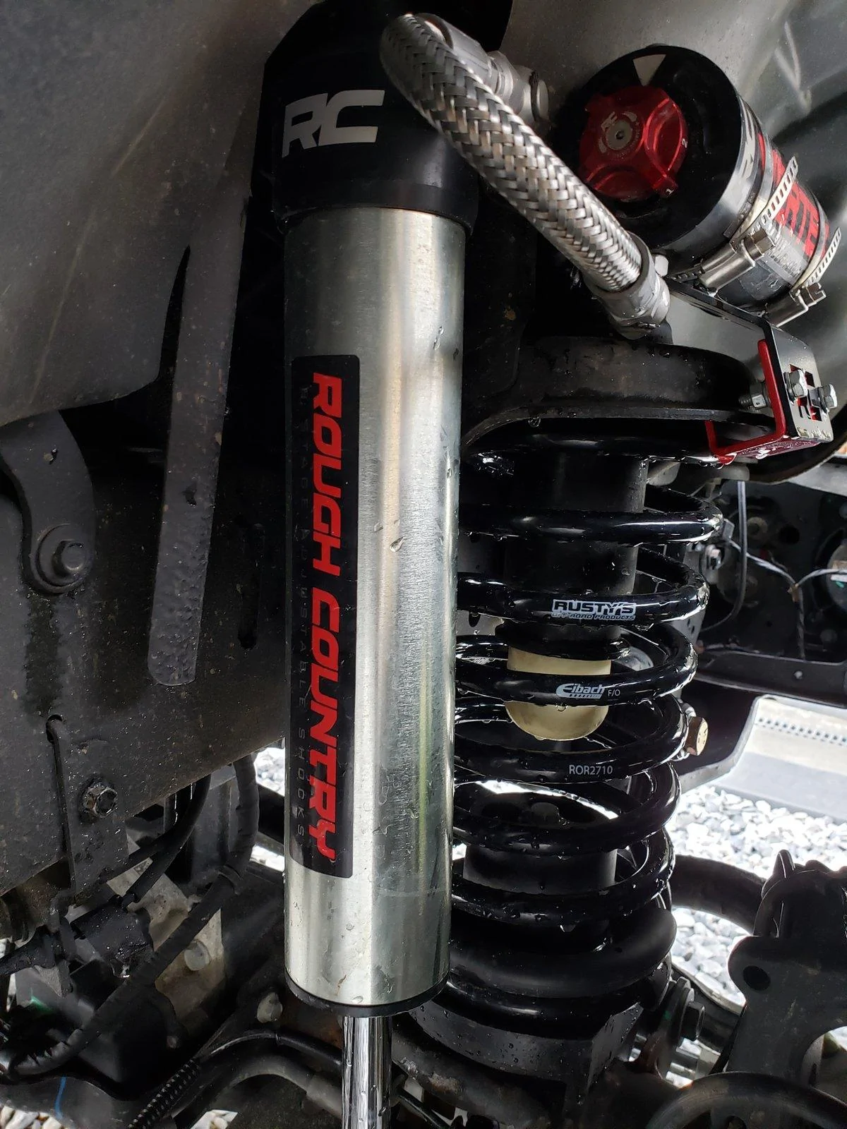

At the risk of drawing out the Rough Country haters I am happy to chime in here. I have the 2.5 inch RC lift with the Vertex Adjustable shocks on my 2020 Rubi. I've had them on for about 4k or 5k miles now. Zero problems. Full disclosure I did swap out the RC springs. Not that I didn't like them but I had a chance to put the Rusty's 2 inch progressive rate springs (front and rear) made by Eibach for Rustys and once I put em on i never took them off!! SO I'm running Vertex 2-3inch Ressie shocks with Rustys Performance package (2 inch springs and all the lower control arms plus the track bars) and I kept RC sway bar end links and bump stops on.
Jeep rides great on and off road. I've said this in another thread but i'll briefly review. I live in central Vermont. I live 3 miles up a dirt road. No other way to my house other than a rutted, pot holed, washboard dirt road. I have 2 vehicles. A 2020 Rubicon and 2017 Raptor. When no one is around and all the farm animals and tractors are to bed i often BOMB up my 25 mph road at 40 or 45. The Vertex shocks are usually set on mid setting #4. She runs great! Not exactly as well as the Raptor but that is kinda Raptor territory. Also tonnes of great trails to run around here. Big rocks, ruts, mud pools and some steep climbs. I have no issues with the setup.
On road - everything is 30 to 45 minutes away around here. Jeep runs great. Corners pretty flat but not a harsh ride.
Im not fan boy, just happy customer. Both Rustys and RC have great customer service. Those Vertex shocks come with 3 year warranty as well. happy to answer any questions and good luck.

THanks for the input. I have a 3.5" RC lift with the basic entry level N3 set of shocks. This is my first jeep and first lift, so I'm still learning.
I do get quite a bit of bounce and harshness on 35x12.50x20 on Toyo Open Country R/T which are an E load rating. Although this does impact the ride quality some, it's not as much as many think.
I Just temporarily installed the factory wheels and tires again and still get some bounce and side to side movement on an imperfect road.
What I'm wondering is, should my next step be upgrading shocks, or the springs? How much did switching your RC springs to the Eibach Rusty change?

HI There. I don't know your complete set up but i'm happy to give you my feedback and some advice (for what that is worth ;) )
E Rated tires - especially on a 20 inch wheel are going to make for a pretty harsh ride. I run E rated KO2 but on a 17 inch wheel and aired down to the low 30's.
The Dual Rate Progressive springs from Rusty's, in my case, where an improvement over the 2.5 inch RC springs. Both were an improvement over the stock Rubicon spring. A bit firmer in the corners and a better road feel. The progressives just improved that feel over the RC even more. But I don't think this is your main concern.
Your "bounce and harshness" I believe is going to be your 20 inches E rated tires and your shocks, along with air pressure. You will certainly notice a difference in ride if you upgrade to the Vertex adjustable. Given the 8 levels of adjustability you can "tune out" some or most of the harshness by going to a softer setting.
Lastly - especially with a 3.5 inch lift hopefully you went with all adjustable LCA's. Getting your alignment and especially your caster (ballpark 5.8 to 6.2) properly setup makes a huge difference in road feel. I bet some of that side to side or "squirrely" feeling is due to alignment.
Hope this helps.
