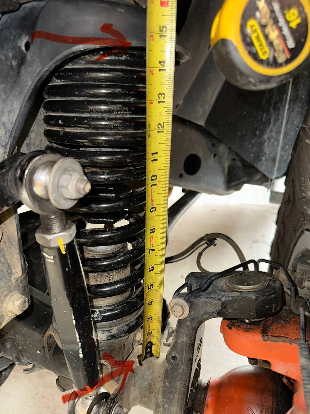

Before you lift it measure like in the pic at ride height ( top of axle tube to bottom lip of upper coil housing) before and after the lift the difference in the measurements is how much lift you actually got, and then you can decide how much more you want to do…..

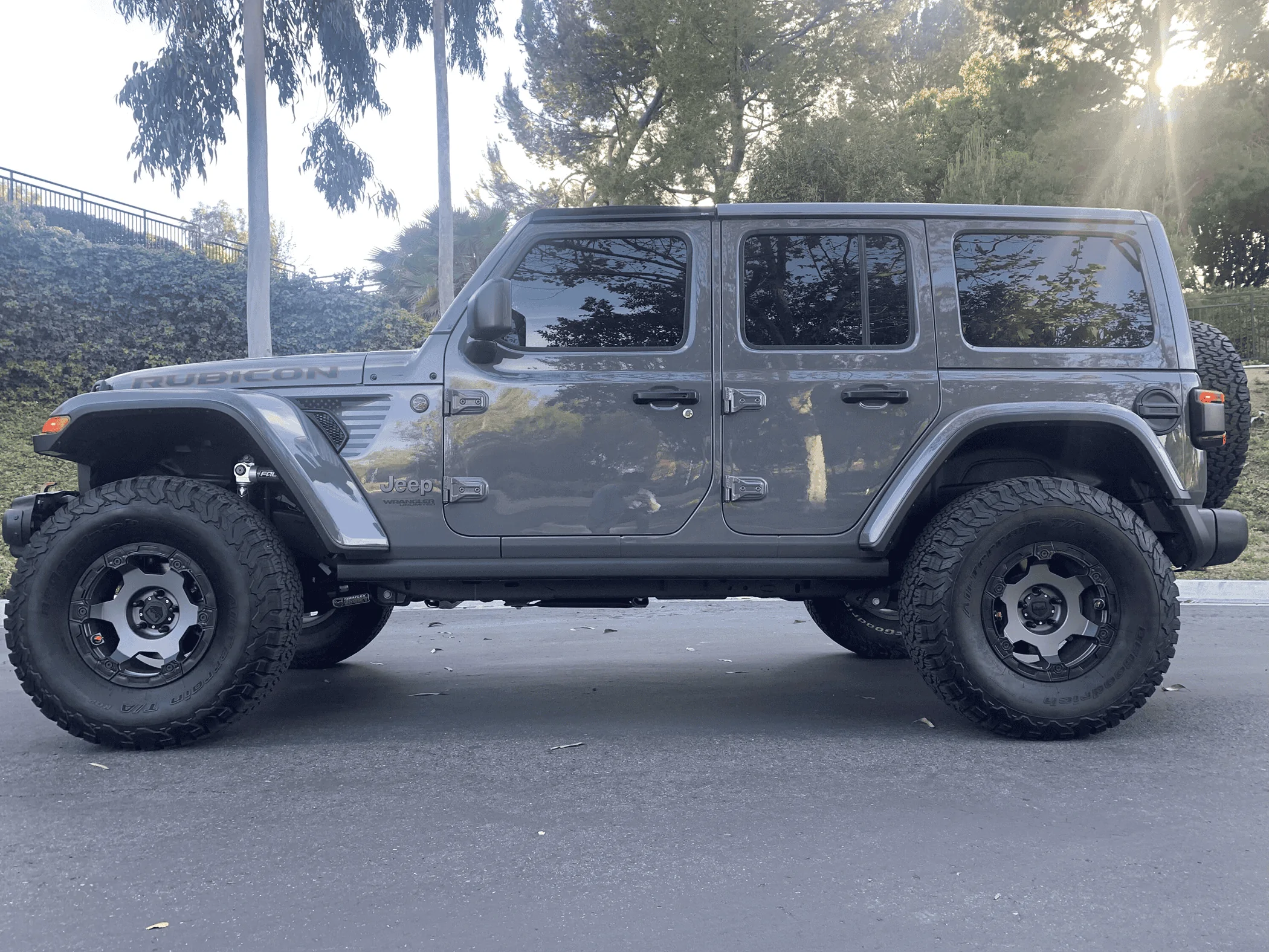

That is the lift that I am running and I like it (37s with TeraFlex ST2):

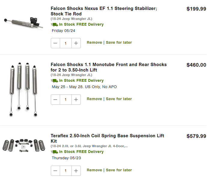

So I went ahead and placed my orders. Northridge had a really nice discount code, so I ended up getting almost everything there. Got the shocks from ExtremeTerrain because they were about $200 cheaper there for some reason.
Rather than going with the full Teraflex S/T2 lift kit, as it comes, I broke it down into each part included. That way, I could swap the Quick Disconnect front sway bar links and rear trackbar relocation bracket with the Teraflex adjustable rear track bar. I can always purchase the Quick Disconnect later, and I feel better not having to drill holes into my axle to attach the relocation bracket. So far I've managed to keep every mod on the jeep completely bolt-on.
