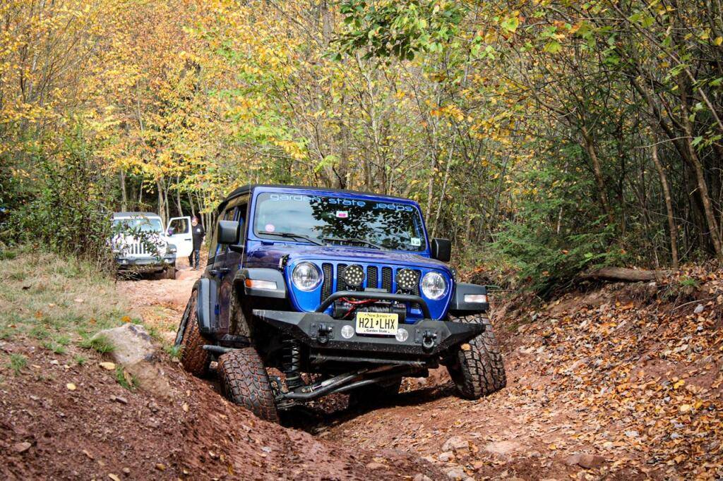

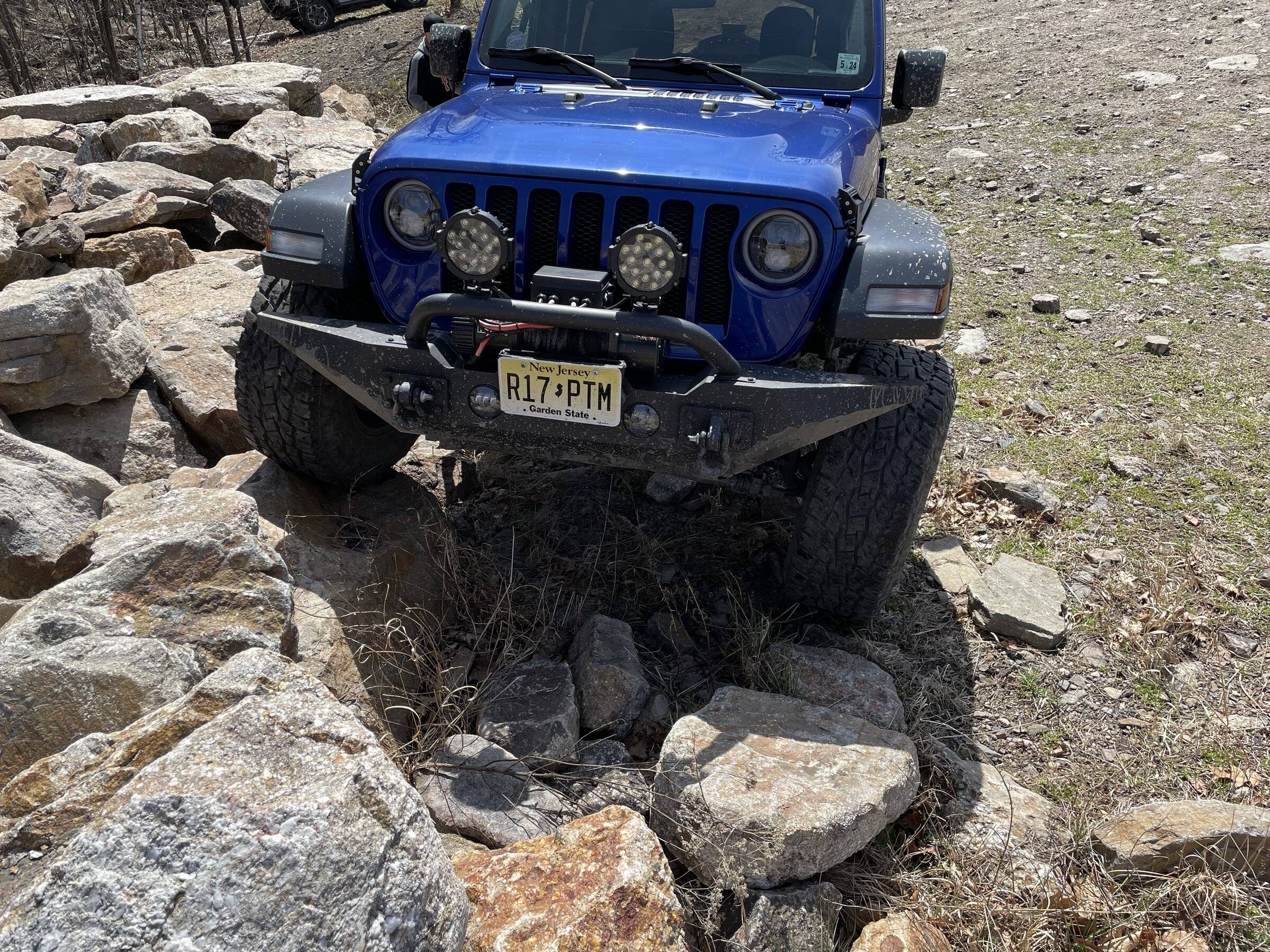

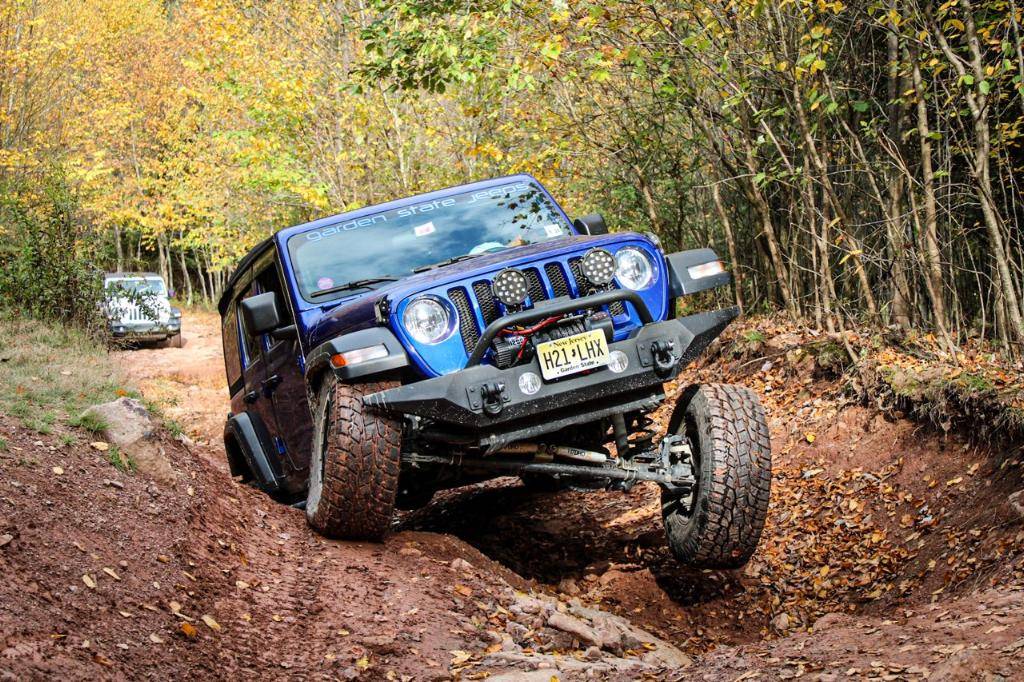

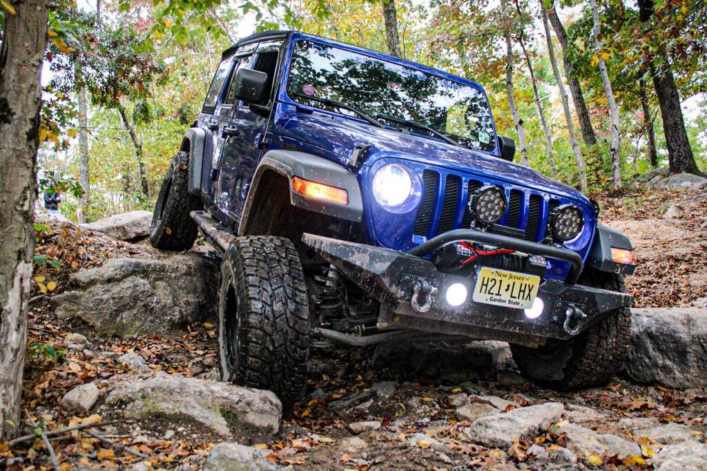

I am going to tell you that you can go a different route and I guarantee everyone that has responded already will bash it. For what you plan on doing you can do a simple coil spacer lift. I am running a 2.5” coil spacer lift on my 19 sport s JLU. I run teraflex 9550 shocks for a 2.5” lift and JKS quick disconnects. I rock crawl on this setup with no issues. I run Raush and AOAA at least every other month. I do anything from a green to a blue/black trail and have had no issues in 35,000 miles. Just my opinion.
