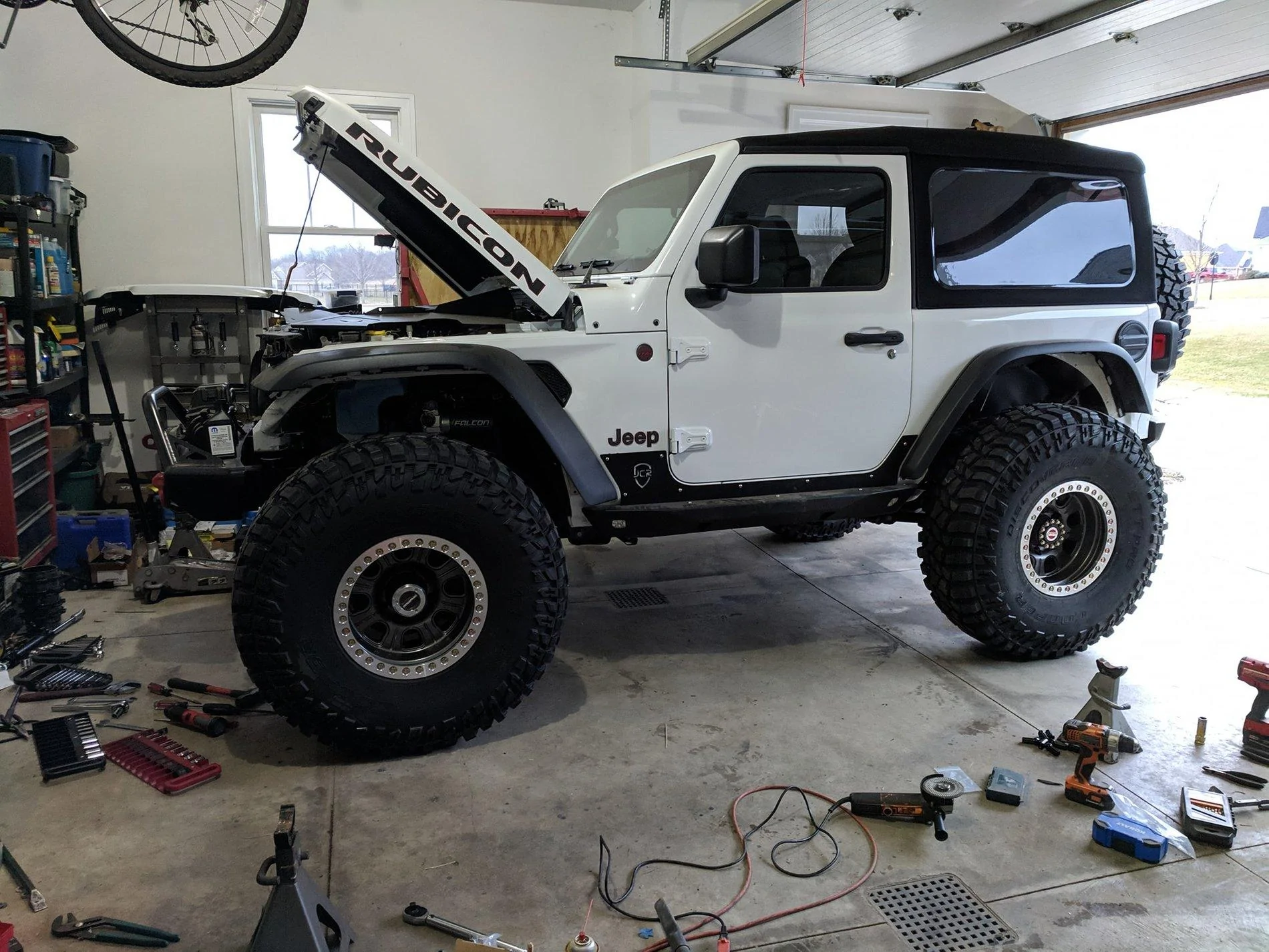

@Rock Krawler Suspension Installed the 2.5" RK Stock Mod kit over the weekend. Previously had the Teraflex ST1 1.5" spacer kit on the Jeep. Install was smooth, the rear track bar bracket is pretty slick. Will install the front track bar later this week at work once I get the jam nut torqued properly. Ended up ordering a set of Fox 2.0 ifp shocks as my Falcon 3.3s are too short, limiting down travel. Will give my impressions on the ride quality with Fox shocks after I've had them installed for a few days.
Based on before and after measurements the RK kit netted the following over the Teraflex ST1:
Front Left: 1.75"
Front Right: 1.75"
Rear Left: 1"
Rear Right: 1"
RK 2.5" kit vs stock height:
Front Left: 2.75"
Front Right: 2.75"
Rear Left: 2.5"
Rear Right: 2.5"
The stance looks a little tall to me, but I would expect the springs will settle some over time.
Jeep Wrangler JL 2dr lifts RK 2.5 Angle
Jeep Wrangler JL 2dr lifts RK 2.5 Side
Front Left: 1.75"
Front Right: 1.75"
Rear Left: 1"
Rear Right: 1"
Front Left: 2.75"
Front Right: 2.75"
Rear Left: 2.5"
Rear Right: 2.5"

Pinch seam to ground measured out at 21.5” (with 315/70/17 KO2s)
Thanks, that's confirms what I thought. Mine is right around 19" which is right around 2.5" higher than stock (1" for the tires and 1.5" for the Rubicon springs). Maybe it's time to get the floor jack out and see how I like it at 21.5" :)
