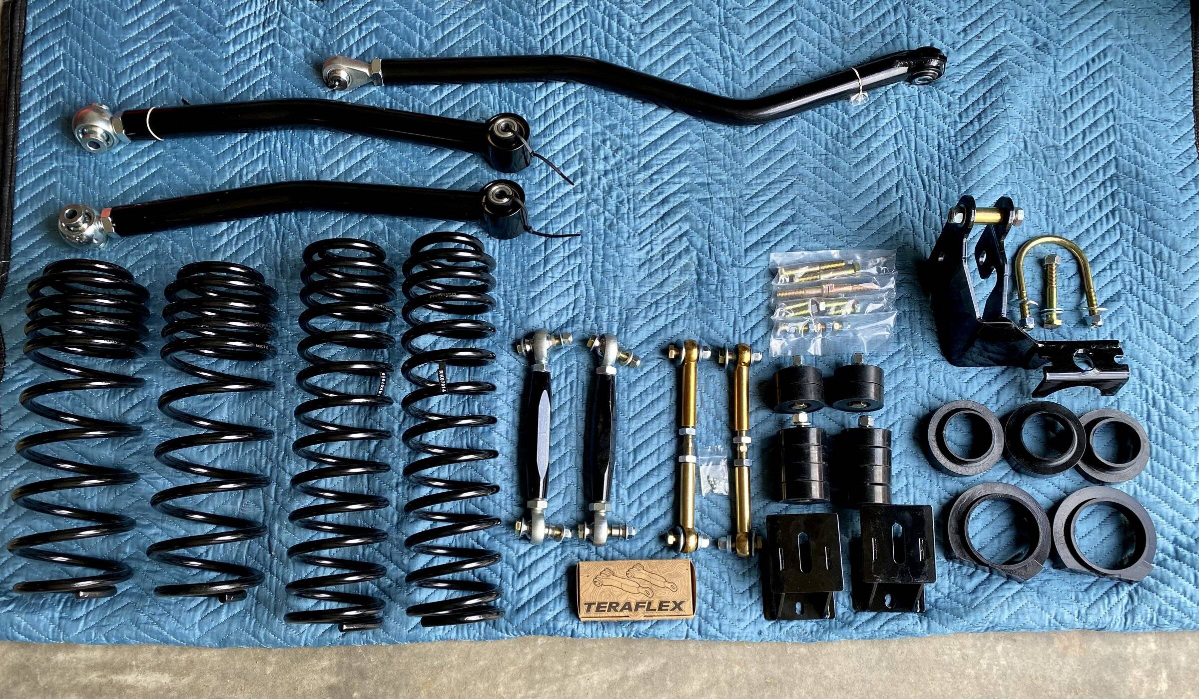

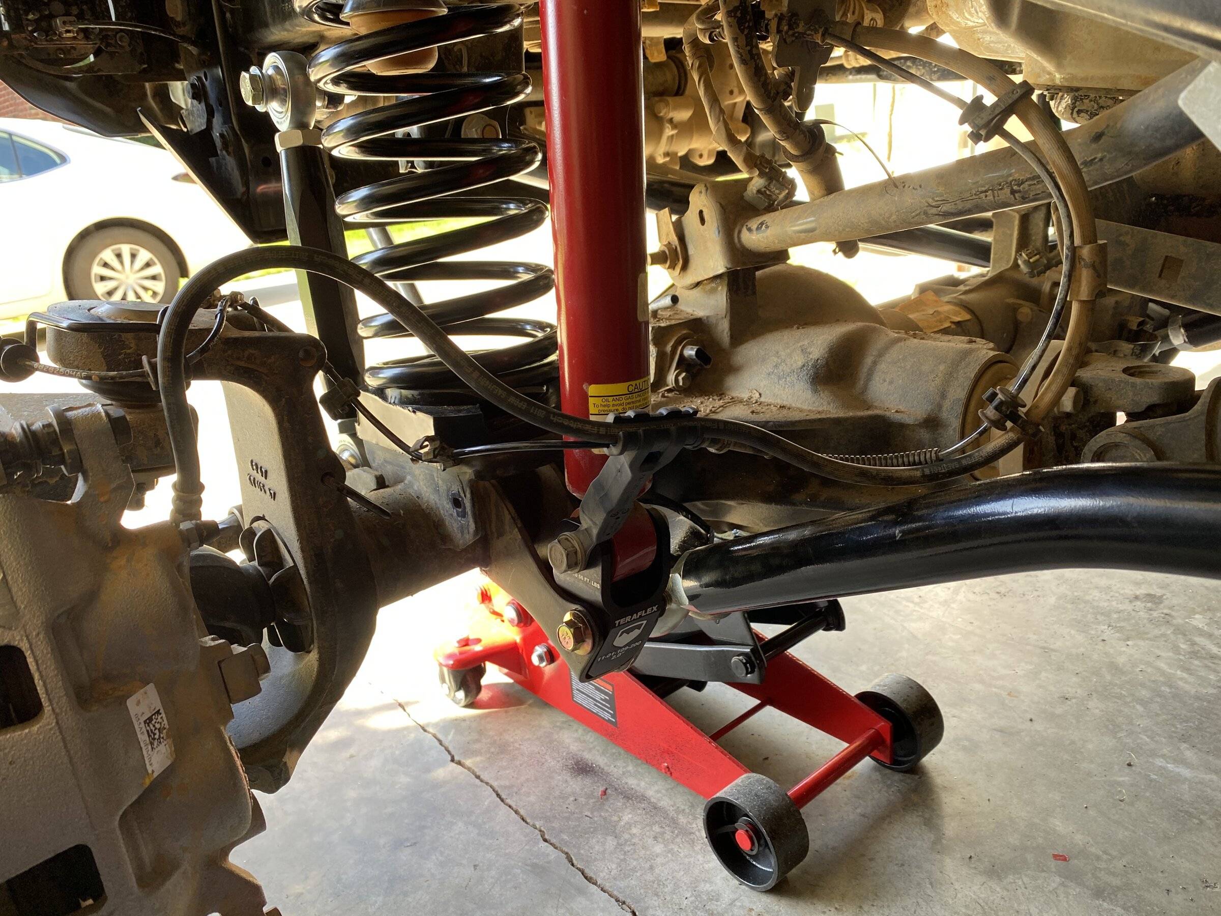

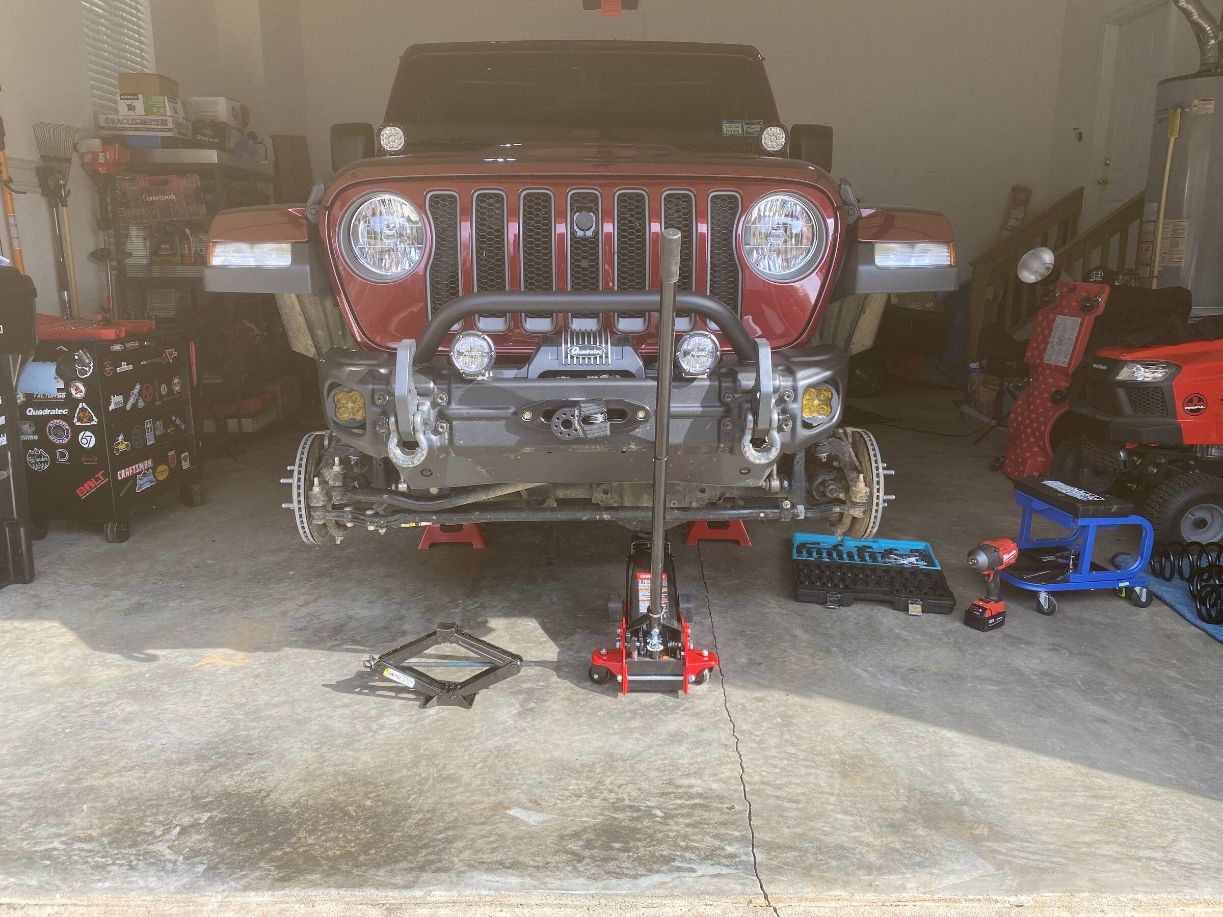

I just installed the Rock Krawler 2.5” Flex No Limits kit. Got it from @Northridge4x4 and it came out to $1611 at the time.
I also added in the Rock Krawler RRD Spec TT shocks and bump stops.
If your budget doesn’t allow for the shocks, you can get the Teraflex shock extensions to hold you over. I initially bought the extensions because my RK shocks were in UPS limbo for a bit. They arrived right after I installed the factory shocks and extensions ?….so I had to go back and redo the shocks.
I got it done in my tiny garage with no major issues. Install is pretty straight forward as long as you have the tools and know @Roky

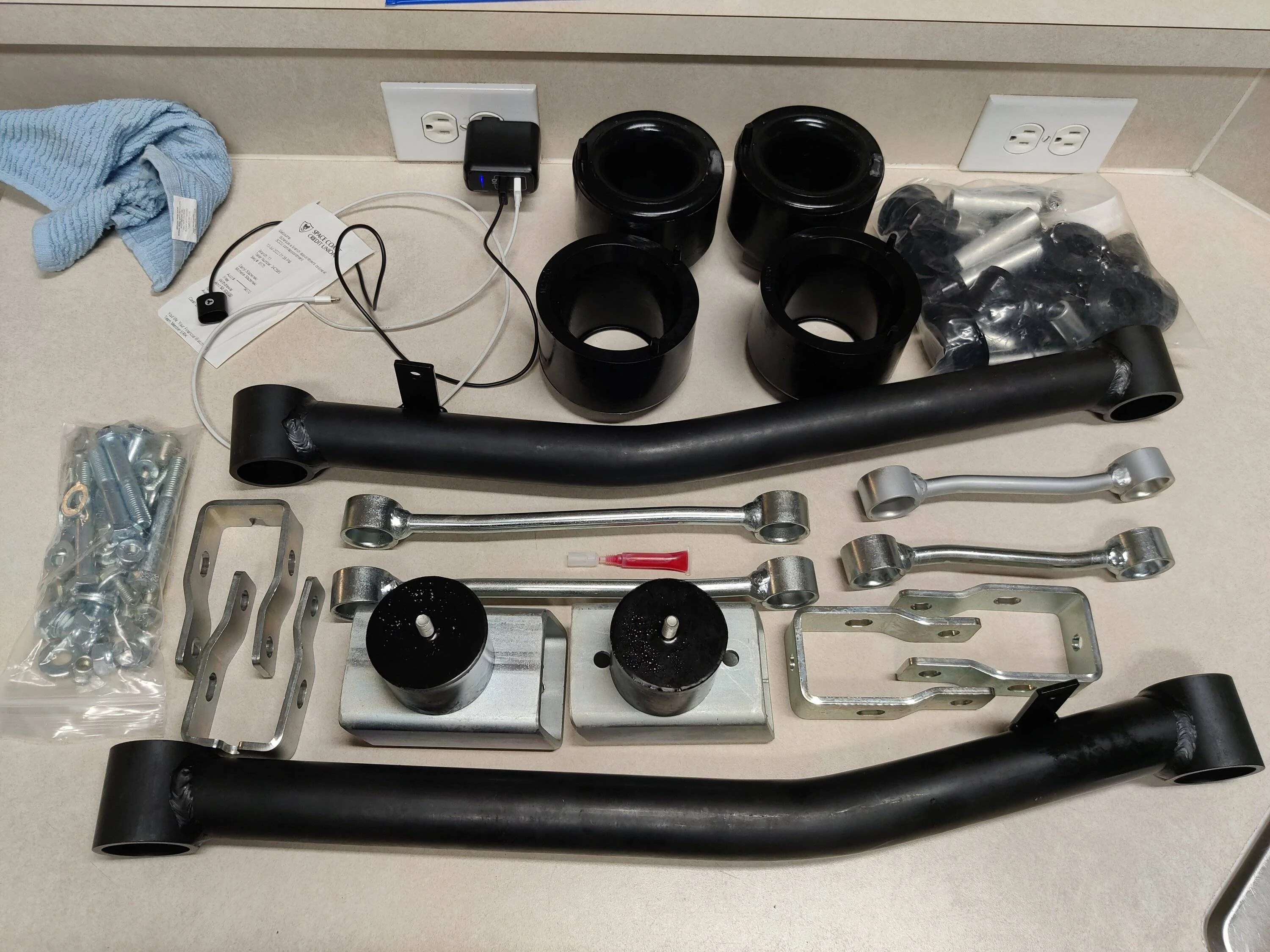

So I have spent months researching. For me, my jeep is my DD and I want to keep the factory ride quality, which I think is pretty nice. There's also the issue of only a couple lifts made that I don't need wheel spacers (which I am against) or new wheels with the correct back spacing, which means new tires and I have funds for none of this. Plus you need longer LCAs.
After lots of research and thought I decided on the Daystar 2.0 inch spacer lift/ leveling kit. Retail $415. I found one for $274 shipped. Reviews are actually really good except one area, the finish. So I am going to spend another $100 and get everything powder coated, and it comes with the longer LCAs and I can use my stock Rubicon wheels. Then I am going to look for some Rubicon take off tires, and I think I will be good for the next 5 years or so and my jeep will do everything I need it to.

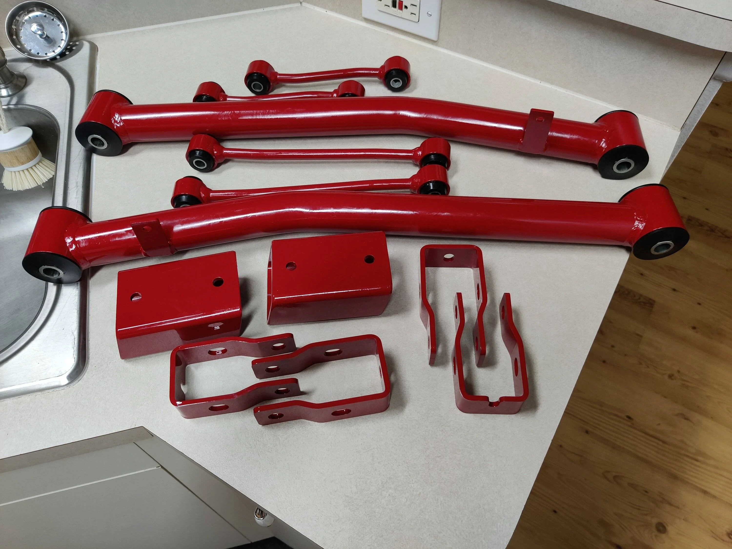

Almost lift time. I called Daystar and was talking to them about their parts. Seems all their parts come with a clear zinc coating already on them, except the LCAs.
So I decided to blast the LCAs and paint everything. This is a aircraft grade 2 part epoxy polimide primer with a 2 part polyurethane paint. It's very durable when applied correctly.
I know this isn't a really nice expensive full lift or anything, but I still want it to be nice and not have crappy, rusty stuff under my jeep. It should last a good while. Everything has gone up my powder coater wanted between $175 and $200 to do everything which I don't think is terrible, but hey, this way I saved the $.
I also don't have a vice big enough to install all the urethane and steel bushings at home so I got a 8" C clamp from harbor freight, used a lot of the supplied lube and everything went together perfect. Didn't damage anything.

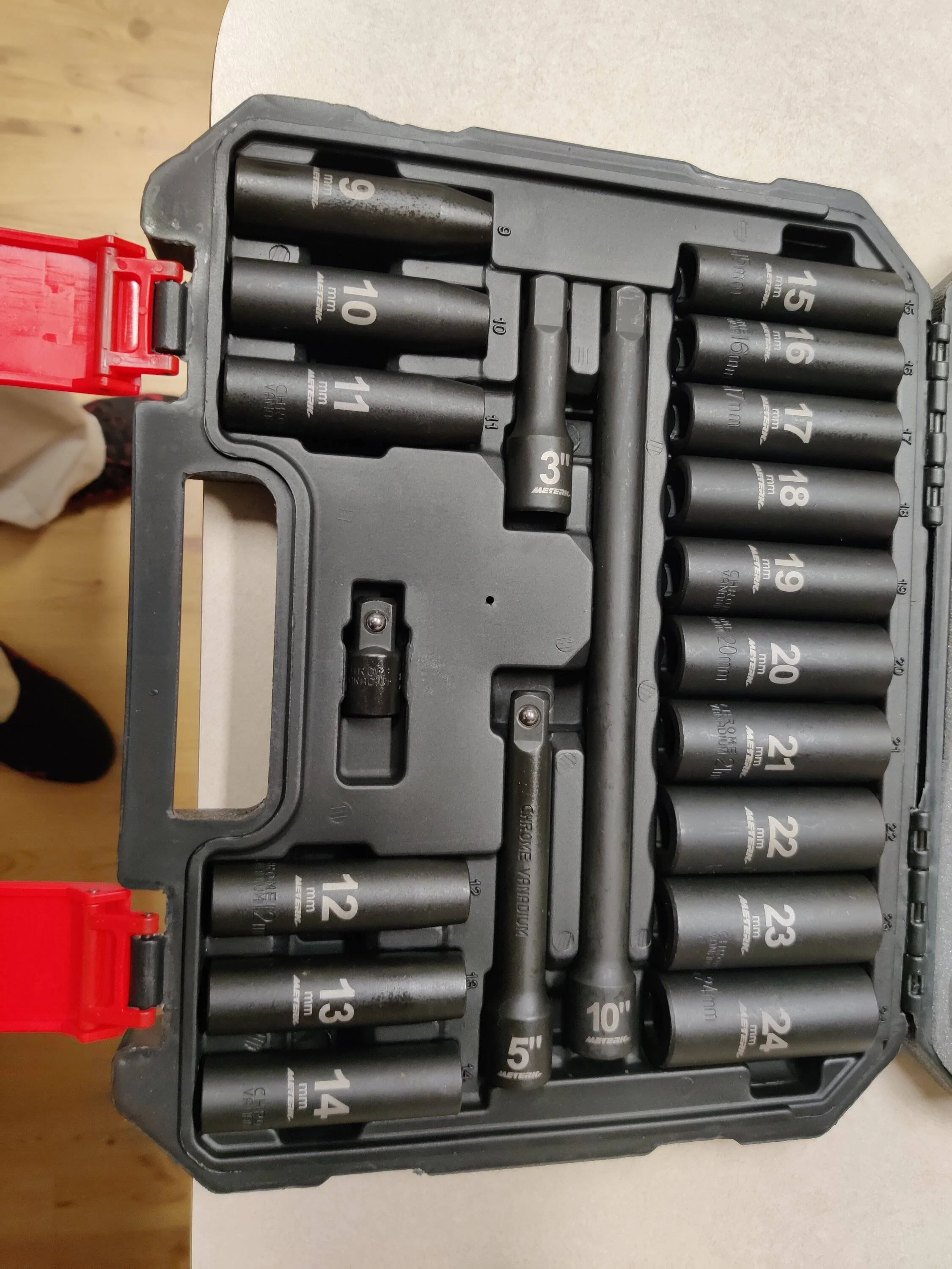

Well another $37. I have a metric socket set, but it doesn't have the larger sizes. I have been working on my metric bike for years and I have only had to buy about 3 different sizes I didn't already have.
But looking at the sizes for the jeep I was like crap. I didn't have the 18,21, or a 24mm.
Not complaining though, a new set was overdue. So I got this of Amazon. Cheap but should work.
