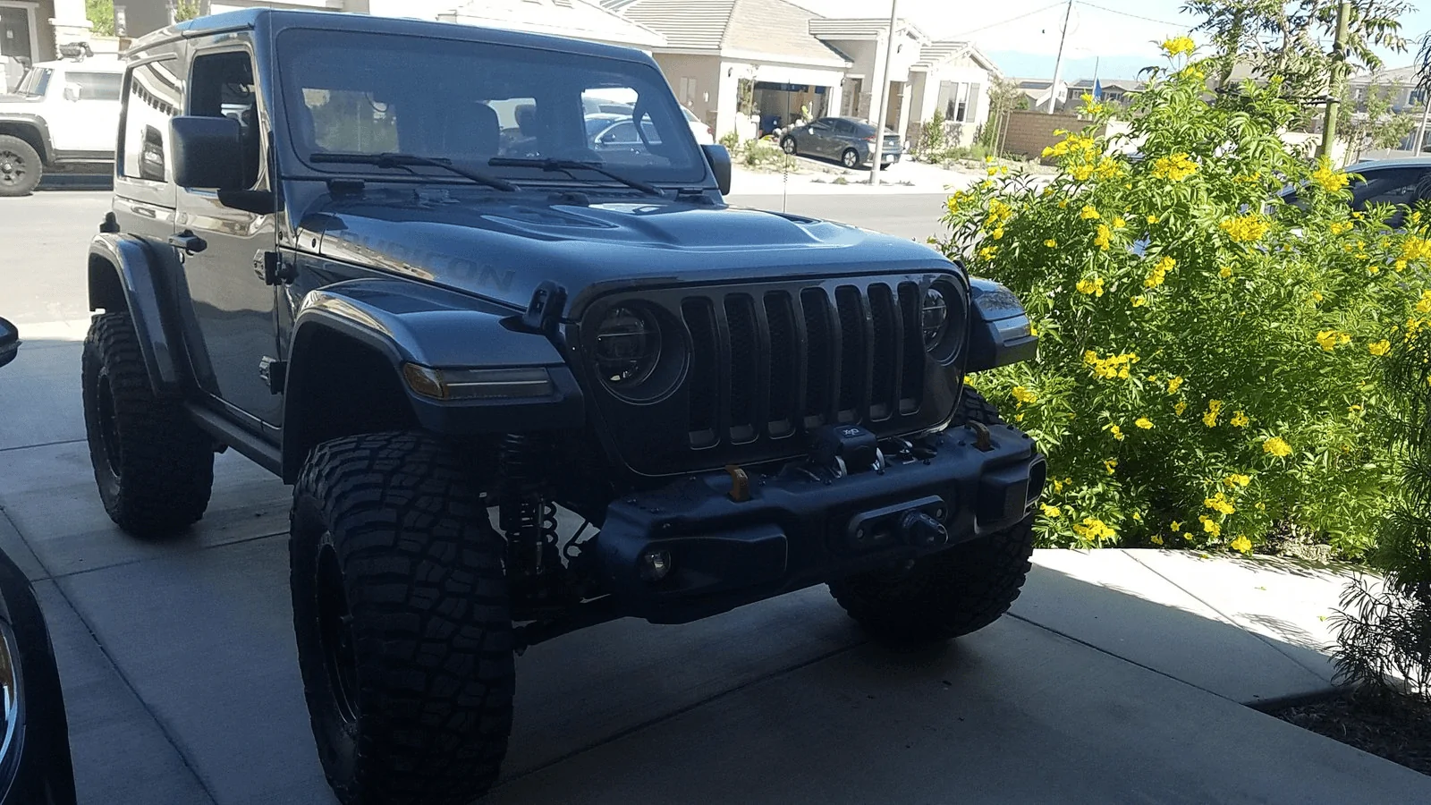

I can't seem to drum up pictures of a 2 door 2.5, here is a 2 door 3.5 on 37's that is very light, aluminum bumpers, no spare, aluminum fenders, soft top, etc so it sits a bit higher than what you'd normally see out of a 3.5" kit. Id agree with you that 2 doors seem to be left behind, and I believe that's largely based on buyers. The numbers we've seen puts 2 doors at about 7-10% of wrangler sales, as a 2 door guy, that saddens me. I also wont be surprised if/when Jeep announces ending production of 2 doors.

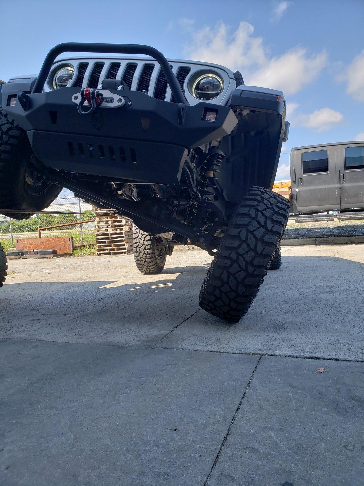

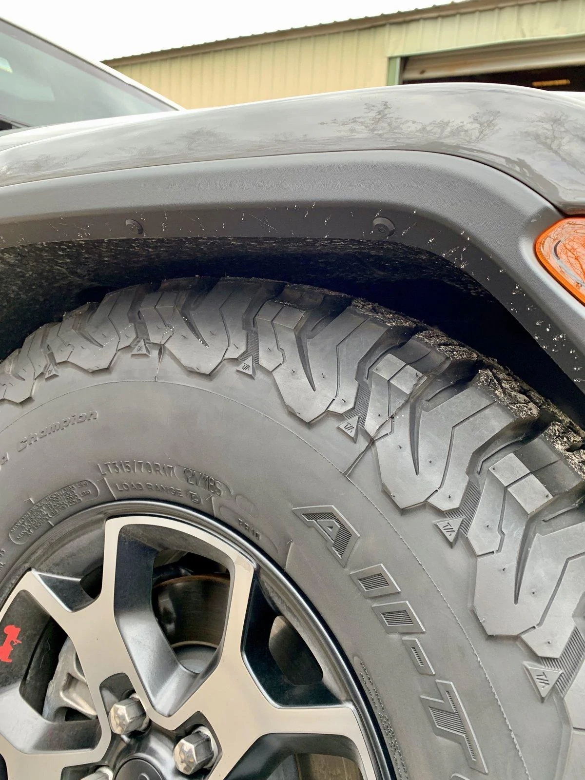

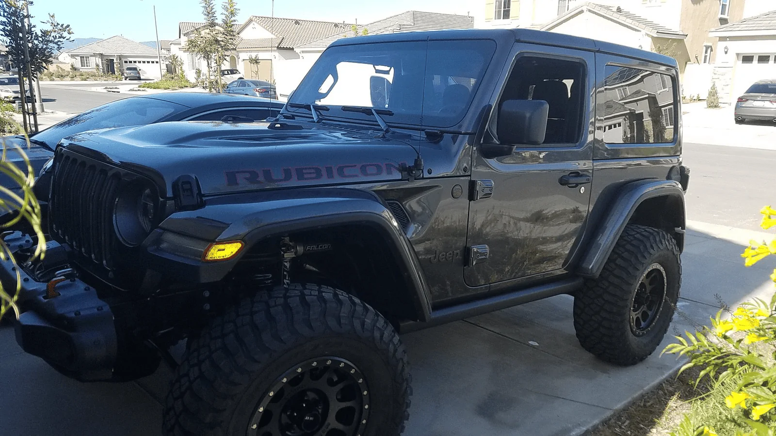

the first 2 pictures is the stock suspension on a rubicon disconnected with 315s..lifting it high enough to where I was comfortable with it where the left tire isn't lifting off the ground and I still had 1" of room on the front right fender. Approx 21" underneath the tire. IMO removing the inner liners wouldn't of helped much because you will run out of shock travel, droop to use that extra 3" room regardless. To me at that height you're only tapping into what a solid axle is capable of. People are flexing/articulating double that. Absolutely nothing wrong with your explanation, as all of us have considered the same. Till we go out wheeling, and see the limitations etc. Third picture is an RK kit with a 2.5 and 37s as an eg. Again nothing wrong with your explanation, Ive wheeled with Toyotas and gotten used to the alligator arms of always having a 4th wheel up in the air up almost all the time and comfortable with it. But having a Rubicon now Im striving more to get best use of the solid axle setup. Doing it in increments etc and learning from it at the same time.
