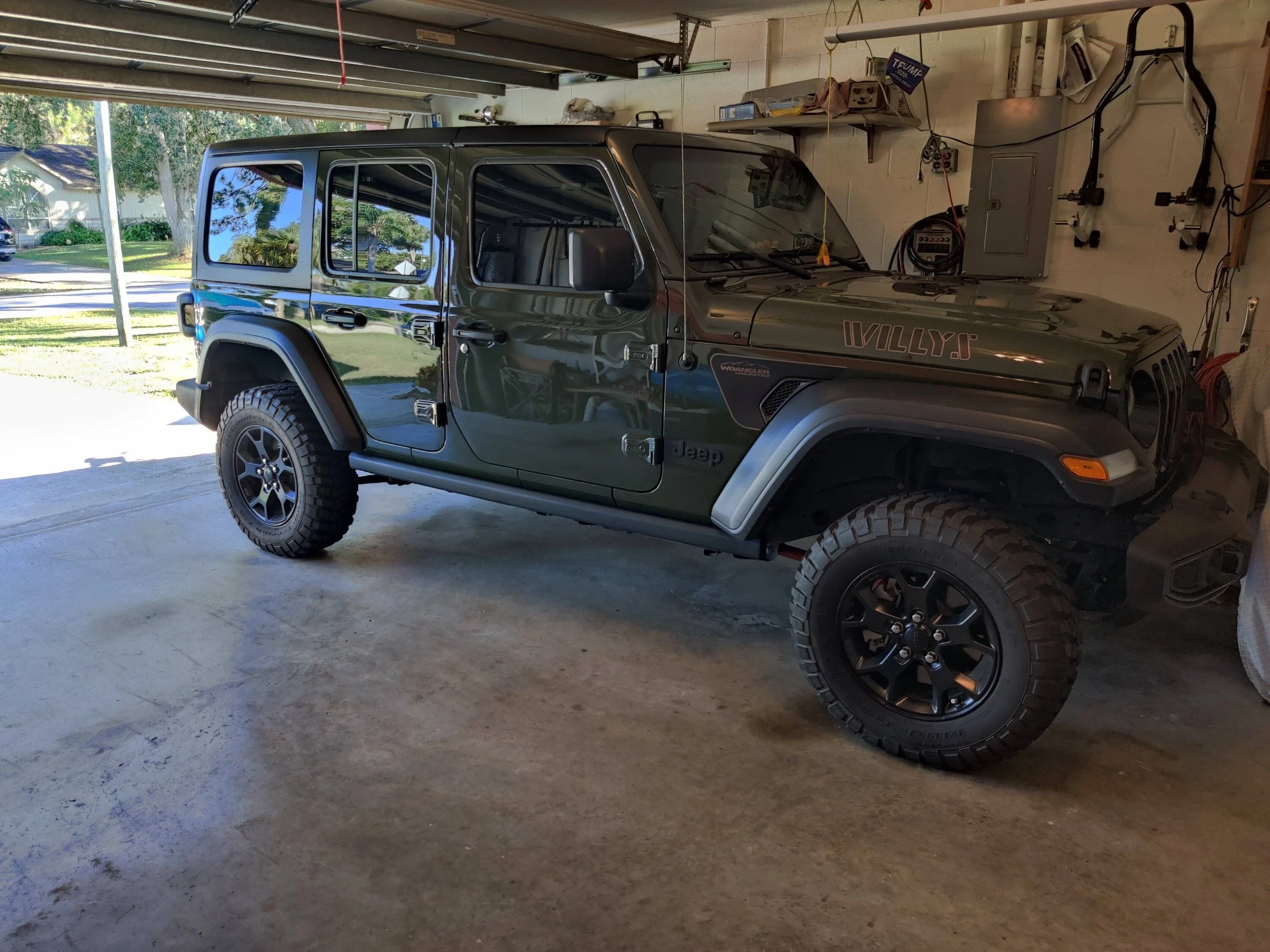

Well I got the lift installed. Started at 7 this morning and had everything cleaned up and picked up at 5. It wasn't really that hard except the torquing of everything. The torque isn't that much except the LCA's but I am a pretty small guy and trying to torque stuff inside the fender was the only sucky part. Plus the Florida heat is just killer and wipes you out after about 6 or 7 hours, much less 10hrs.
Anyway, couple issues, the drivers side shock extension bracket would not fit. Once the bottom bolt was tight so that it was flush, the other bolt holes for the bolt with the crush Spacer weren't even close. I tried everything, flipping it, the other bracket, same thing. The shock was the last thing torqued so everything else was in and torqued. Crap. So I set the bracket up correctly, then drilled my own hole. I couldn't come with any other solution.
When I got the passenger side ready to drill another hole, expecting to, it fit perfectly, what the! I will shoot a pic. Tomorrow. I believe it is fine and shouldn't have any issues.
The next issue is that the 4 bolts that go threw the bottom of the shock extensions are too short. There is lock nuts that go on and there like 2 threads short from even making it to the end of the nut. This I don't like. I was always taught 2 threads protruding out of the nut on lock nuts in order for the locking feature of the nut to work. So, tomorrow I will get 4 new longer bolts and replace them. I was to whooped to center the steering wheel, do that tomorrow also. As soon as I figure out exactly what part it is I have to adjust lol.
All this done I do like the look, it looks much better lifted the 2 inches even with the skinny 32" M/T tires I still like it better than it was.
I drove it up to highway speeds and it seems that nothing has changed ride wise, so this is good, and no death wobble or anything.
I do have a question though. Besides, and actual full lift and or wider tires is there a way to reduce the roll a little? I knew it was going to do this because I changed the center of gravity higher. Would a better track bar help? It's not horrible, but it is noticable.
