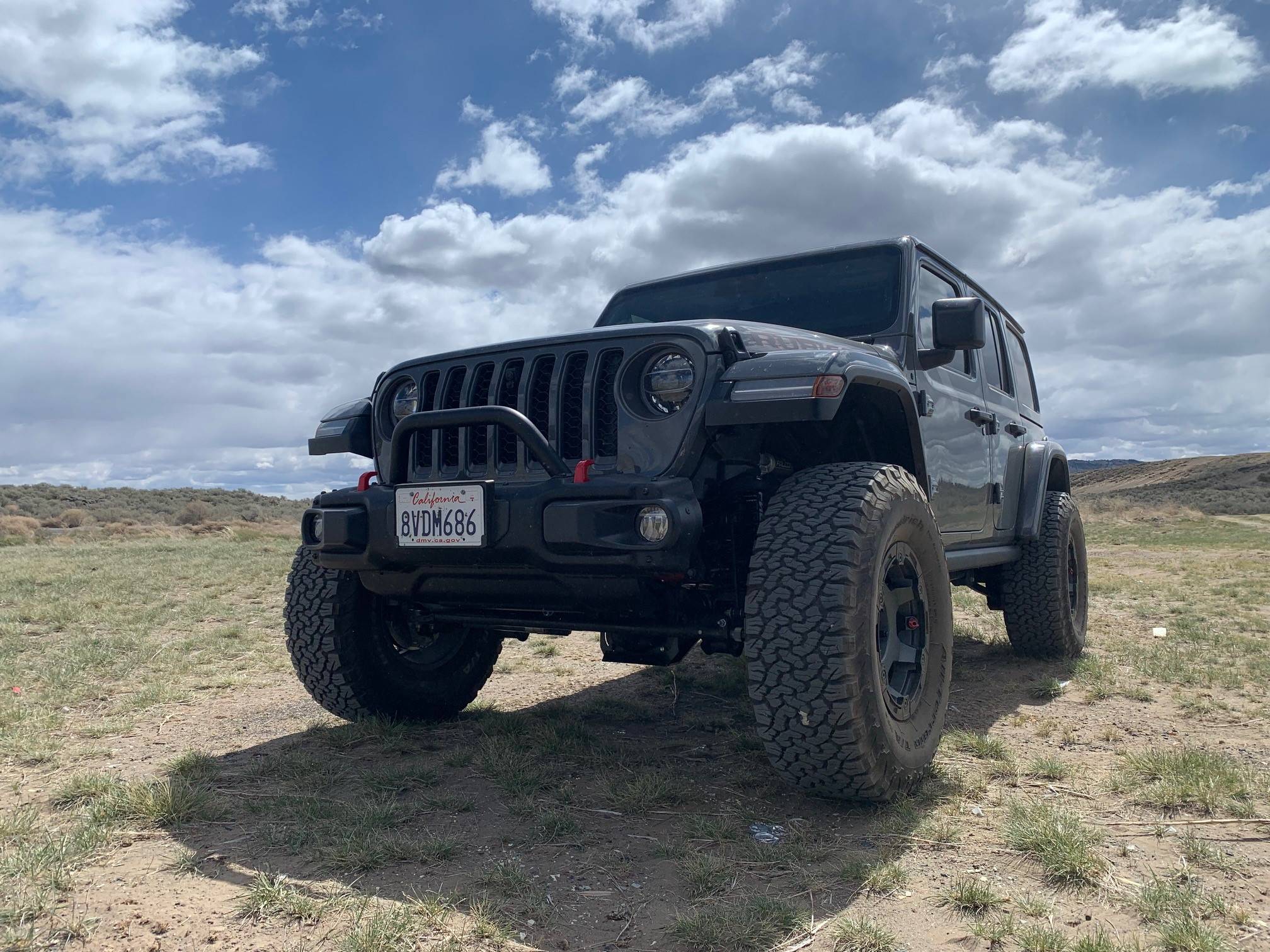

Everyone uses their Jeep in different ways. For that reason I went with TeraFlex. They have a large menu of options to help you find one to best fit your needs. I don’t plan on doing anything too crazy with my Jeep during the years that I am making payments on it so the TeraFlex ST2 with Falcon 3.1 shocks and 37" tires was a perfect option for my off-road adventures and budget. Once paid off and once I am more experienced with my Jeep I plan to roll into an Alpine IR Long arm with Falcon 3.3s.
