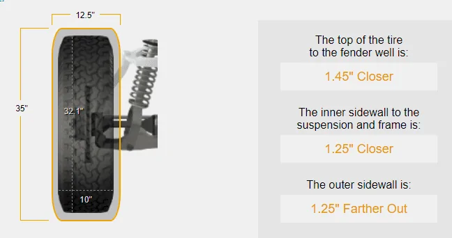

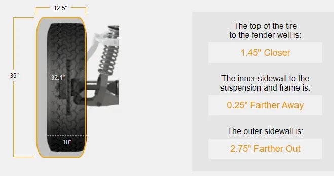

So, here's why it matters with lift. Here's what putting a 35x12.50 on your stock wheels looks like:

Now with 4.5" Backspacing, which is +6mm offset on 7.5" wheels (this can be done with new wheels or spacers).

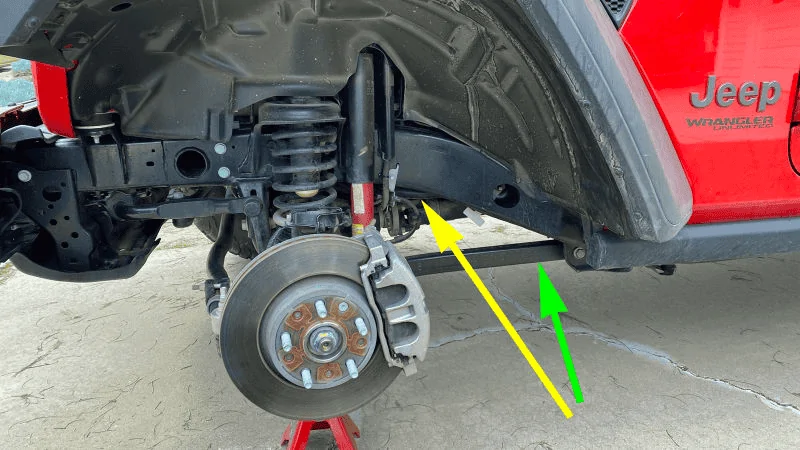

The pain point is mainly the front Lower Control Arms. You can visualize this by going out to the Jeep, turning all the way left, and looking at the clearance from your tire to the control arm.
You'll see the factory LCA is bent inward to allow more clearance from the tire. Some manufacturers have straight arms, so without the extra spacing of the tire outward, you'll hit the tire on the LCA. The green arrow in this picture points at the LCA:

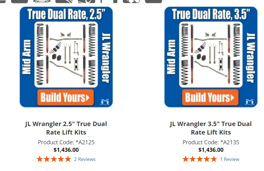

Hate to be a pain, but still learning here. Metalcloak's web site is confusing. When I asked them they replied price will vary depending on how you configure the lift. Well know crap.
But my question was the 2.5 inch true duel lift is $937. Then of course you can add shocks, use your own, use none, etc. But, when you click on 2 door or 4 door with what engine you have, no matter what you pick the price goes up $499? WHAT, OK, But it is not telling what I am getting for the price jump of $499, I am just picking 2 door or 4 door and engine. Am I missing something?
Can't I just order the stock shock kit for $937?
This kit. https://metalcloak.com/jl-wrangler-2-5-true-dual-rate-suspension-system-lift-kit.html
Thanks

It's the spring selection. At least on my laptop, the $1436 shows on the initial selection screen. Then it drops inside the options until you pick the springs by 2/4 door/engine.

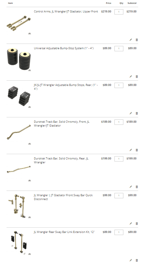

You can't get the kit without springs, so there is no $937 kit.
You can buy the parts separately for $973, though. Would be $923, but you'd need the disconnects instead of solid front sways, that's an extra $50.
