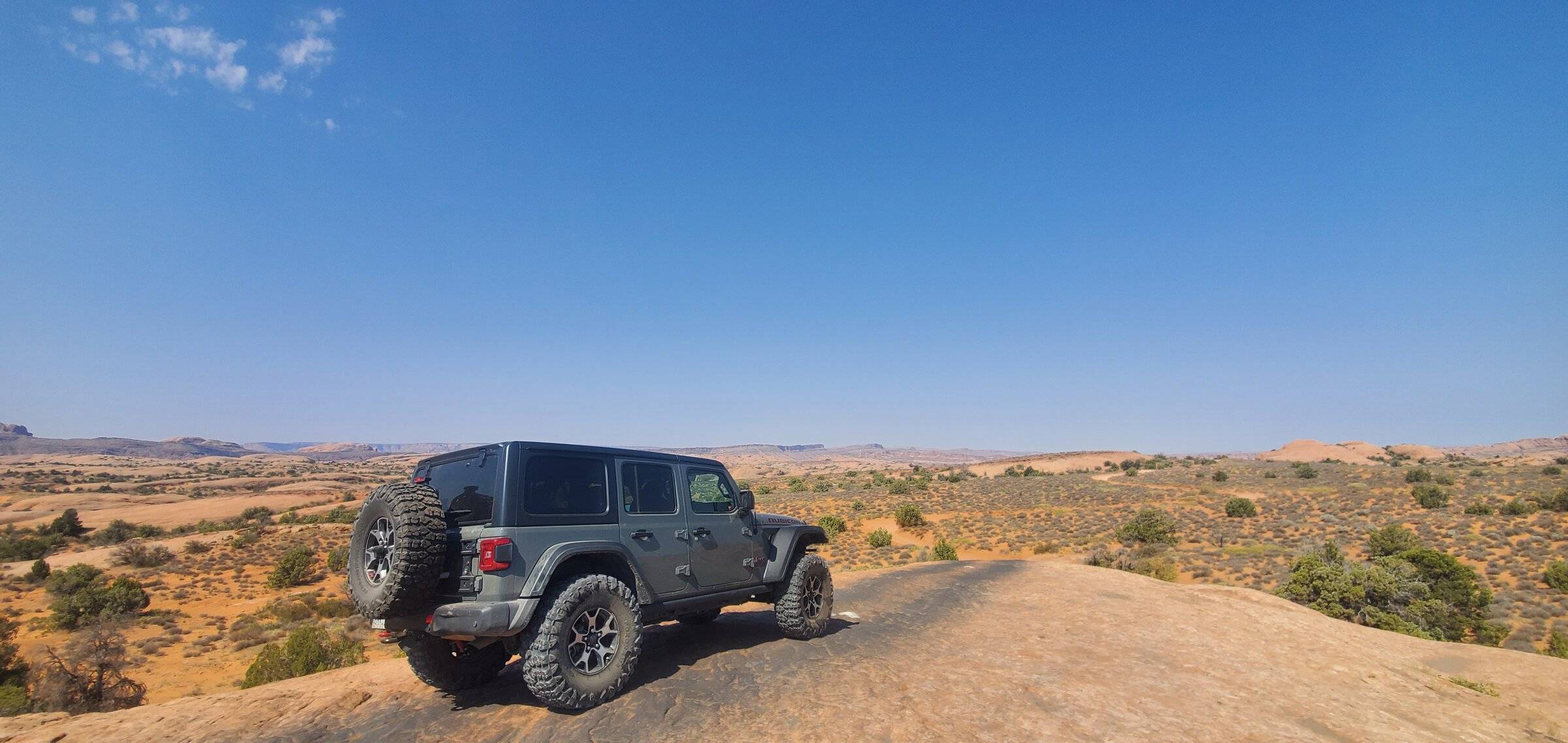

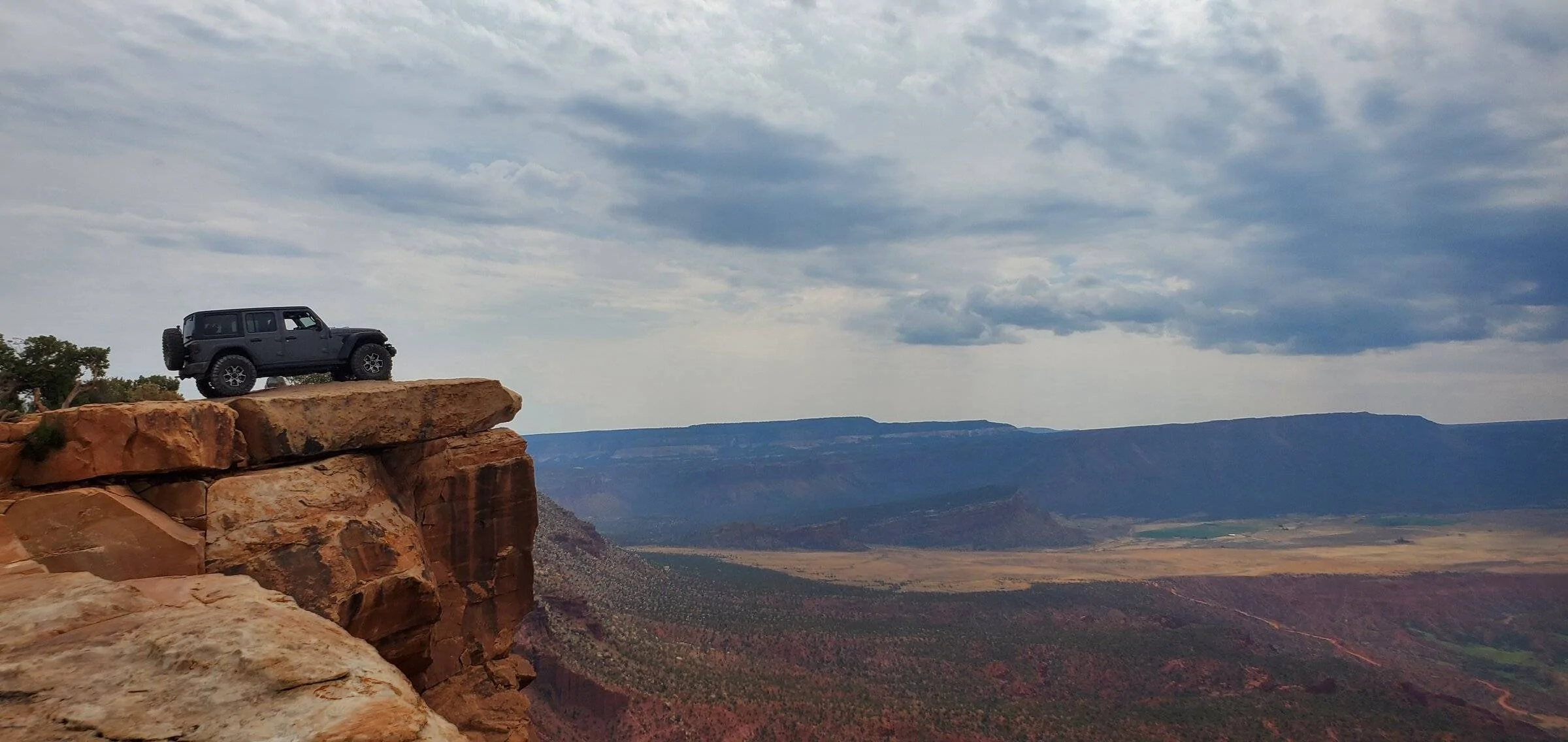

Don't be afraid of spacers and shock extensions. We wheeled all over moab on the no name extreme terrain budget spacer kit and 37's. Comes with bump stops, sway bar links, spacers, and shock extensions for ~$250. Ran Fins & things, hells revenge (including hells gate), top of the world, poison spider, golden spike, and gold bar rim without issues. We've done a bunch of upgrading since, but we literally put the spacer kit and tires on 2 days before our 1st moab trip, jumped in the Jeep, drove 1,100+ miles out there with the cruise control set at 80mph+, wheeled for 4 days, and drove home. No wandering, no death wobble, no coils falling out. We have added a front track bar and bracket, front lca's, coils, fox shocks, rear track bar bracket, drag link, HD Ball Joints, etc in the 3 years since, but the thing was still a beast on mostly stock parts.
