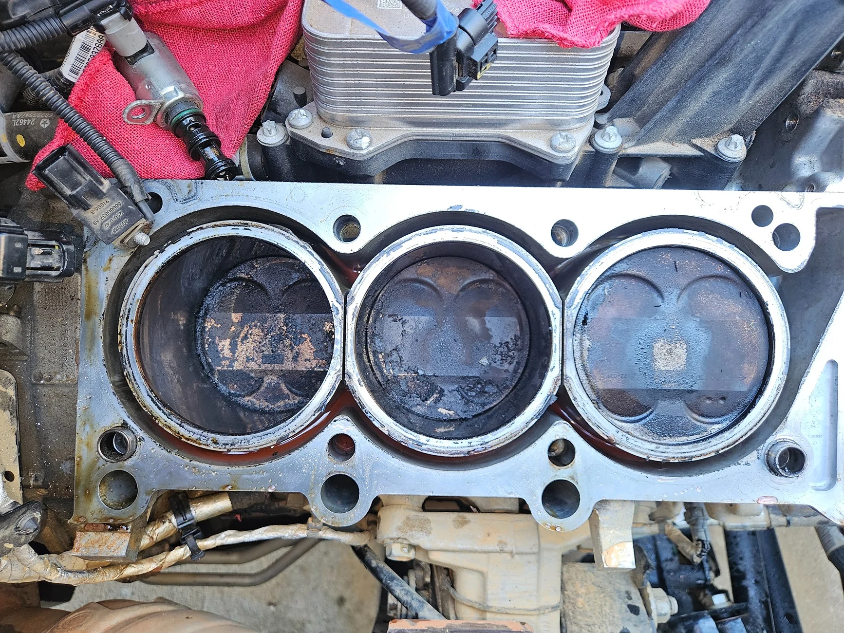

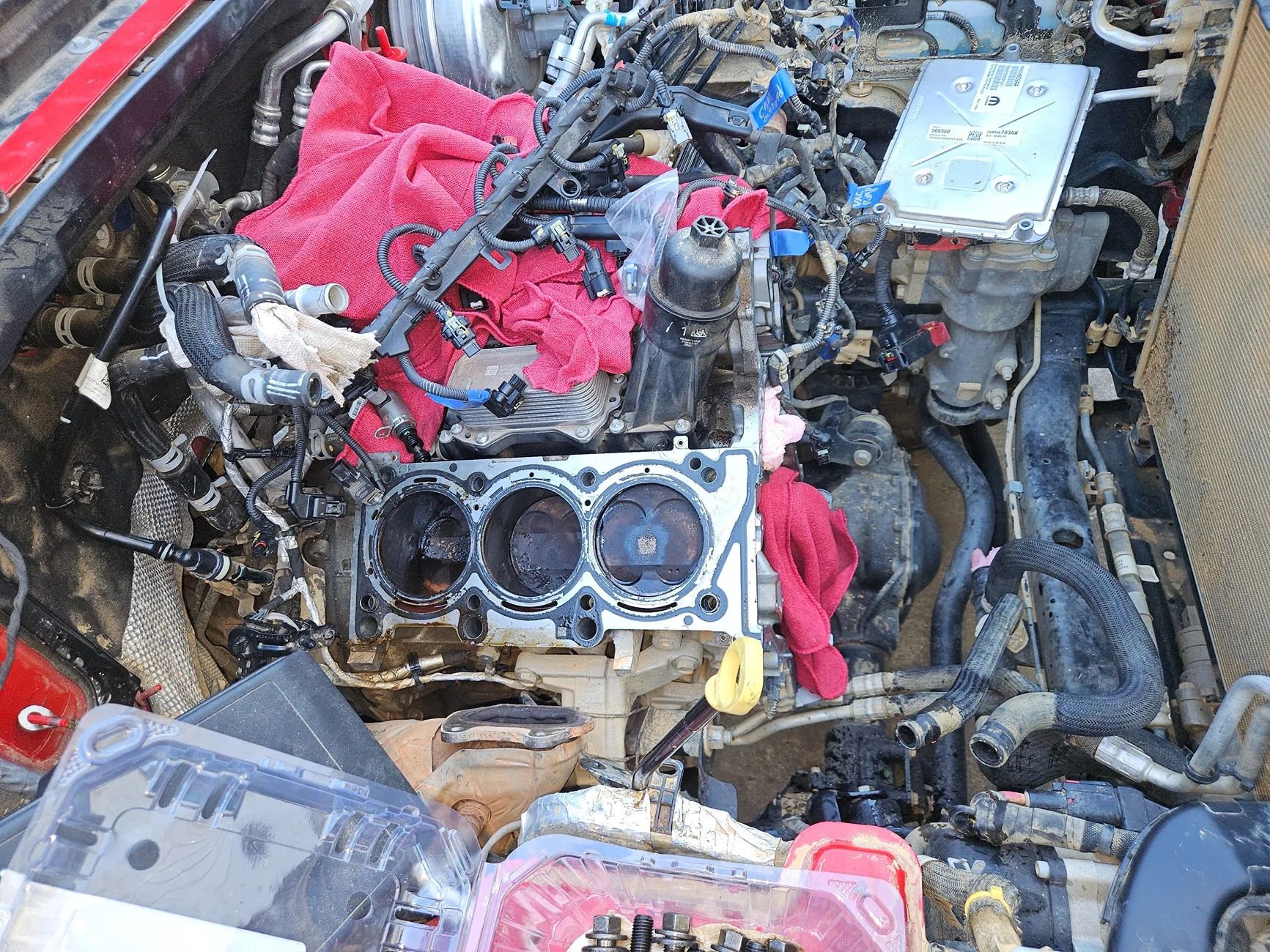

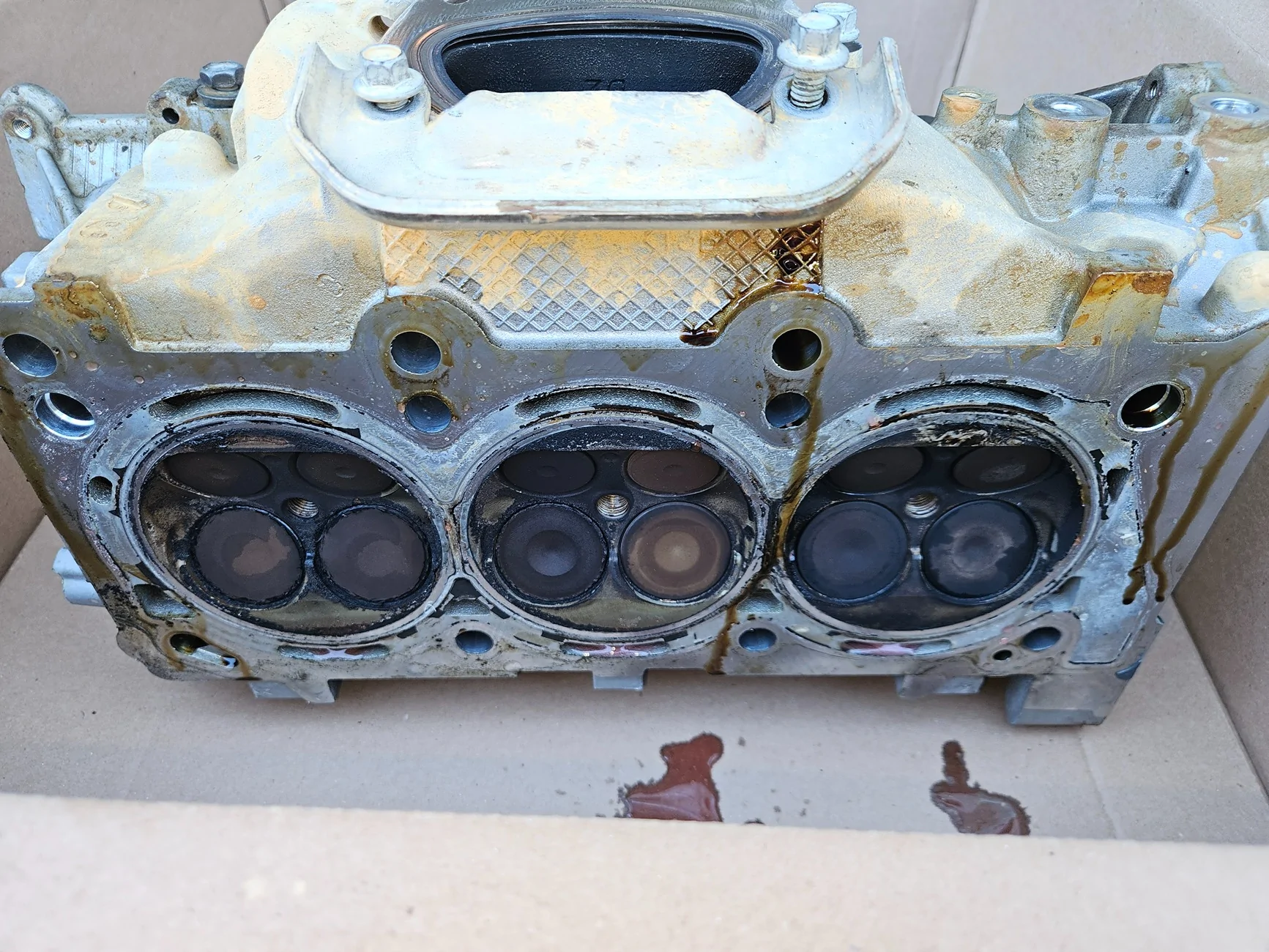

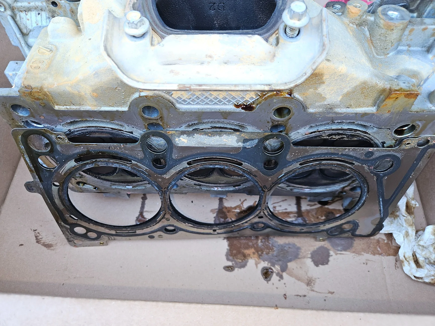

Passenger side....[check engine light, code= misfire cylinder 1]
Jeep Wrangler JL head gasket swap after P0301 code 20251017_153144
Jeep Wrangler JL head gasket swap after P0301 code 20251017_153358
Jeep Wrangler JL head gasket swap after P0301 code 20251017_154026
Jeep Wrangler JL head gasket swap after P0301 code 20251017_154038

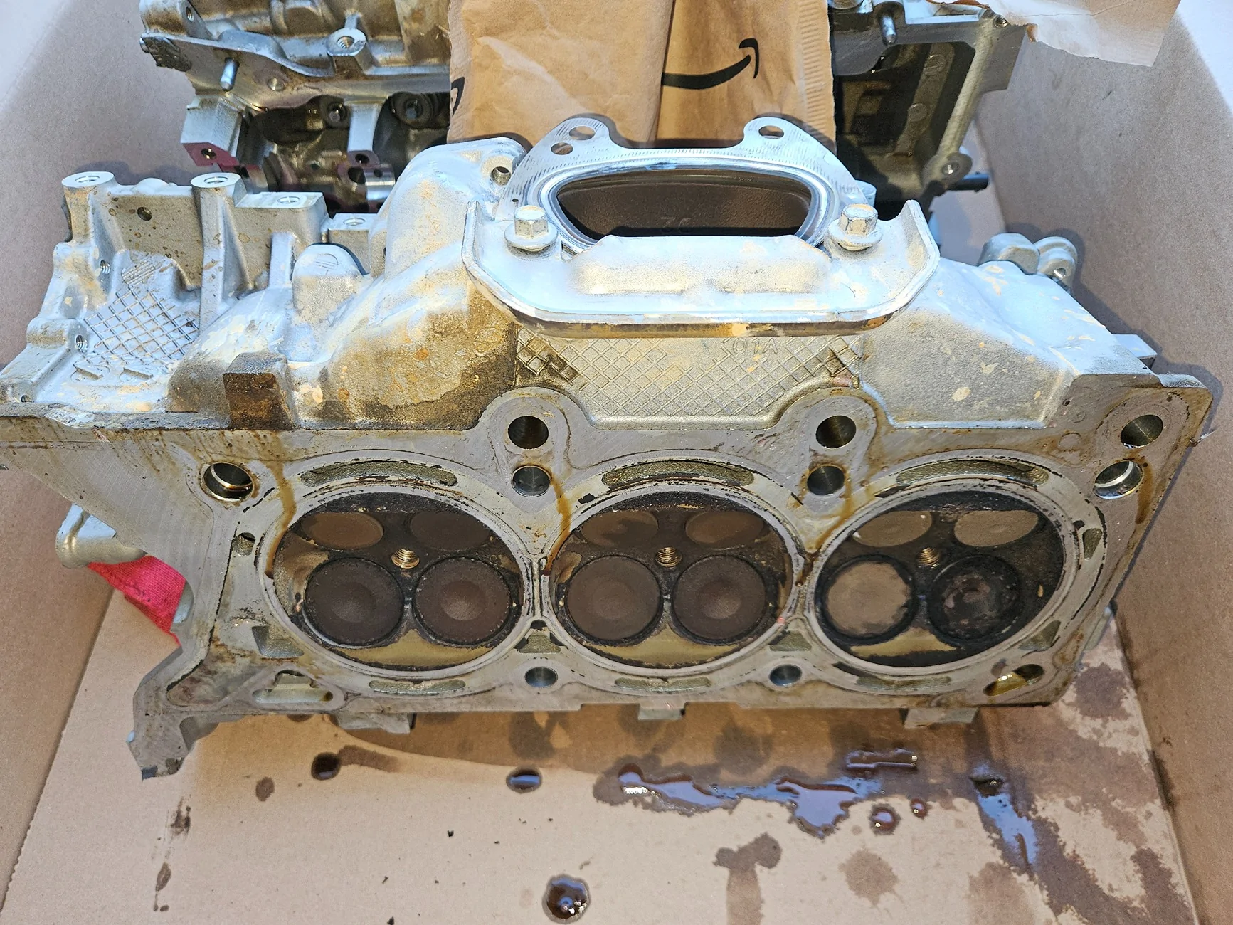

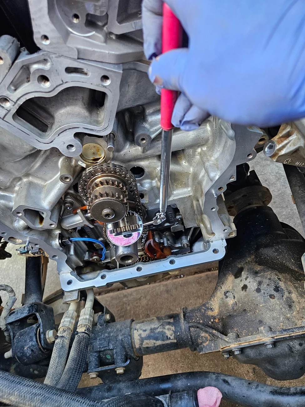

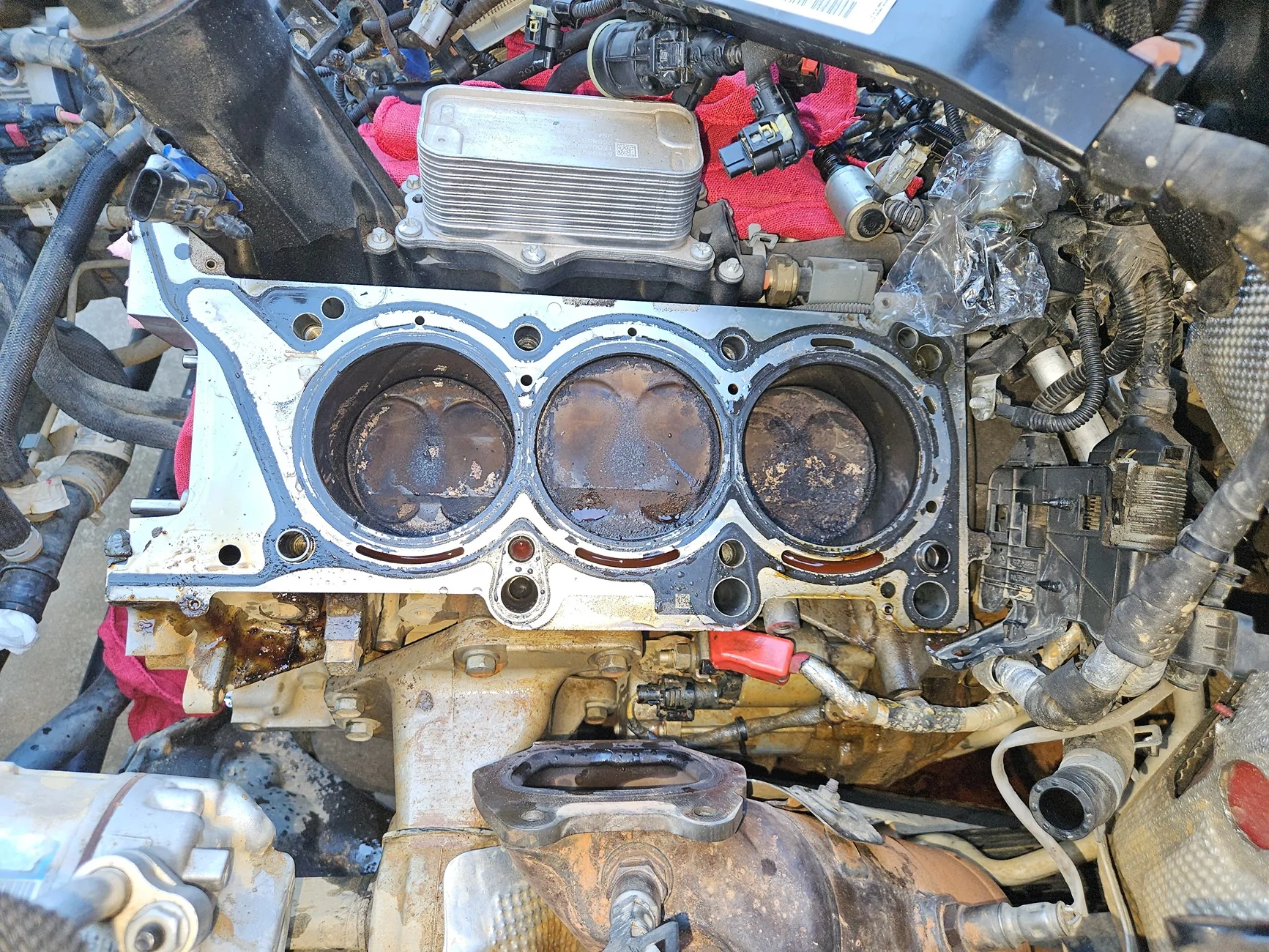

Driver side
Jeep Wrangler JL head gasket swap after P0301 code 20251017_164623
Jeep Wrangler JL head gasket swap after P0301 code 20251017_164803
I think i will bring the heads somewhere to get checked and cleaned.
I'm no expert, but the carbon build up seems excessive to me. Can I just clean the cylinders with some BPC (brake parts cleaner) and.WD40?

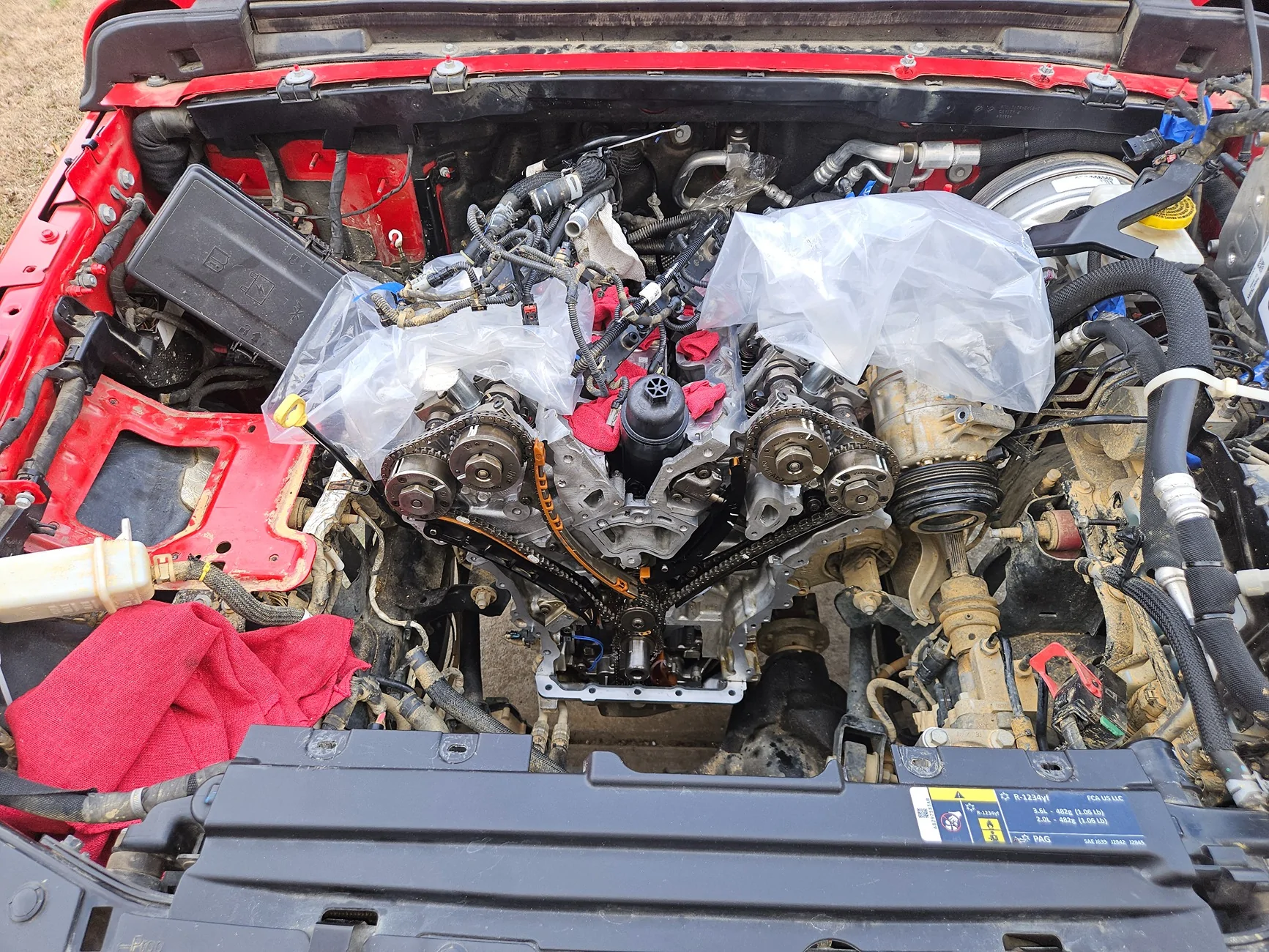

I suppose I should update this thread. Been pretty slack, but still making progress.
I brought both heads to my local trusted machine shop. He talked me into a complete valve job, etc. Little more than I wanted to spend, but good piece of mind. Picked them up first week of November.
I probably overthought the parts ordering stage. Had everything delivered from allmoparparts mid November. Thanksgiving crept.up and brought bitter cold weather in early December. I'm working outside, so when it's cold...I am not working.
Christmas miracle brought 70degree weather so I dropped the heads on mopar headgaskets, reused.the old.bolts, torque in circular.sequence 22ftlbs, 33ftlbs, again 33ftlbs, 40degrees then 90degrees.
Ground connections on the back of the heads done...Chrysler you're off. My Christmas card list.
Exhaust cats bolted.back to heads....still no Christmas card for you Chrysler.
Cams and timing chains installed. I rolled the engine over a few times and am pretty confident the timing is right.
Got the timing cover cleaned up, ready for new seals before installing.

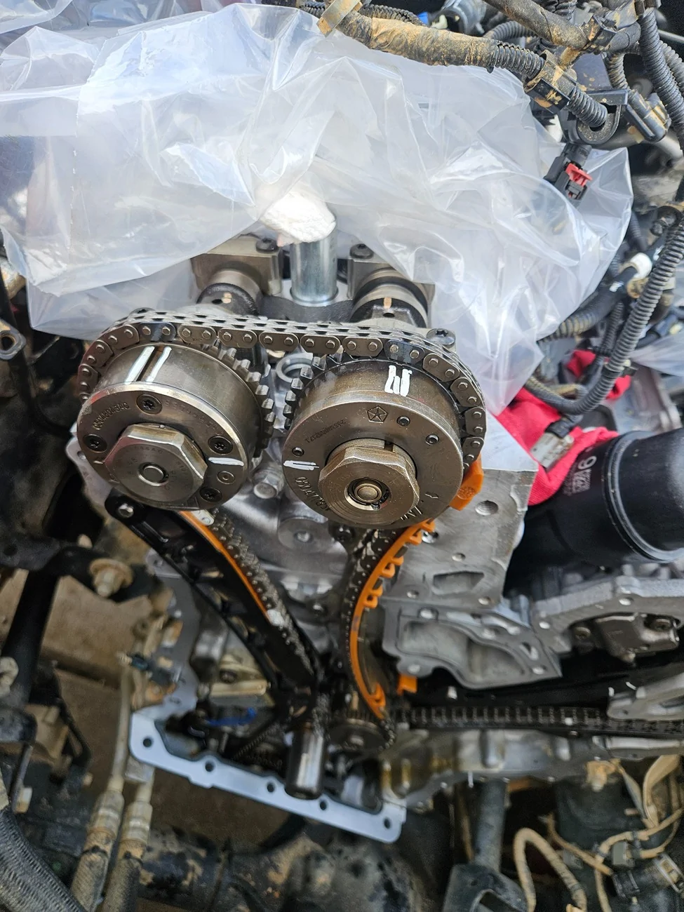

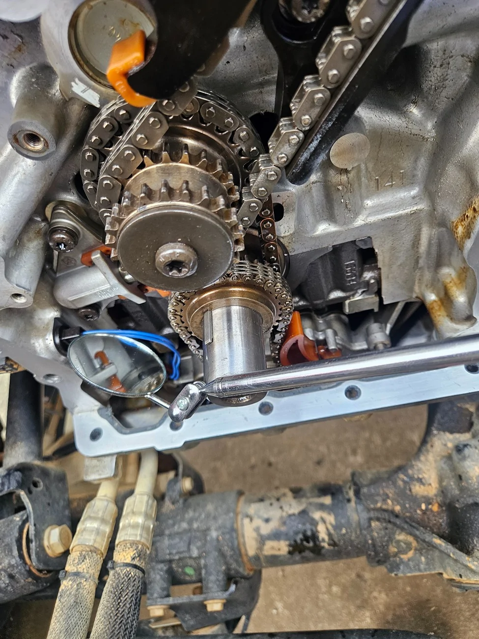

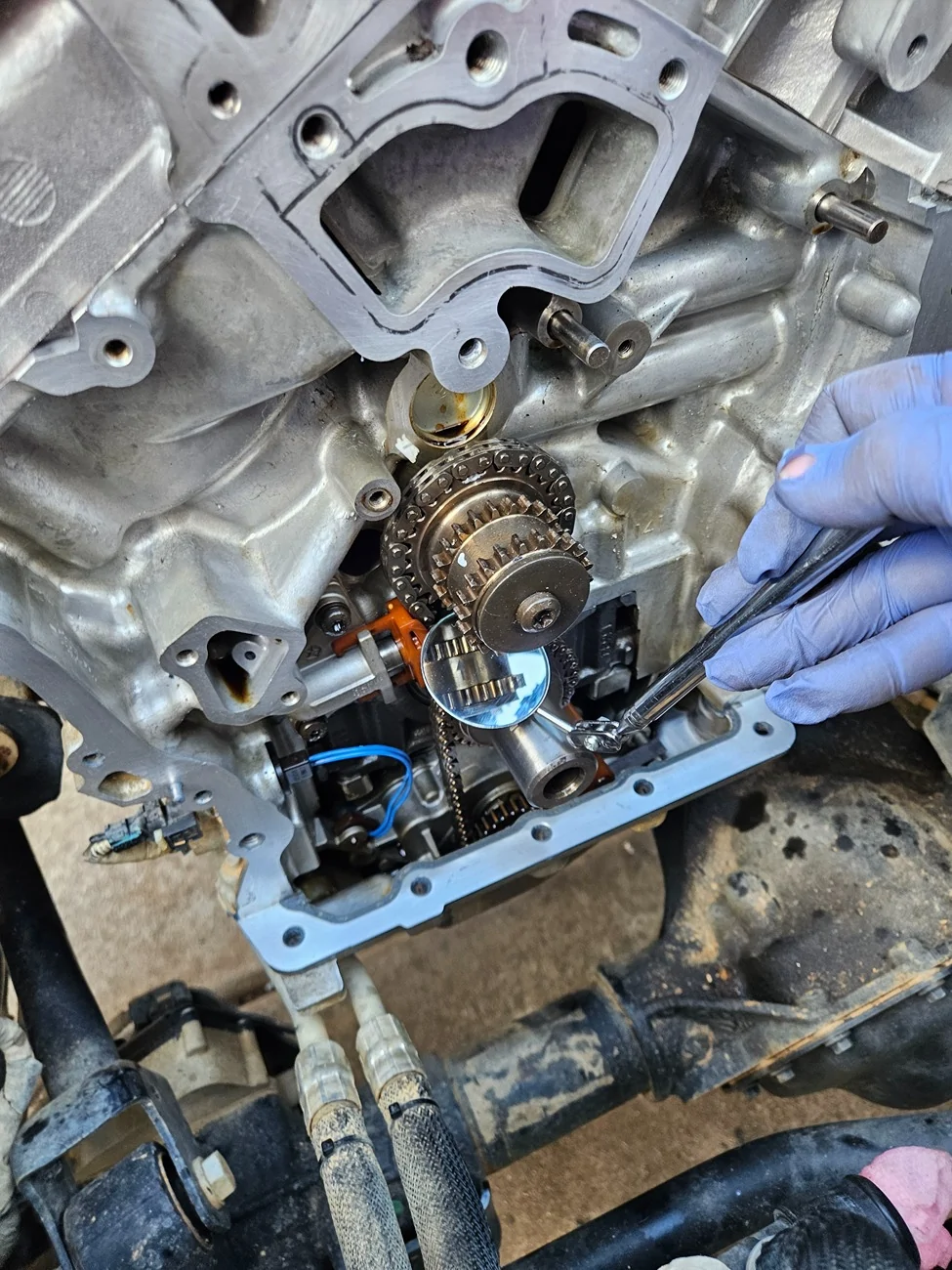

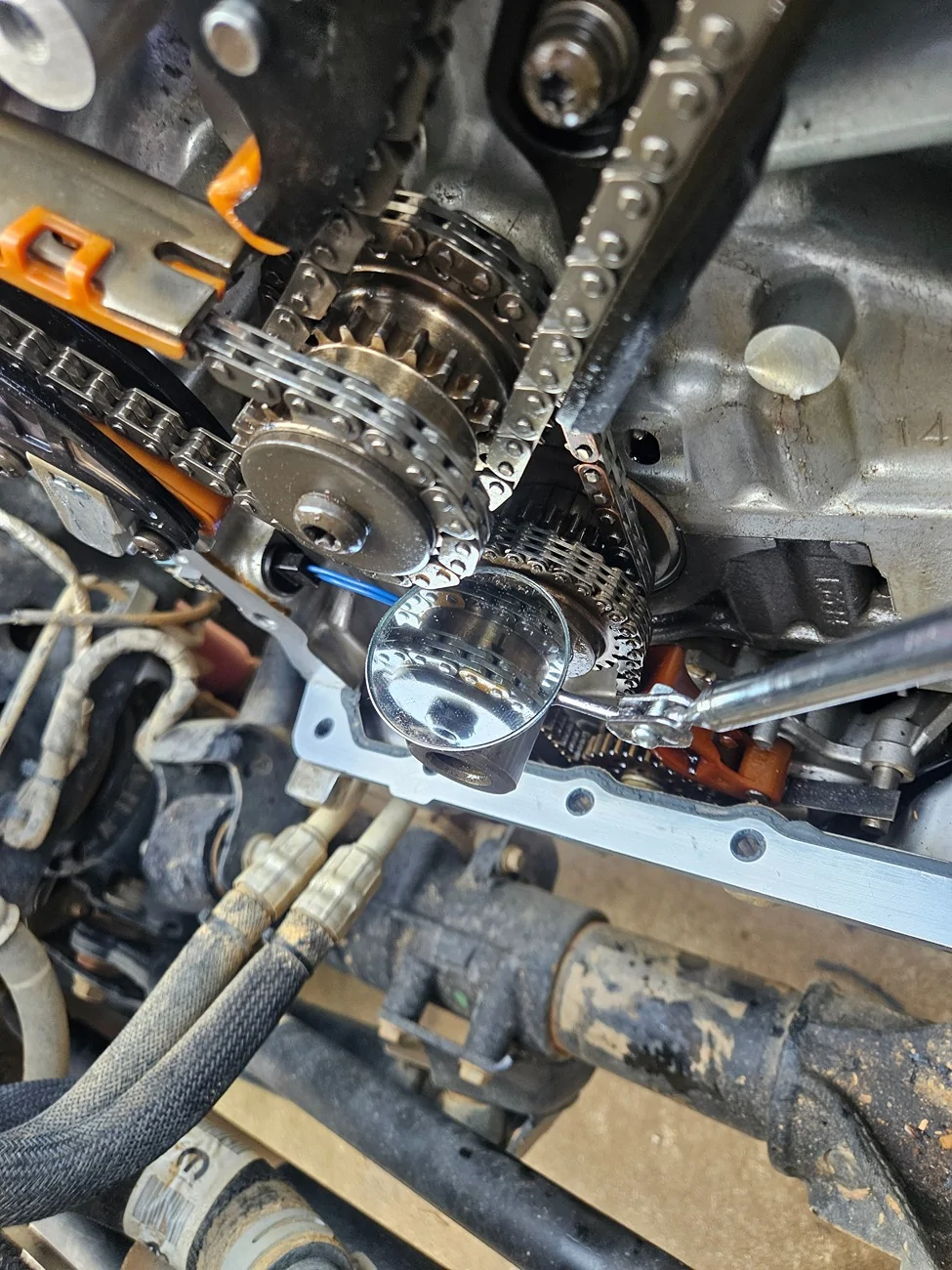

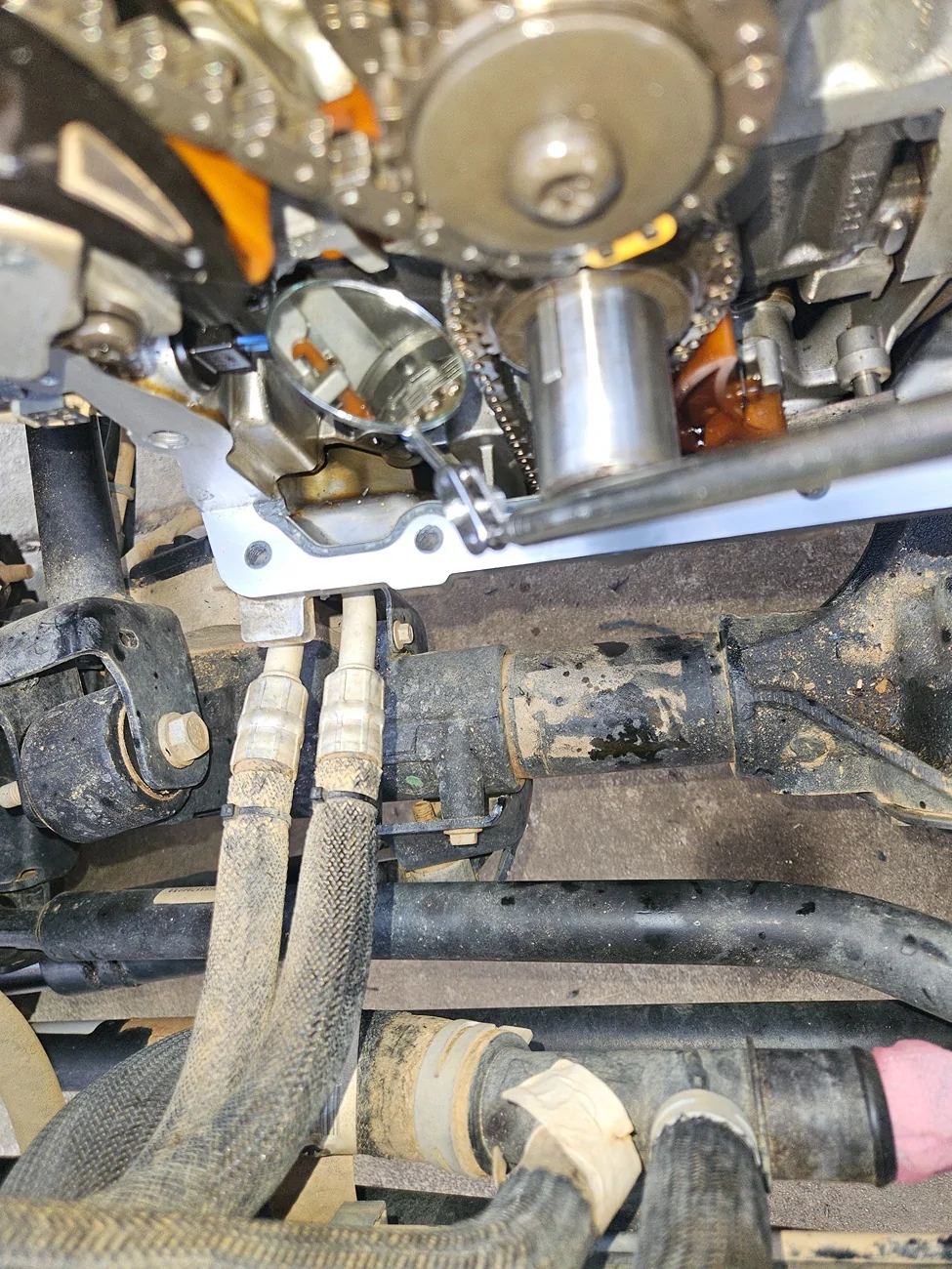

Let me post my timing pics.
Drivers side chain....
For removal, I had already removed the outboard cam phaser. To get it back together, I had to also remove the inboard phaser. If I did it again (hopefully never have to) I'd try removing only the inboard phaser. Big 36mm bolt head oil valve things torque to 105ftlbs

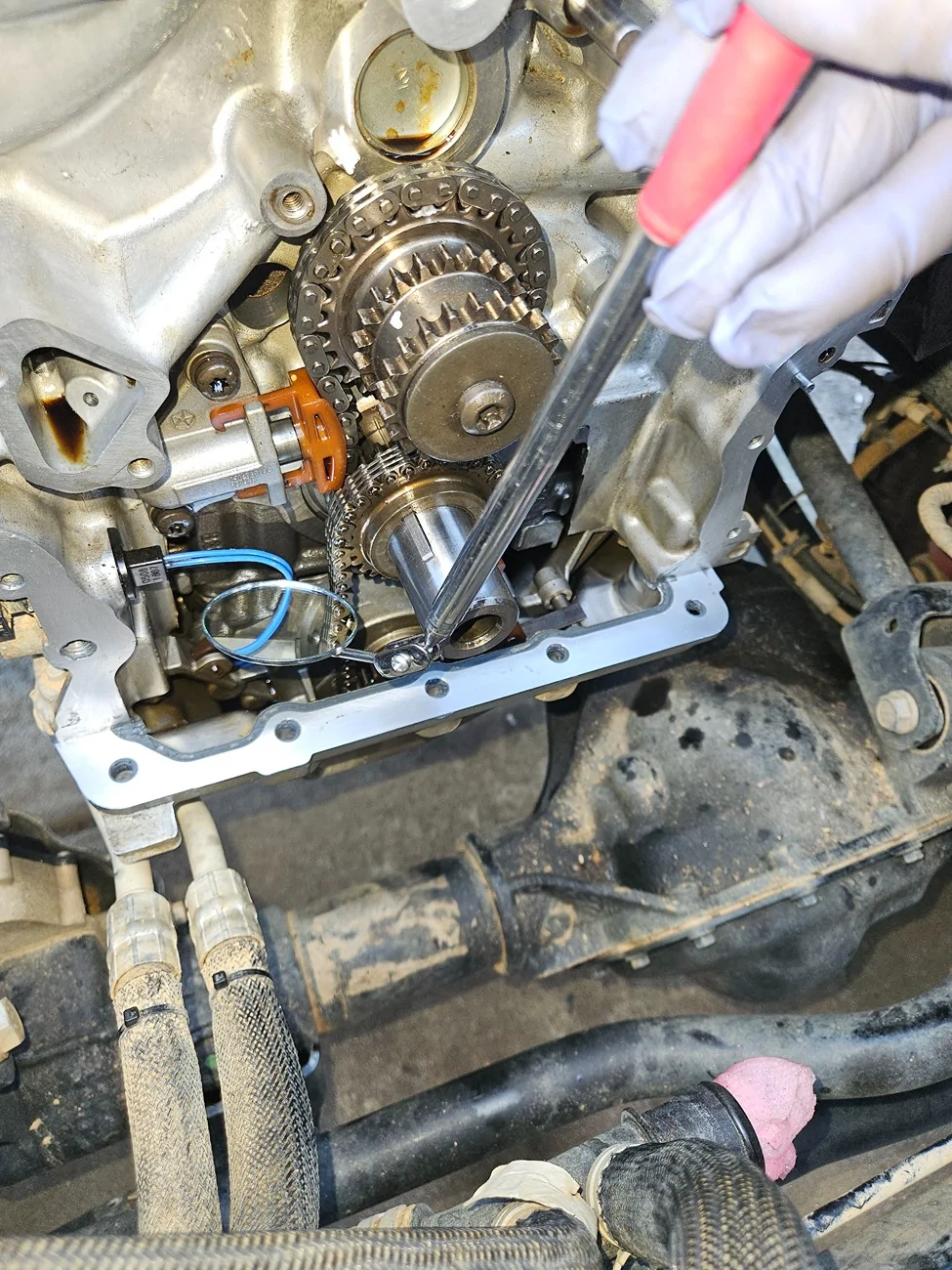

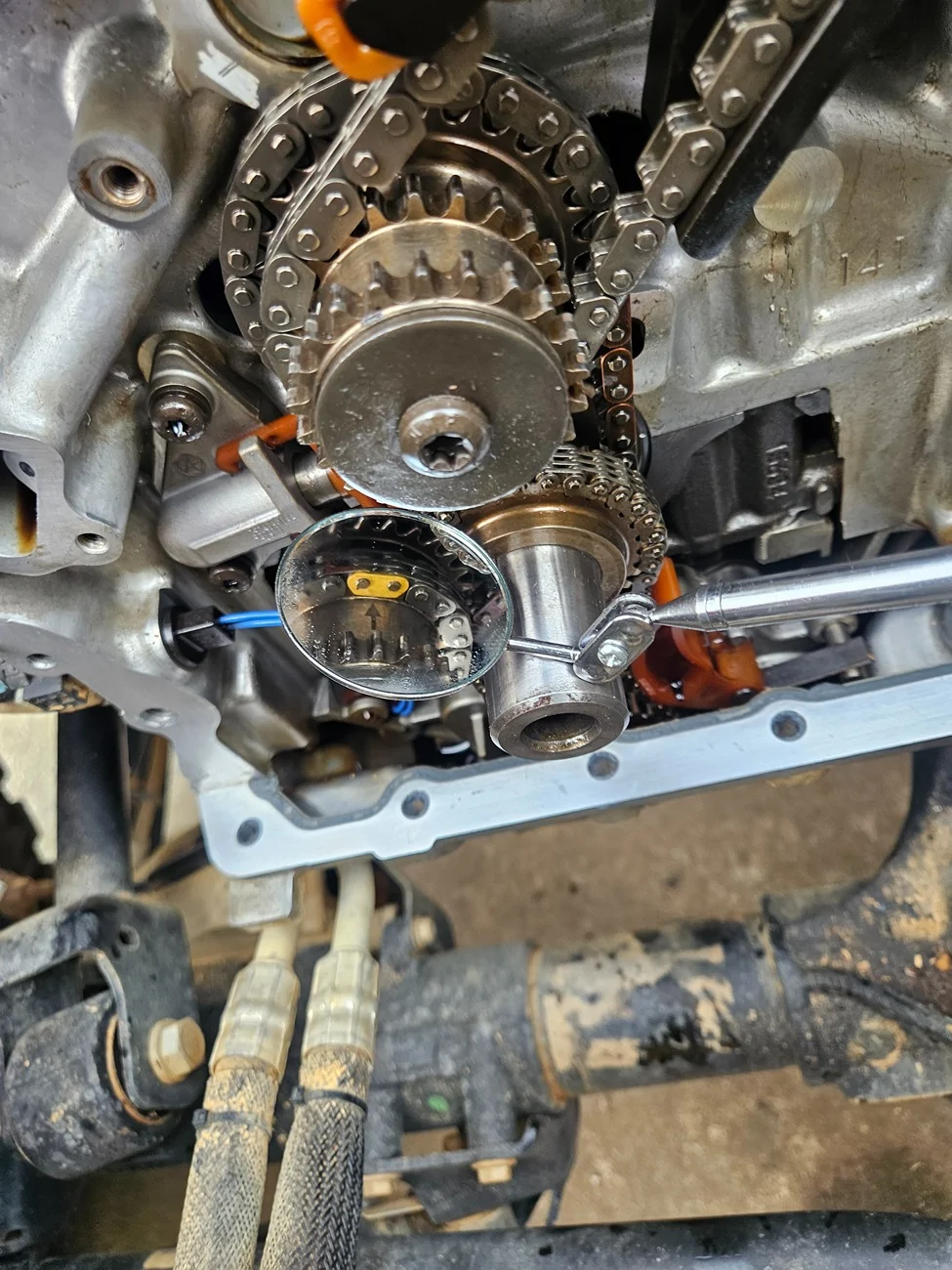

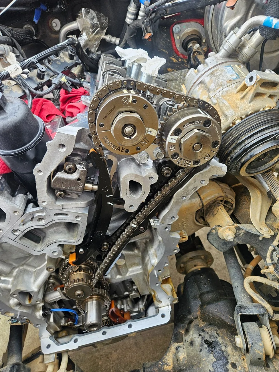

Passenger side, much easier. No cam phasers removed during teardown or assembly...
Jeep Wrangler JL head gasket swap after P0301 code 1000169916
Jeep Wrangler JL head gasket swap after P0301 code 1000169917
Jeep Wrangler JL head gasket swap after P0301 code 1000169920
Edit...I forgot the beginning pics showing the idler gear dimple strait up, 12:00, the 2 arrows below for orange link on timing chains, and the crank at 9:00 TDC...

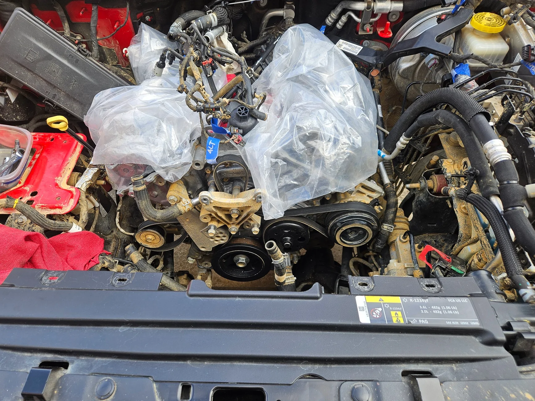

I got all the belt drive components except the alternator back on.
AC compressor was fun. Nothing is ever as easy as it seems it should be. There's only 3 fasteners holding this on to the side of the block. May e this is docume ted somewhere, but here's what I figured out.
The bottom rear bolt is first. Insert the bolt into the comp before its in place. Otherwise the motor mount will block to slide the bolt in. A flat 13mm gearwrench works well here. Then the other long bolt can go on top to hold things in place. The third attachment, bottom front, is an E8 stud and then a 13mm hex nut, deepwell socket.
There is a hard coolant line coming from the nether regions of the bell housing, bolted to the bottom drivers side oil pan, routed up near AC compressor, maybe to the tsat. To access the exhaust catnconnection, i had unblocked it from the oil pan and tucked the loose end under the steering shaft. After bolting up the AC comp, I realized this hard pipe needed to be above the compressor. It was tight, but i was able to bend shimmy and finagle it back into position, then tighten it up to the oil pan.
Who knows maybe this was the best way. It was tricky getting the AC compressor in place without the hard pipe. If I had to do it again though, I'd try to have the pipe above the AC comp.
Now I need to buckle down for valve covers and intakes, plus all the fun wiring and coolant hoses. Then EGR cooler and battery tray, fan (clean radiator fins first), fresh oil and coolant, etc

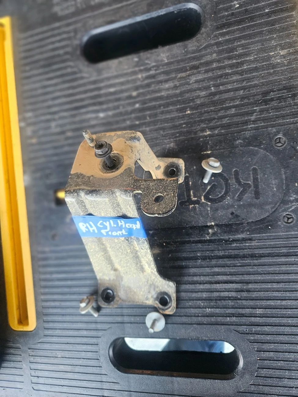

Any idea WTH this bracket is? I'm sure I'll figure it out as i get deeper into the reassembly as this puzzle comes together, but right now i cant seem to place it. I wrote RH, so guessing that will be pass. side, but who knows lol
I have an eTorque. I just came from the garage and though I don’t have that bracket, I have one that is constructed similarly that mounts on top of the passenger valve cover that keeps the coolant lines from moving around and another even smaller bracket that holds the power cable that runs to the MGU. Same sheet metal with the reinforcing rigidity ribs pressed into it and small hardware.
